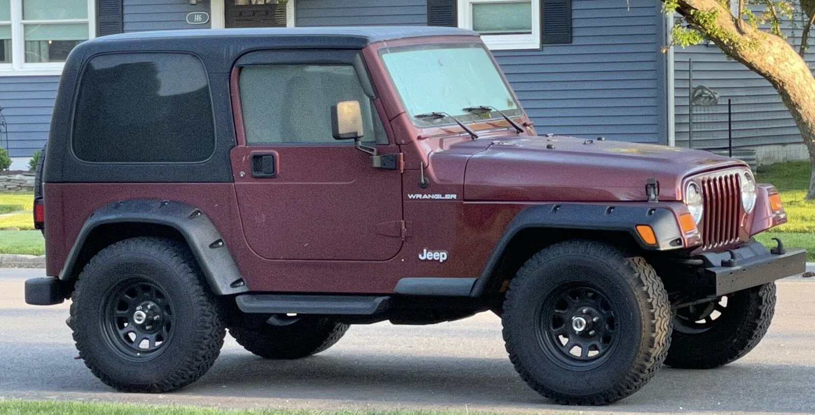

Newer member here. Don't post much but read a lot of posts here. I decided that I'd share what's going on with my Jeep. Here's a pic. I purchased my 01 TJ last year and used it as a 2nd vehicle during the summer. At the end of the summer it started smoking as I was driving it. Since I was in the middle of moving, I trailered it to my new home and there it sat for the next year until I finally had time to work on it. Pulled it into the garage finally to take a look at it and it seemed the smoke was coming from the manifold gasket leaking oil onto the exhaust. So I ordered a new gasket. Cleaned the manifold cover up a bit. Stripped off all the paint. And then painted it with some high heat paint. I put the manifold and gasket back together, and while inspecting the Jeep a little closer, I noticed the front suspension looked like garbage so decided to upgrade some components. So I ordered some new shocks, ball joints, tie rods, drag link, track bar, upper and lower control arms and sway bar end links and new bushings all the way around. Since the oil pan was rusted so bad, I decided to buy a new oil pan and gasket. I had to take the exhaust down to get the oil pan out, so I decided to replace the O2 sensors. To get the exhaust down, I had to take the skid plate down, so I decided to replace the tranny oil and filter. Replaced the rear main seal since I was in there and wouldn't you know it, as I was putting the oil pan back in the tranny lines were so rusted that they started to leak right through them. So purchased and installed some new transmission lines. I deep in the weeds now, as the transmission lines were being replaced, I noticed a leak from the radiator. So there is now a new radiator sitting in the box ready to get installed. As I was waiting for parts, I cleaned up the engine compartment a bit. Anything rusting, I'm stripping it down and treating it with metal prep and painting it with some POR-15. I feel like I'm about 50% done with the front. I'll attach some pics so you can see the progress. It's not anything crazy and I am not a mechanic by any stretch of the imagination but I'm learning as I go and having fun doing it. Here's a pic of my project:

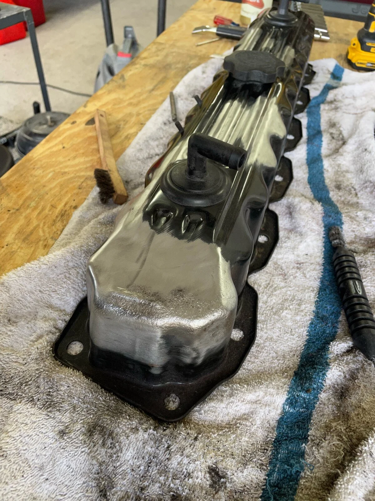

Stripped down the manifold cover. It's now repainted.

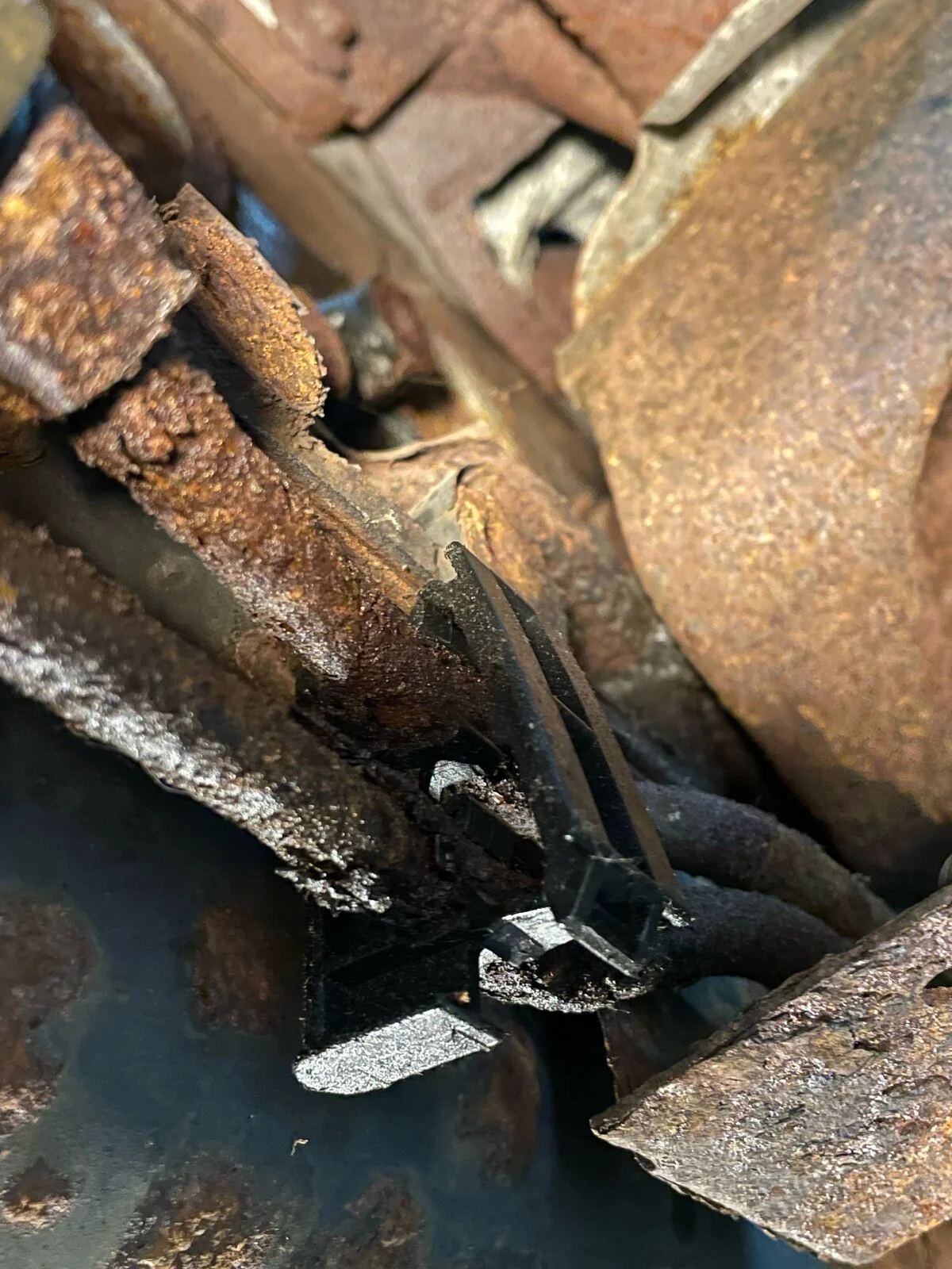

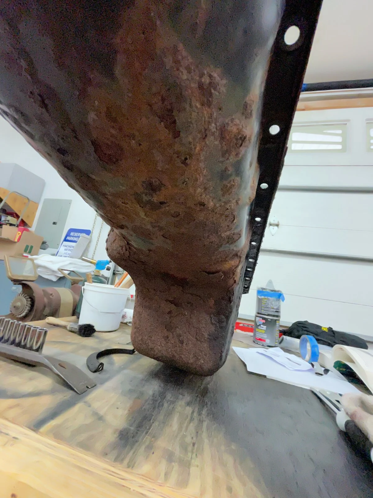

Pic of the oil pan. Nasty..
Rusted out tranny lines

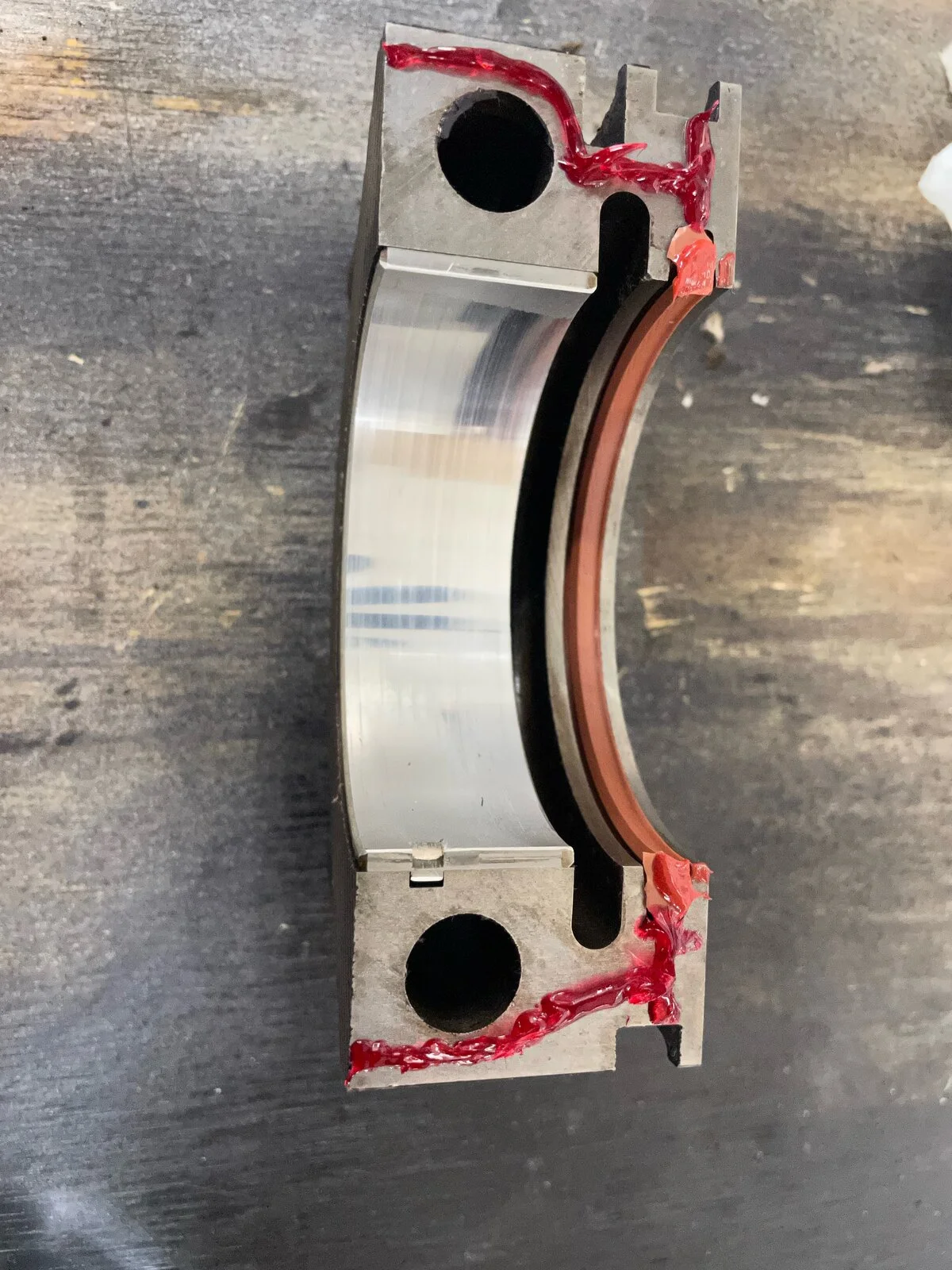

New rear main seal...

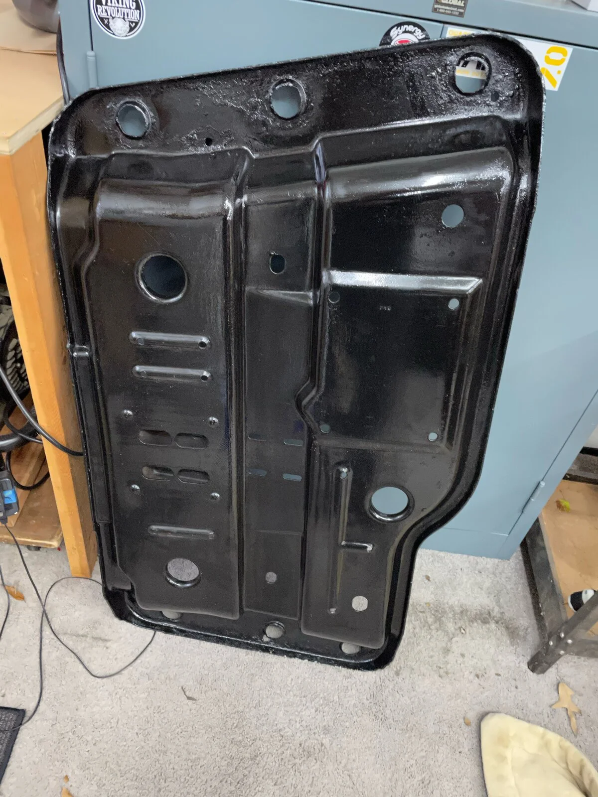

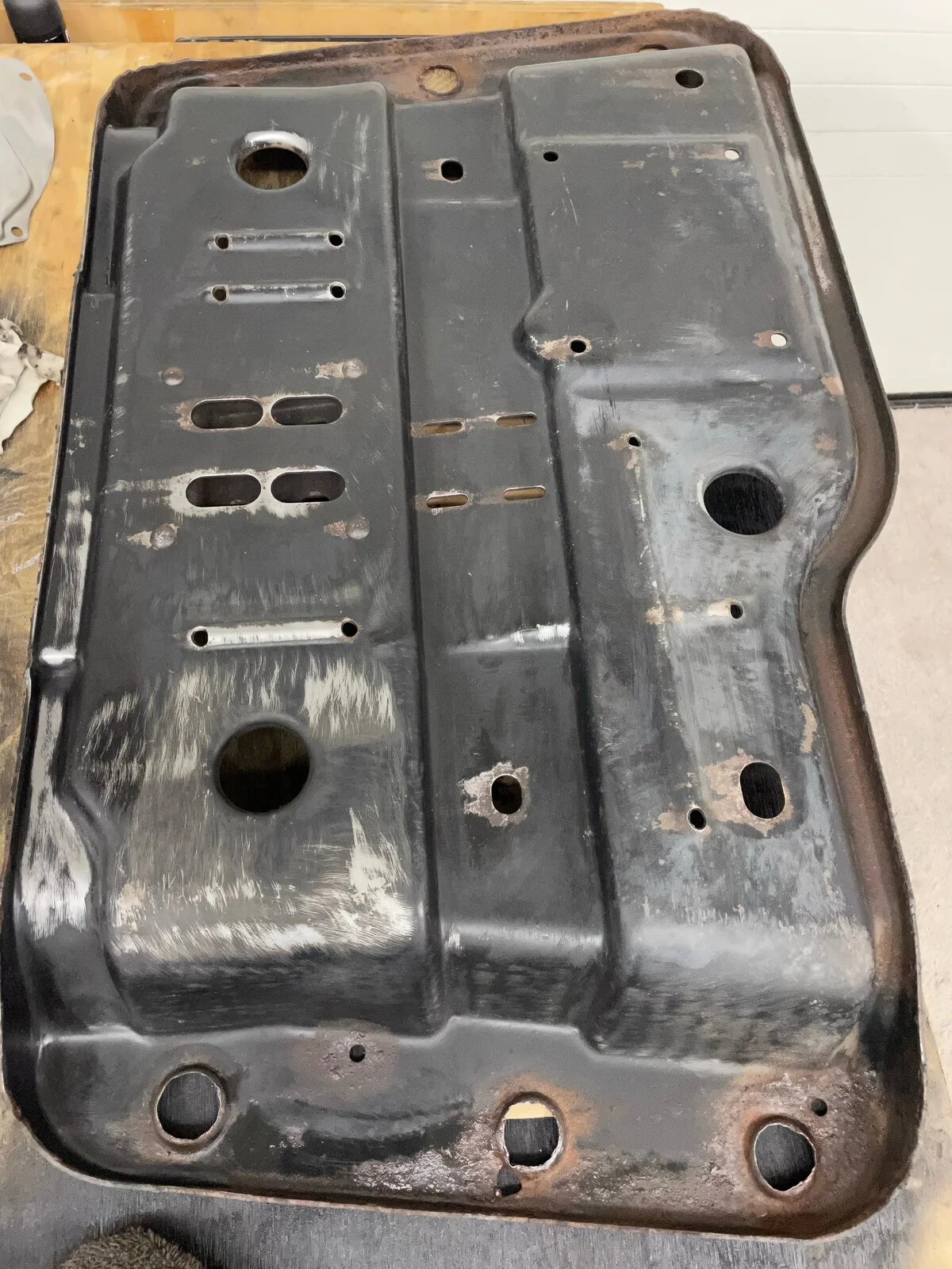

Cleaned the skid plate and repainted it.

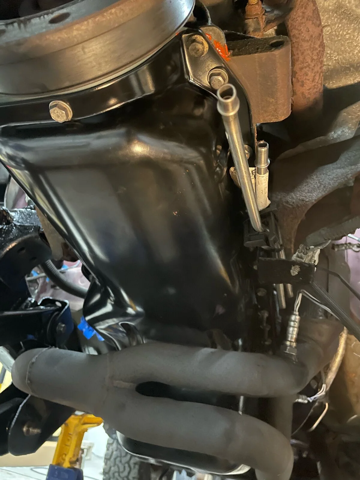

New oil pan installed, tranny lines and O2 sensors

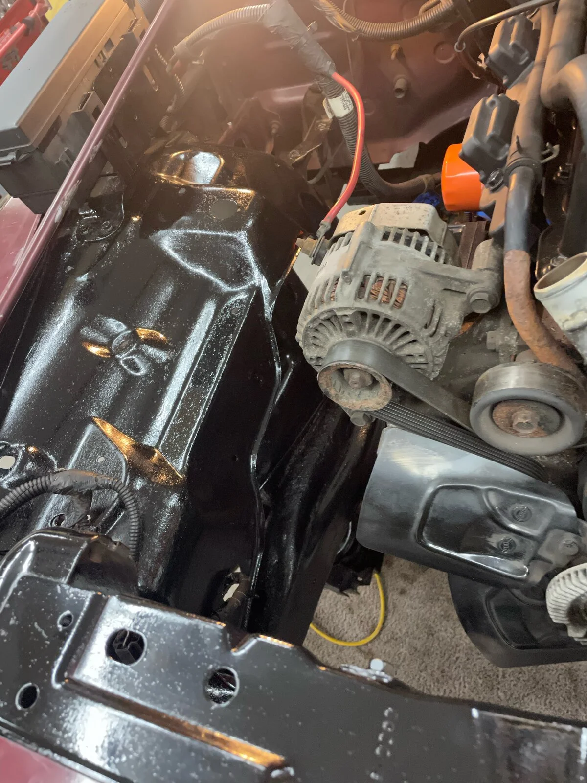

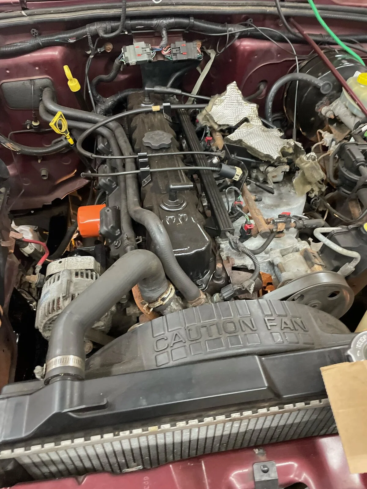

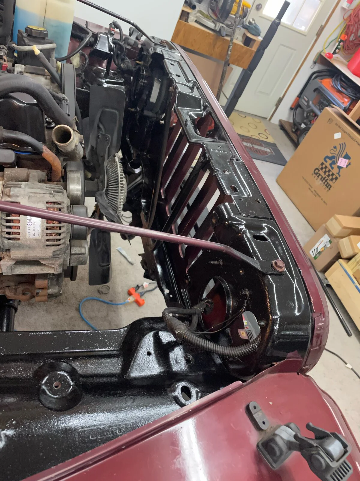

Took the air box out and painted the engine compartment a bit and the brackets. Radiator also is out.

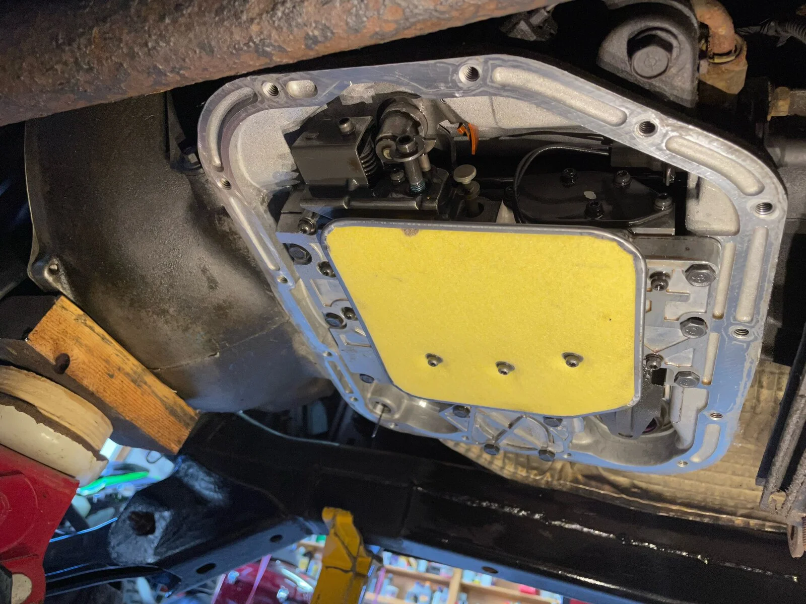

New Transmission filter

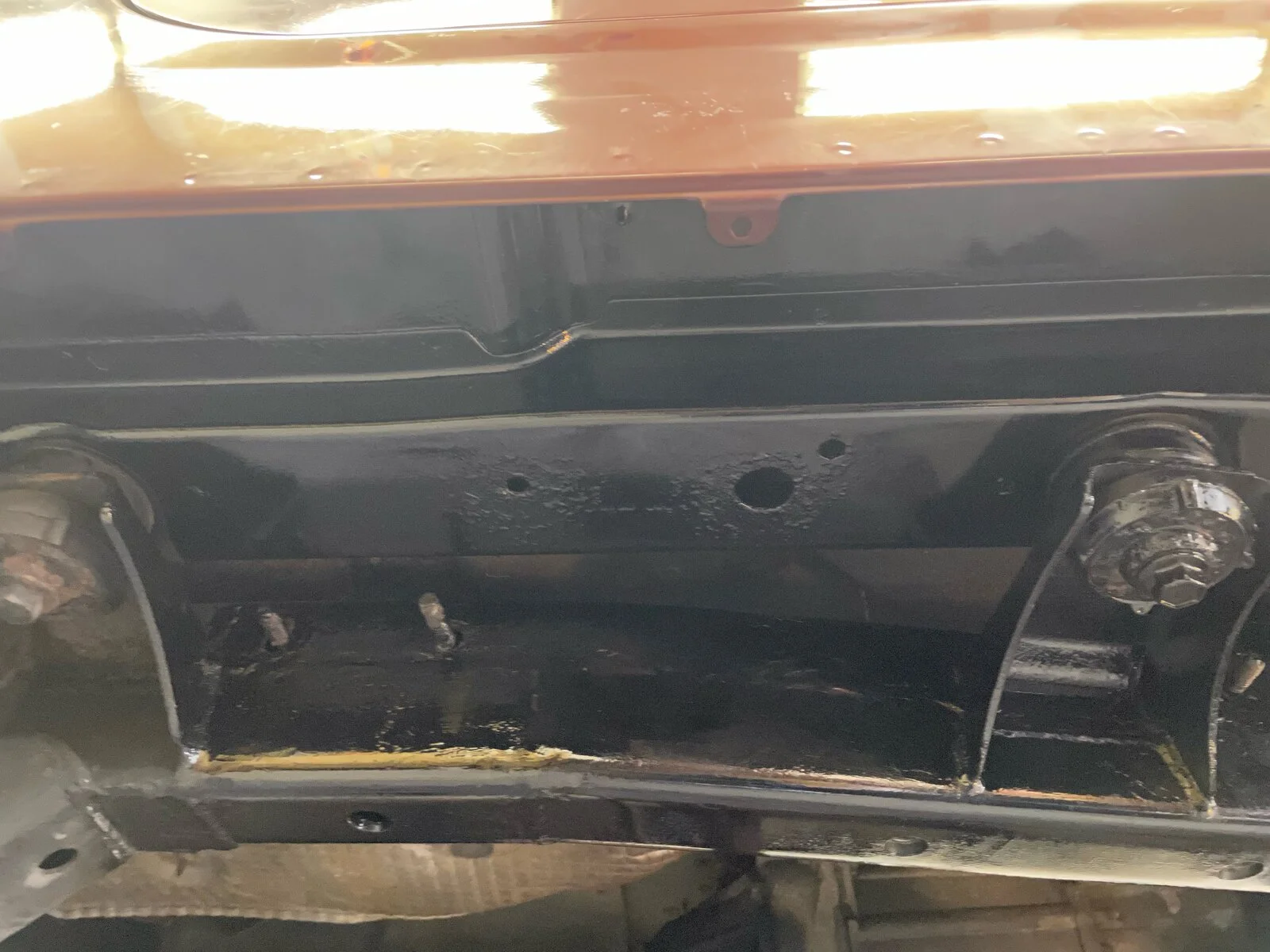

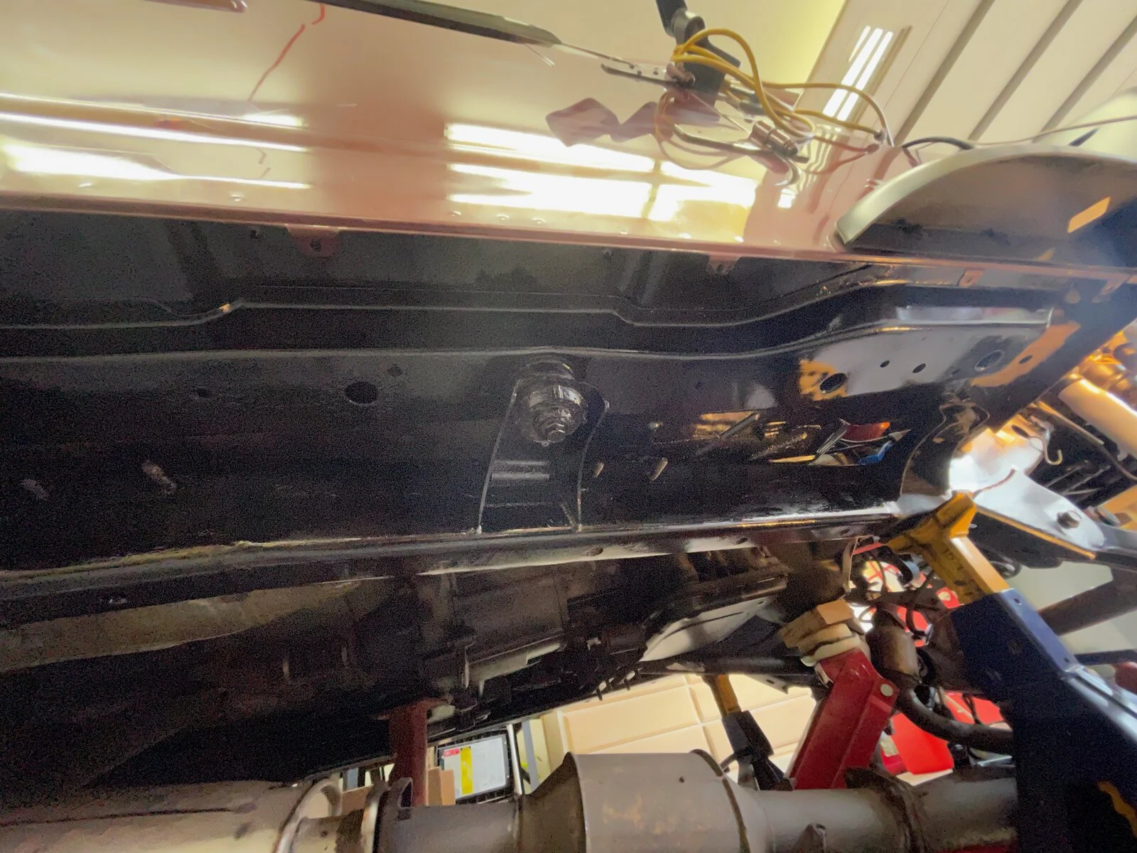

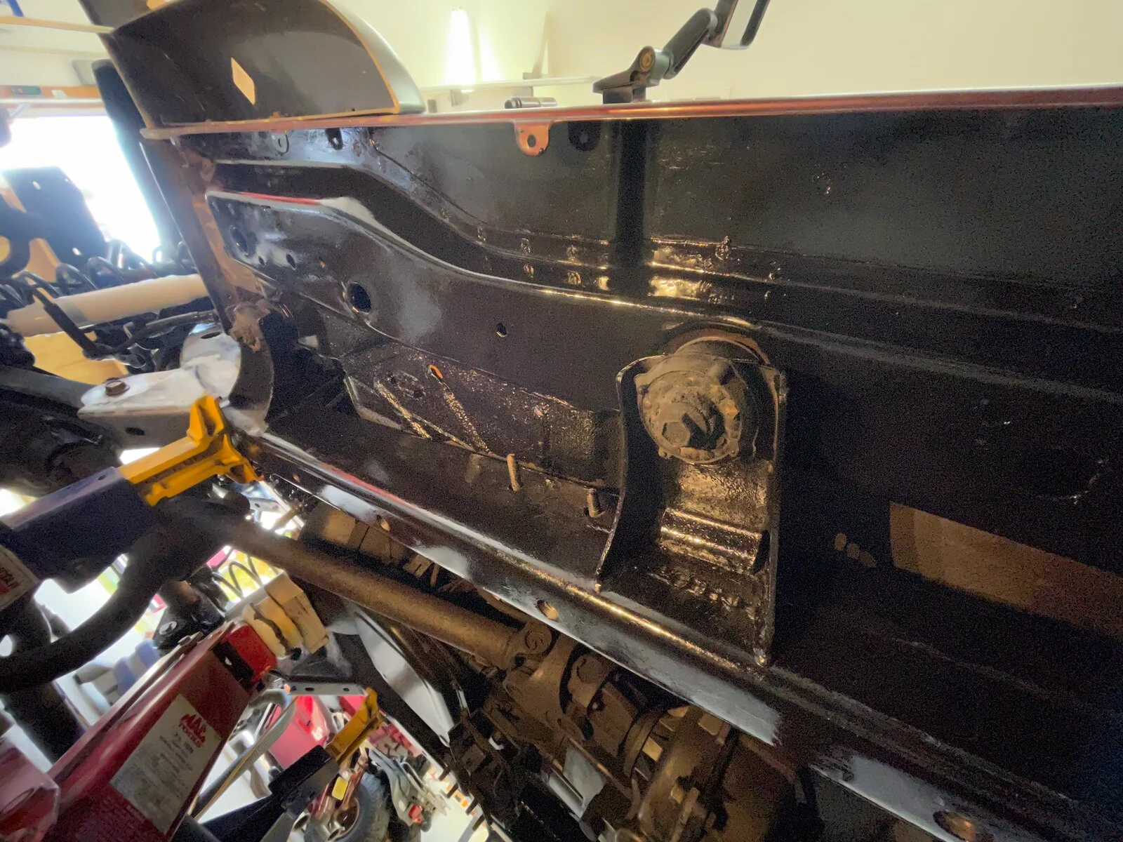

Painted the frame

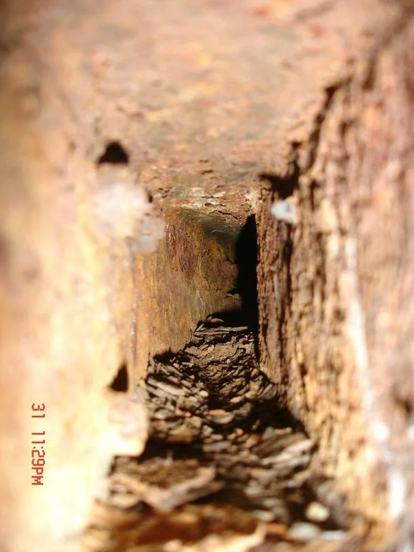

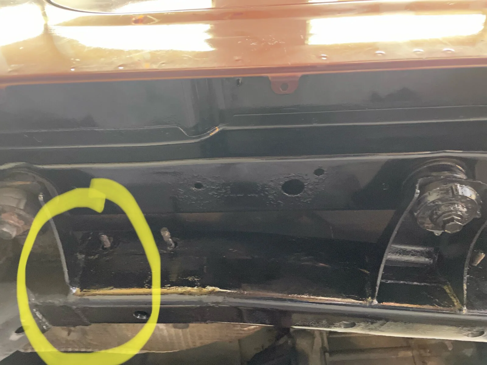

Welcome. Have you checked the inside of the frame for rust or rot? The frame has already had some patching/repair work. Especially with how rusted your oil pan and other parts were, I wouldn’t be surprised if there is more surprises lurking inside the frame

Painted the frame
I did take a scope to the inside of the frame and it did not look too bad. I did get some internal frame coating spray and I hope that keeps whatever may be in there at bay. I'm not looking for perfection but just a dependable ride. The guy I bought it from did tell me that some repair work was done but for the price I paid I was willing to deal with it.

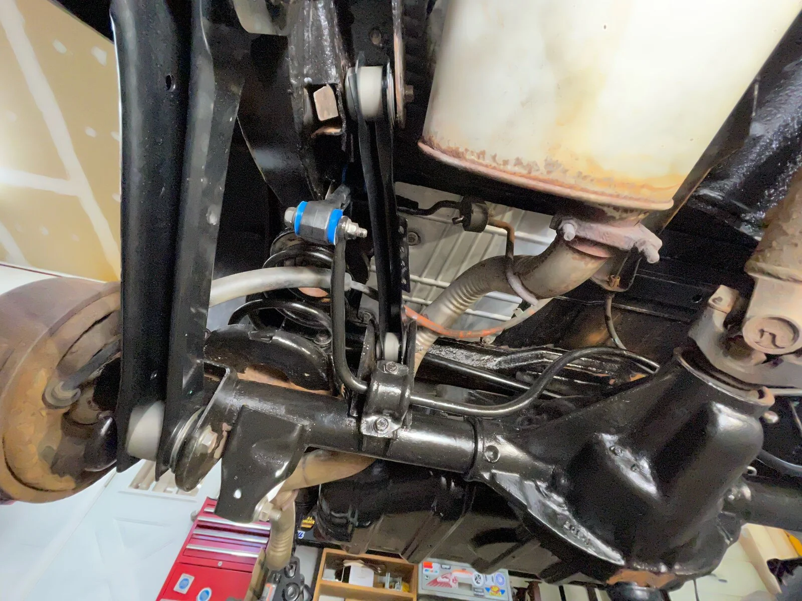

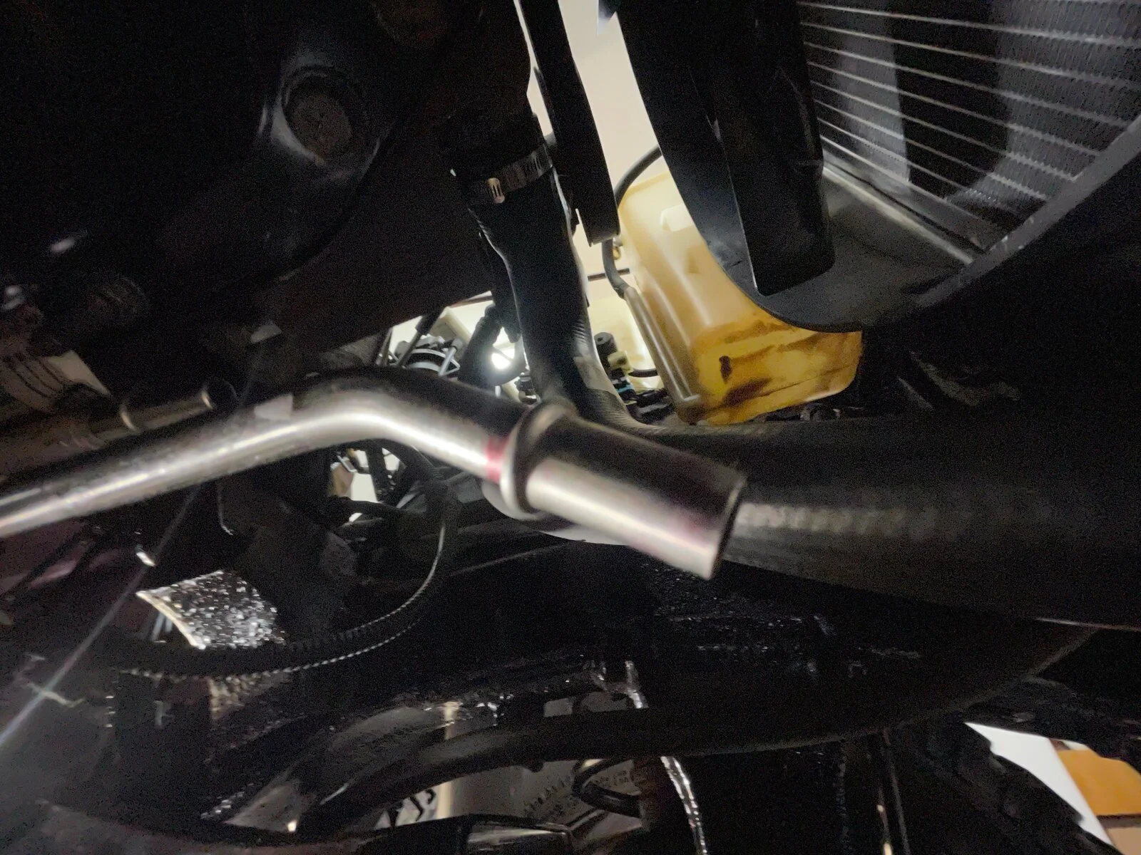

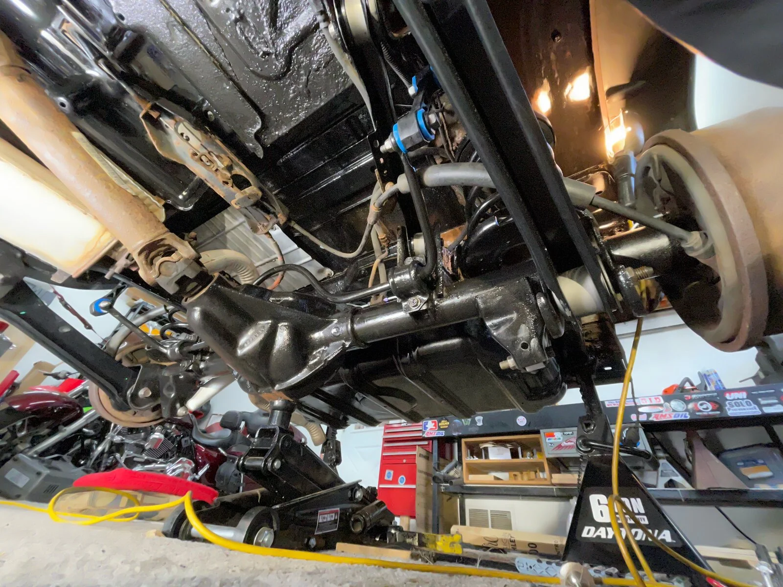

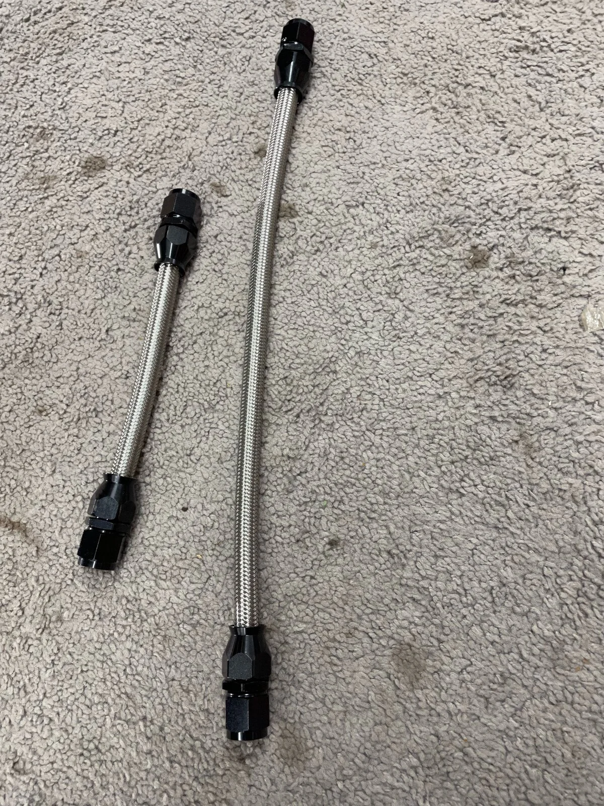

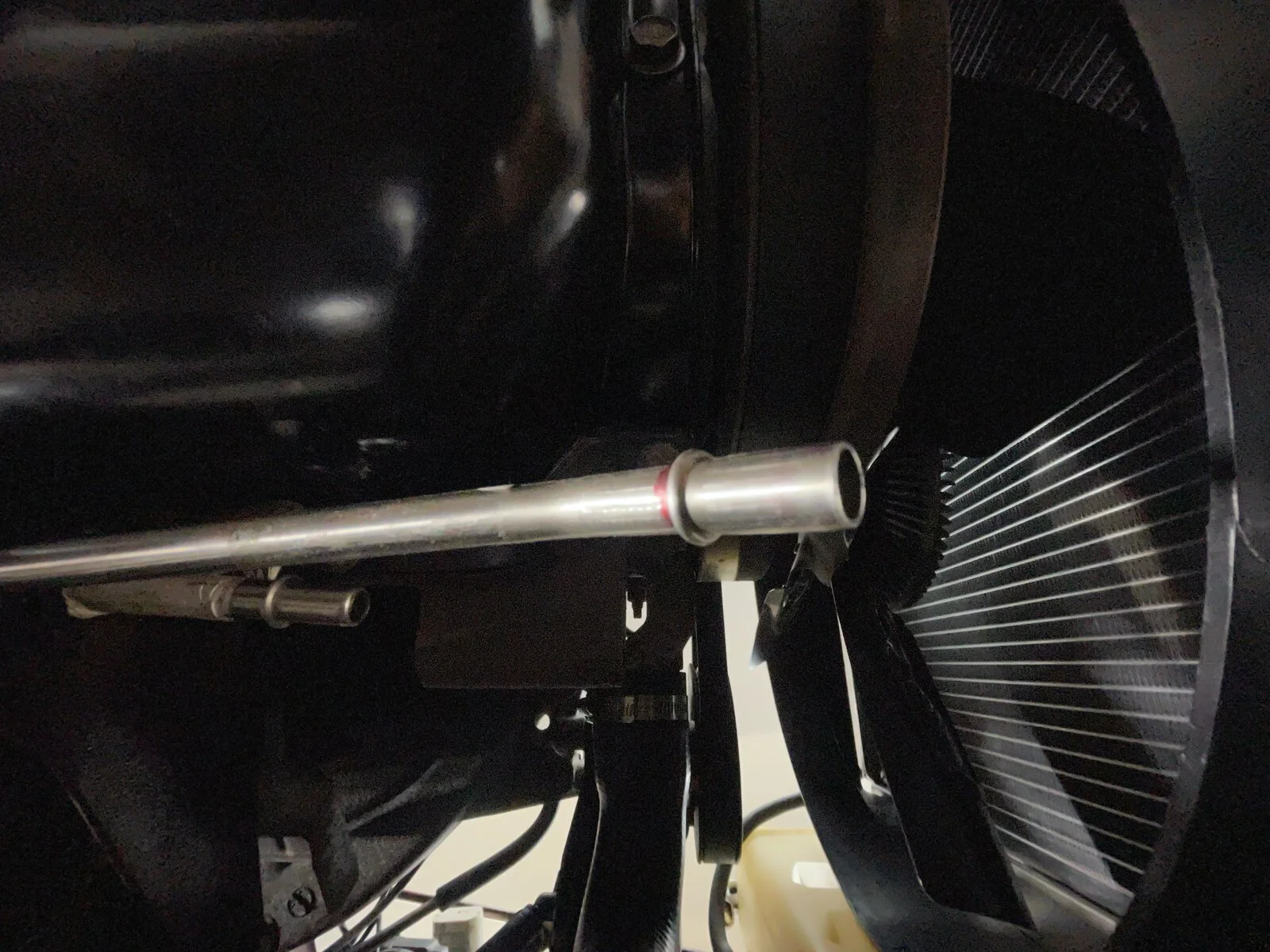

Ok everyone. An update on the Jeep. Almost done now. When I left off, I was just about ready to install the radiator. I put a Griffen radiator in and had to connect the lines to the trans cooler. More on that later. I moved on to the rear of the vehicle. I replaced the upper and lower control arms, put in a new track bar, sway bar end links/bushings and rear shocks. I also replaced all of the brake lines all the way around the Jeep. I cleaned up underneath and treated 95% of the rust underneath. I had a problem with connecting the transmission lines to the radiator. The company I ordered the lines from didn't put a normal transmission bubble flare on the lines. It looked more like a fuel line flare. My original intention was to put all nice Jiffy-Tite connectors but it ended up not working out. Instead I got a 5/8 inverted flare to -8AN to connect to the radiator, then I used a PTFE fitting to -8 to connect to it. I ended up buying a fuel line fitting to a -8 adapter for the trans line end and then a -8 to PTFE connection. It seems to have worked and it's not leaking. I put everything back together and checked for leaks and I ended up having a couple brake line leaks which I fixed while bleeding the brakes and the lines where they connect to the transmission were leaking. I tightened those down and it seems like everything is holding fluid the way it should. Here's some pics of the progress. First a couple of before pics of the back of the Jeep.

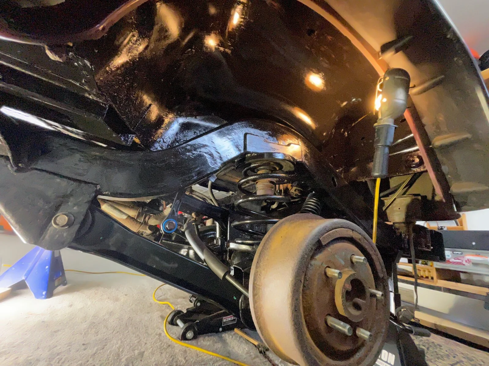

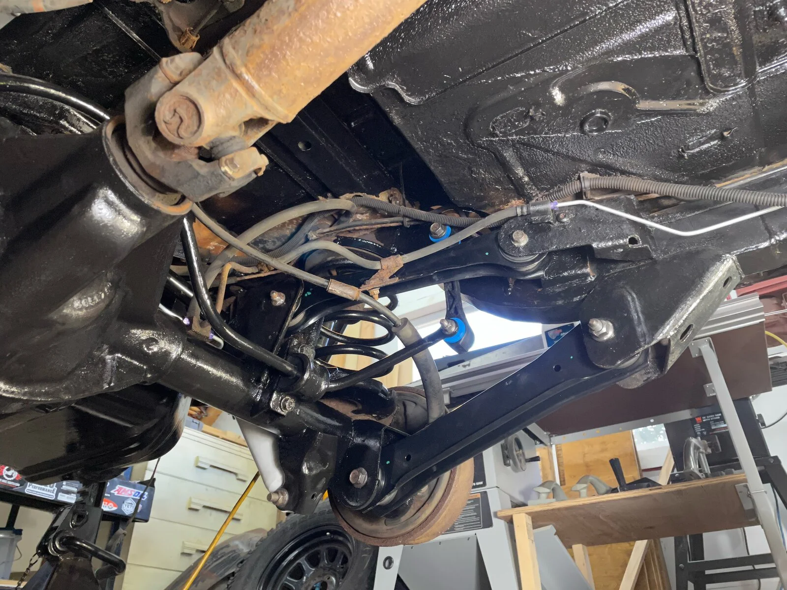

Here's a couple of when I finished the back.
The new radiator with new upper and lower hoses.
These were the transmission lines. Not with the typical transmission line flares. I may be wrong but I believe the company gave me lines with the wrong ends. Even the PTFE hoses they gave me with the factory ends wouldn't fit on these lines.
These are the lines before I installed them. They came out nice.
And here are the lines installed.
