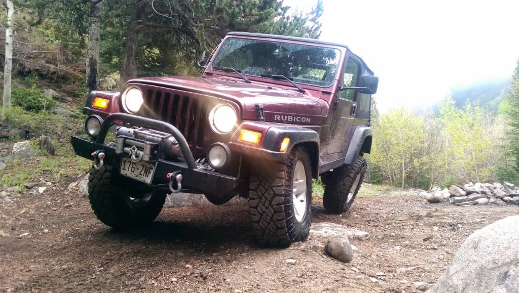

I'm running DuraTrac LT235/85 R16 which roughly come out to 31.5" x 9.25" on my totally stock Rubicon. I think 33" tires should work with just about any flat fenders with your 2" lift. There could be some issues caused by tire width and wheel offset. Just keep that in mind when looking for fenders. Heck, keep that in mind when looking for tires/wheels too.

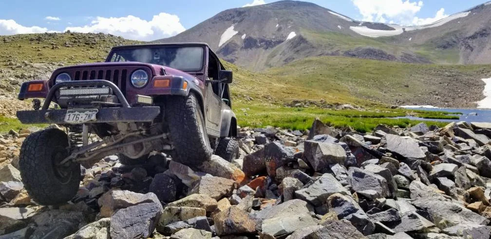

You’re probably getting 2-2.5” out of the OME. 31’s and possbly 32’s are good for that lift. The simplest and cheapest way to accommodate 33’s would be adding a 1-1.25” body lift. The other route is high line fenders like @Jorge Bolivar recommended. Add to his list Genright. Do your research because most flat fenders don’t give you any more clearance than stock. The ones listed by Jorge and the Genright do give more clearance. As always, when all is said and done you’ll have to bumpstop accordingly. Here’s mine on 2.5”OME with an additional spacer up front, a 1.25” body lift and 33’s
