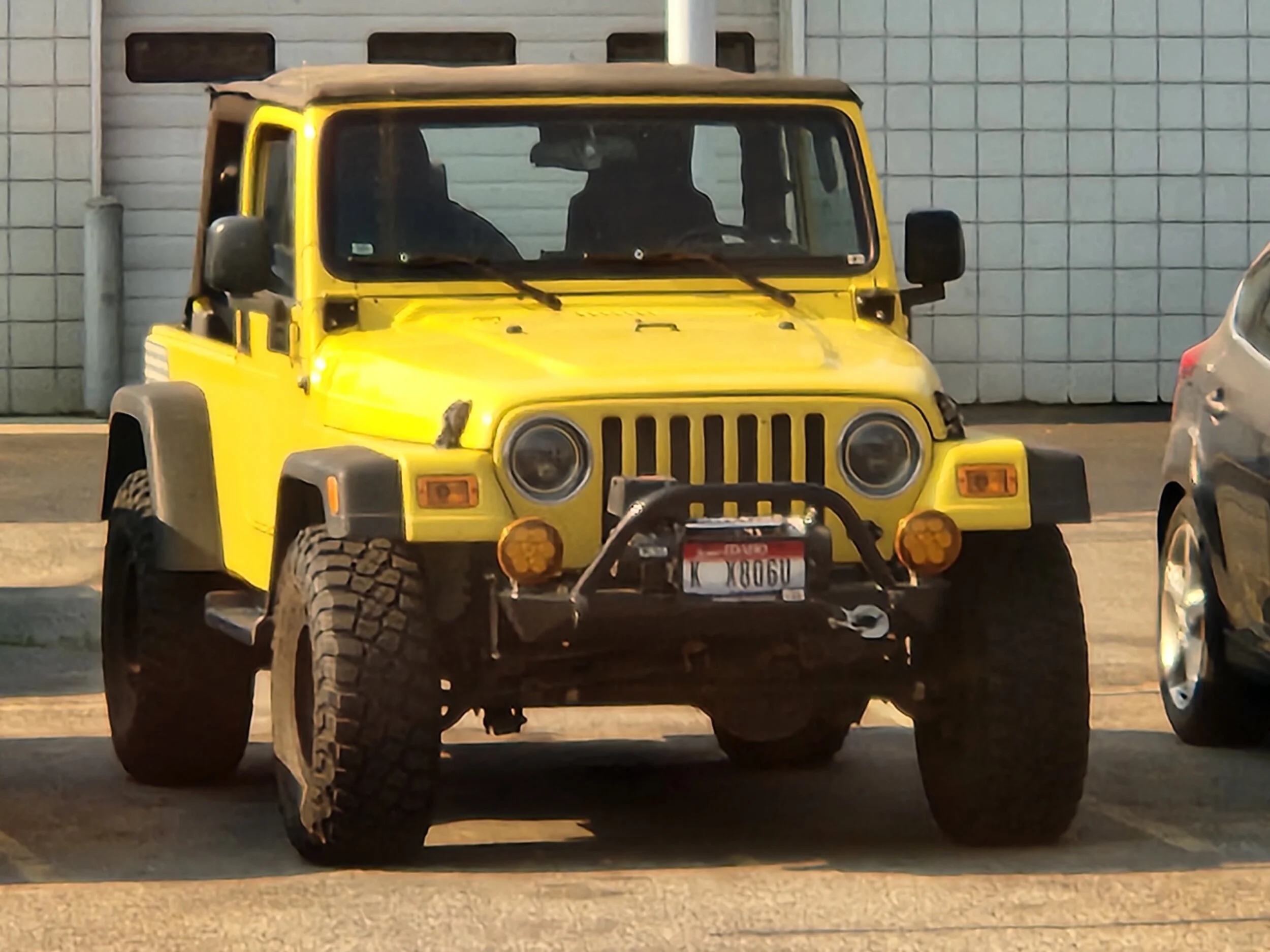

I’m purchasing some 12.5 wide tires, on some deep backspaced rims. I currently have the OEM painted fenders, and I would really like to get some metal flat tops, so I don’t ruin the paint.
I do like some tire poke, but I’m looking for some wider fenders to limit the poke. A good inch or two is what I’m looking for.
Tire size is 33x12.5r15. I’ve got a 2.5in lift, so I’m sure they’ll fit, I’m just looking for metal flat tops fenders.
You should really add a 1”or 1.25” body lift if you’re planning on off roading . You need more clearance for 33’s. Have you considered wider flares instead of replacing the factory fenders?

I’m definitely open to flares. Would be easier as well cause I can keep my original fender liner and turn signal.

I have the 6 inch Crown flares on mine and they almost completely cover my 33x12.5 KM3's
