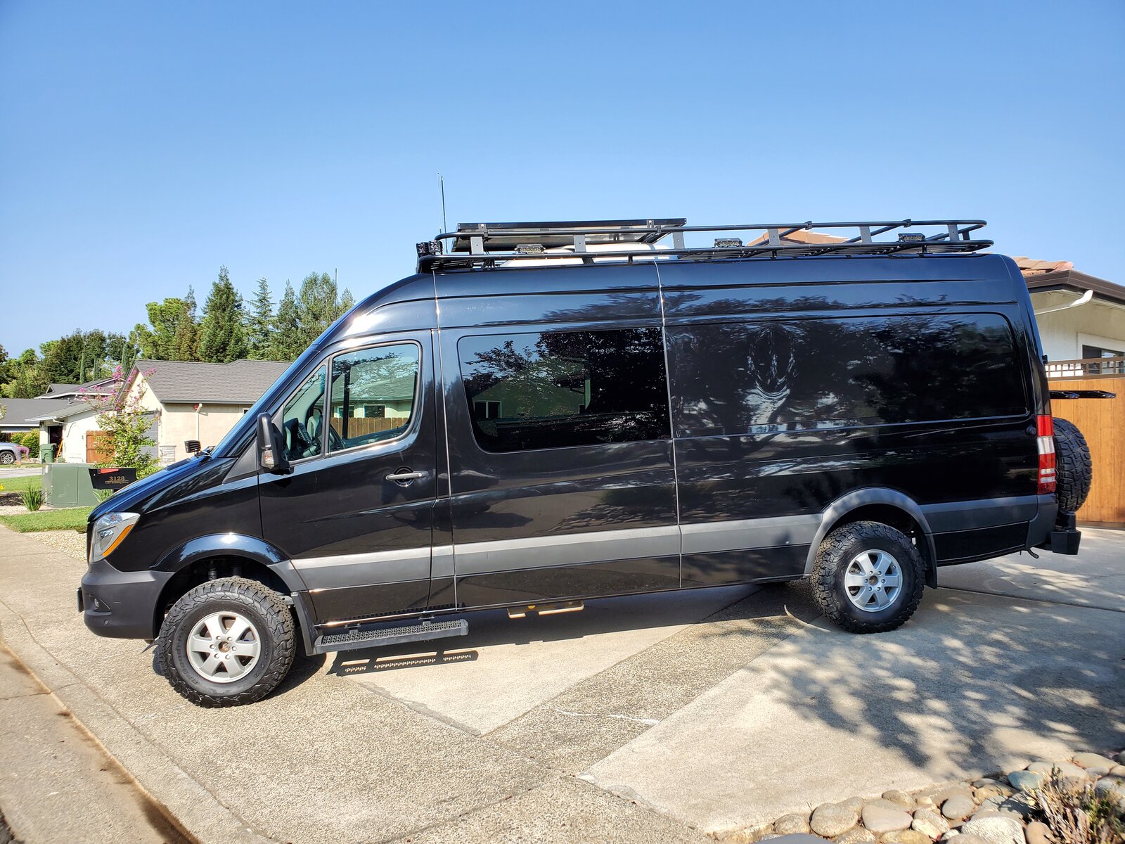

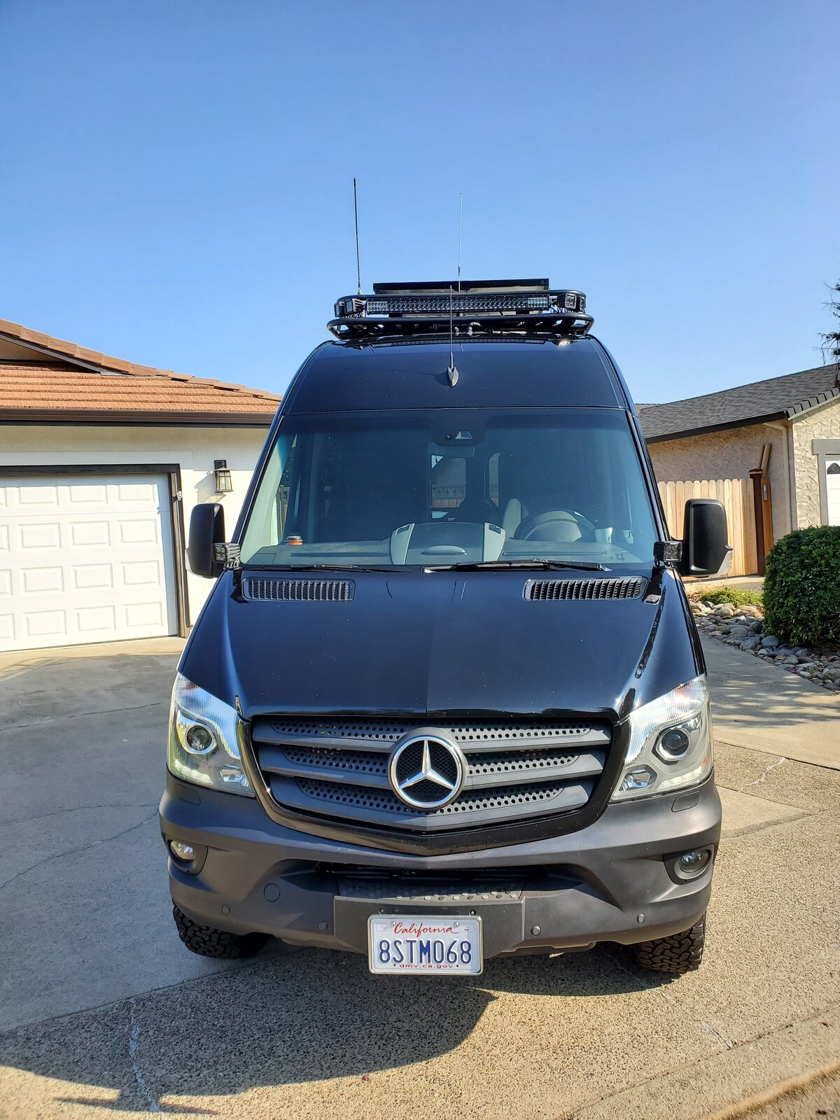

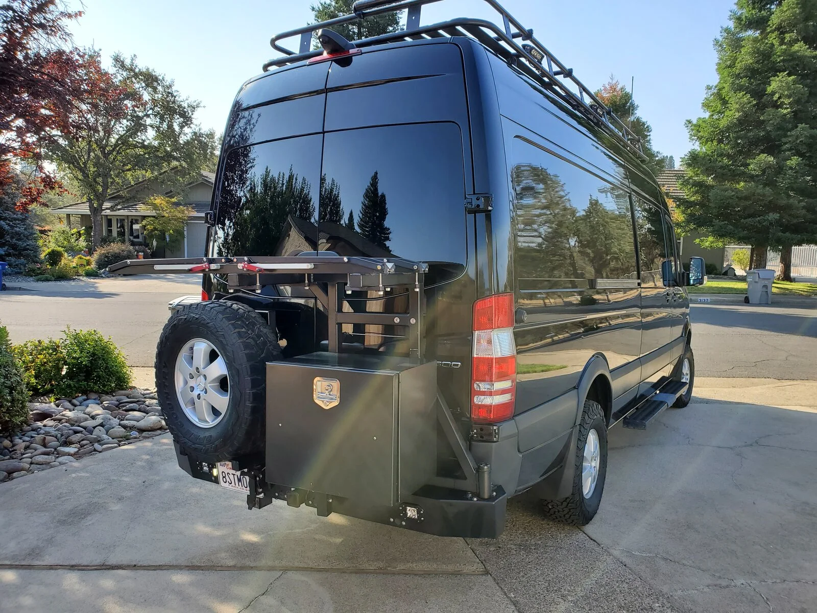

This is the Sprinter I'm setting up to tow my LJ:
