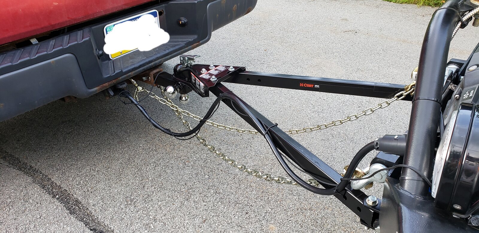

I attach my tow bar, connect the cable and plug the magnetic towing lights into the truck's standard adapter and that's it.
The brake unit itself runs around $500 and I paired it with a simple Blue Ox tow bar ($275 new, $85 slightly used as I found it). Safety cables and lights were about $90 together, so I'm all in for under $700.
Reliable and very easy to hook up and go. I've been very pleased with the setup thus far.

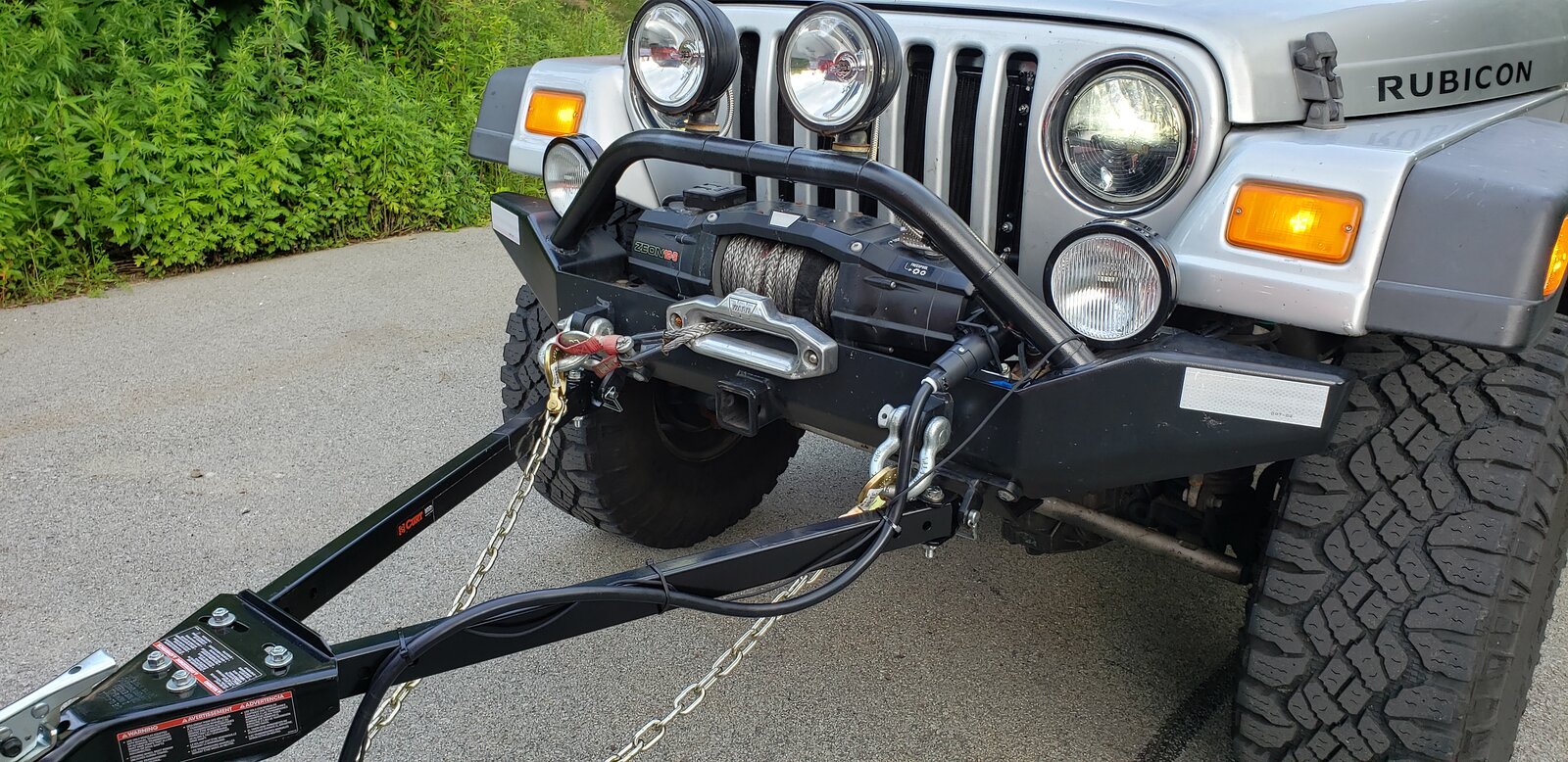

The cable that activates the Ready Brake runs thru the firewall on the TJ and is clamped onto the brake pedal. It terminates at the front of my bumper (It's the little hoop you see sticking out on the attached). The portion between there and the Ready Brake itself is a separate section of cable that you attach when towing and store when not. When installing/setting the system up, you adjust the cable to the length you want based on how quickly you want it to activate based on how hard you brake before it kicks in.
I think that's what you were referencing - am I right? The safety cables detach from both the truck and Jeep easily and the lights are magnetic; they plug into the truck's towing harness, run thru the doors/inside of the Jeep and sit on the back bumper - also just pull off and store when not towing.
Just like Dave C says, just unhook the cables, (from the brake pedal to the front of the vehicle stays on the vehicle all the time, no fuss). Simple cable disconnects right at the front bumper and stays with the tow bar. When I get where I am going the whole thing slides under the RV or it all fits in the back of the vehicle.
