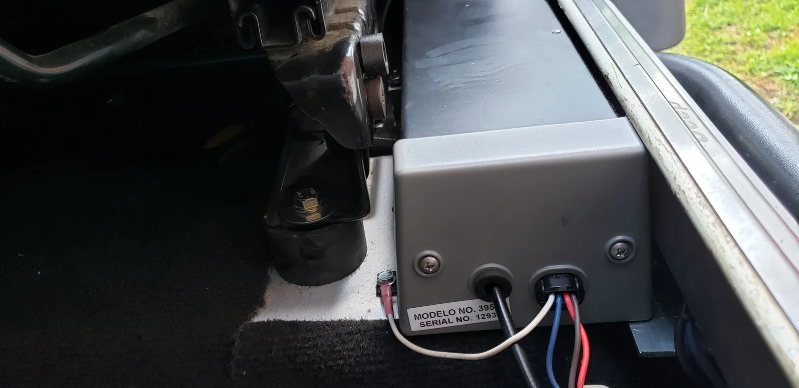

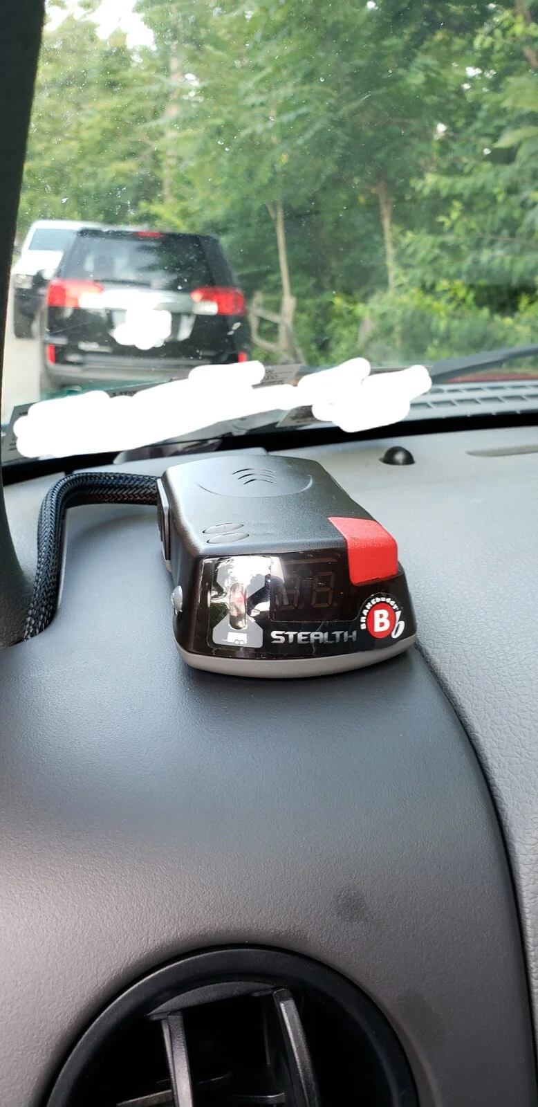

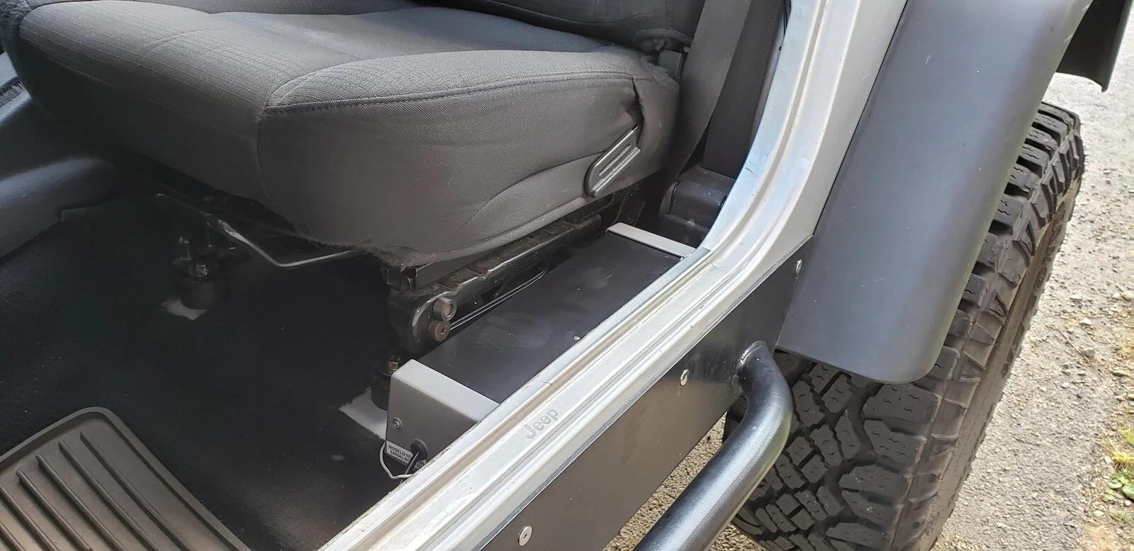

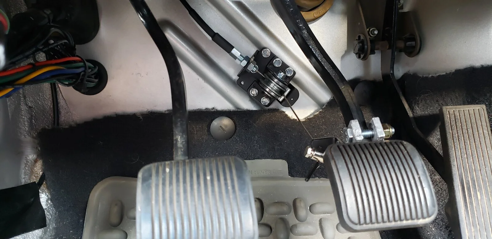

Photos of the Brake Buddy Stealth

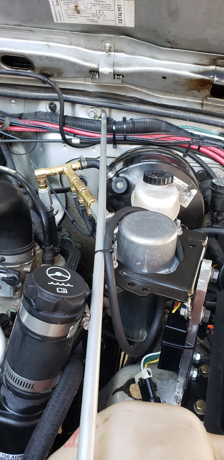

Hella UP30 vacuum pump:
Note the vacuum pump ties into all of the accessories too. I did this so I could also use it to boost cruise control power at or near WOT, and also to make use of the vacuum reservoir to provide a small supplement to the vacuum brakes while flat towing.
