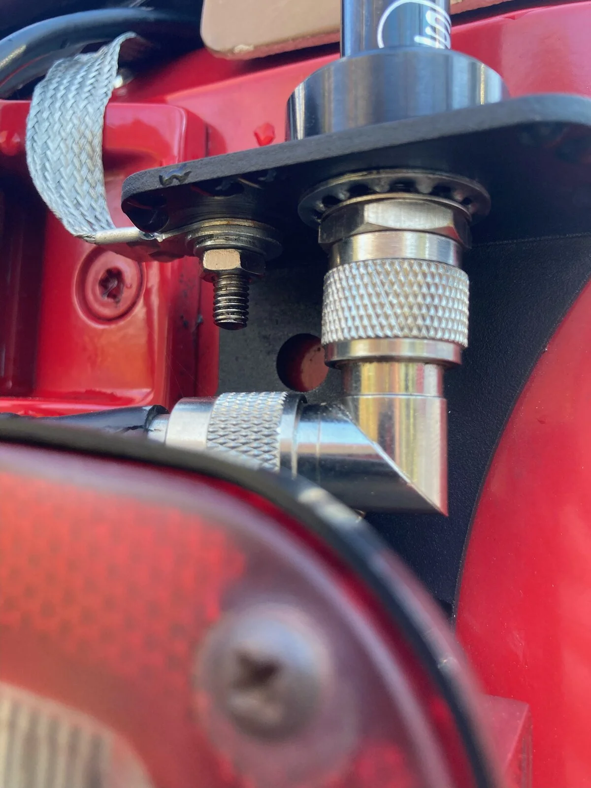

Our VHF radios are FM which is typically nearly immune to spark plug noise which is AM. How well is your antenna mount grounded? Can you post a good close-up photo of the mount and that shows everything from the cable to the bottom couple inches of the antenna? Have you done an SWR check as a sanity check to make sure there's not a problem with the mount or how well the antenna is tuned?

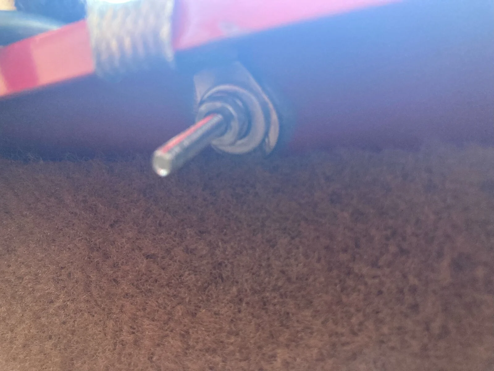

In the meantime, here are pics of my antenna ground. Although it's hard to tell in the pics, I can confirm that the ground strap is contacting bare metal, where I scraped the paint away with a wire wheel. Same is true on the underside of the antenna mount, where the coax comes up to the mount.
