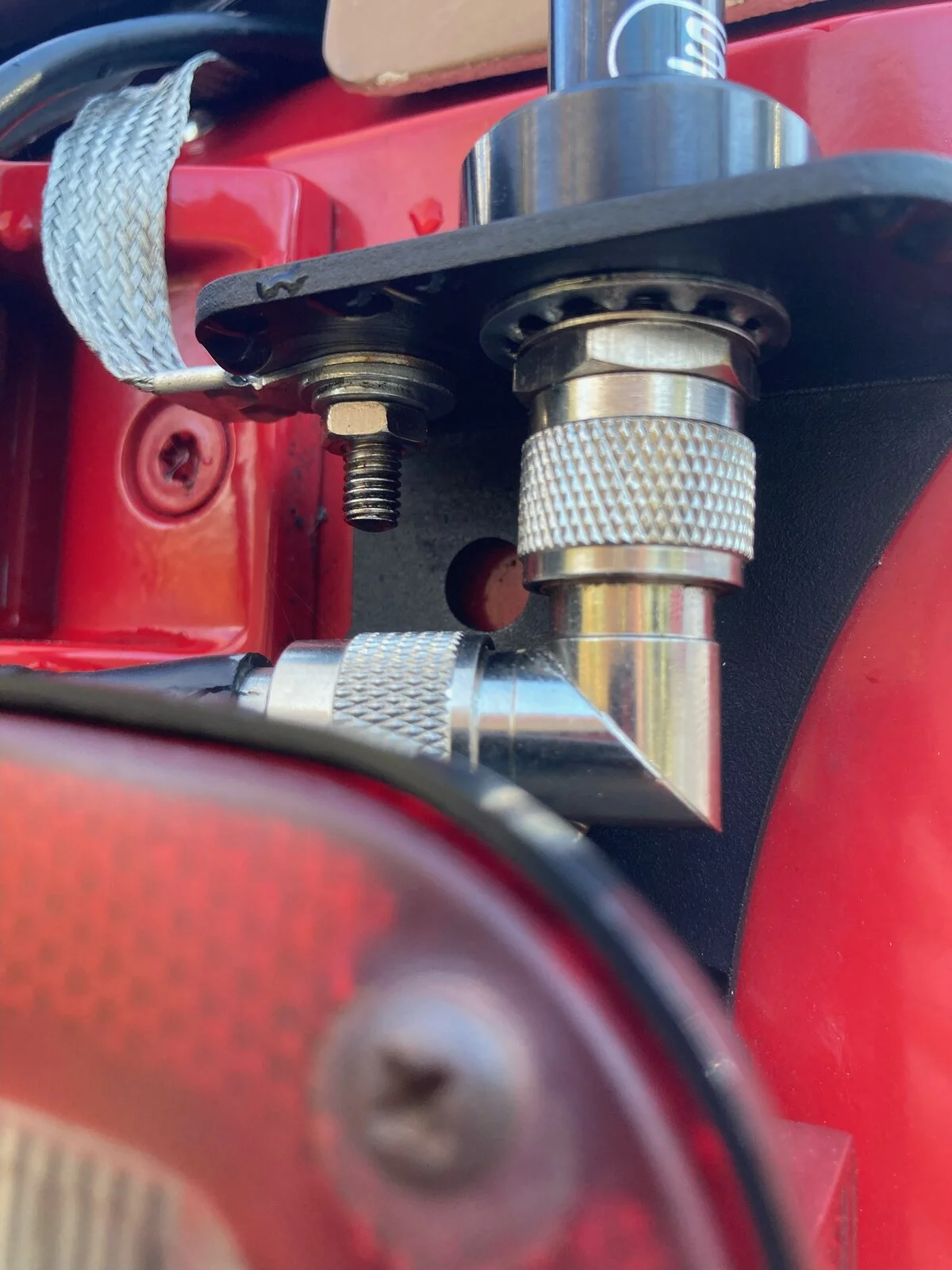

Did you get rid of the powder coating and paint in all areas touched by things that need to be grounded? Everything that needs a ground requires a bare-metal connection everywhere, including where the ground strap is bolted to the tub. And when an antenna has an installation problem like a poor ground and/or a bad SWR there can be odd problems here and there which could conceivably cause your odd sound.Great to hear, thanks. Yes, I have a hand-held that I could set to 5W, which is about the same as my CB, right?
In the meantime, here are pics of my antenna ground. Although it's hard to tell in the pics, I can confirm that the ground strap is contacting bare metal, where I scraped the paint away with a wire wheel. Same is true on the underside of the antenna mount, where the coax comes up to the mount.
