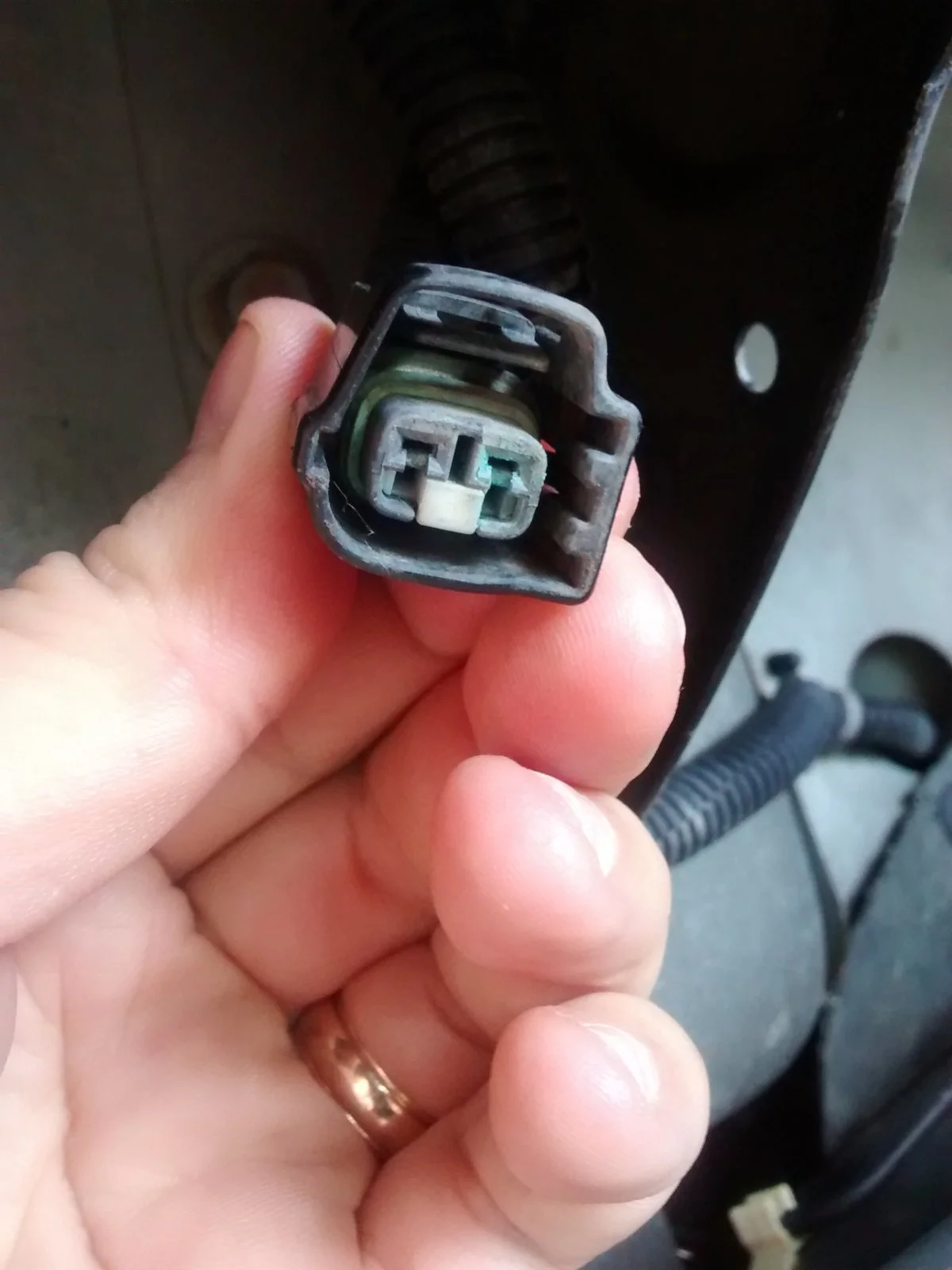

Hi Chris, I think I found it.. here are 2 photos, its an end of a connector that is part of the wiring for the side marker and parking lights that is unused. think this is it? what are the chances of me finding aftermarket lights that has the same plug connector that will plug right into the factory wiring harness that is left handing there?
I see there is a gray and black wiring going into that loose OEM connector. if I can not find a set of lights that will plug into the OEM connector, can I just splice the negative/positive wiring from the fog lights into the OEM connector and call it the day? if so, which is the positive, the black or gray wire? thanks
maybe this is what I would need but not sure it looks like it would fit but sounds like what I need. looks like the loose wires from fog lights would just be inserted into the one end and the other end should snap into the existing OEM connector? but looking at the end of my connector and the adapter, does not look like a match per the photo but the more I look at it, maybe it would fit.
http://www.quadratec.com/products/97109_09X6_PG.htm
That's the plug! The gray is the positive and the black is the ground wire. If you're not getting OE fog lights you can easily cut and splice your own connectors which is what I would do. Cheapest I have ever found OE fog lifts for is around $90 each. Pretty spendy!
Be aware that the wiring is designed for the 55 watt OE fog lights. Incandescent driving lights typically draw 150 watts so upgrading the wiring between the fog light relay and lights, and between the relay and battery, to a heavier gauge would be a good idea.
I think i will go with these lights, direct plug in replacement, no splicing involved and $120 for a pair. there is not much wiring behind the OEM connector once I cut it off so that makes me nervous in case there is not enough there to splice into so I think this will be the easiest option even though I can get some lights a bit cheaper if I splice.
