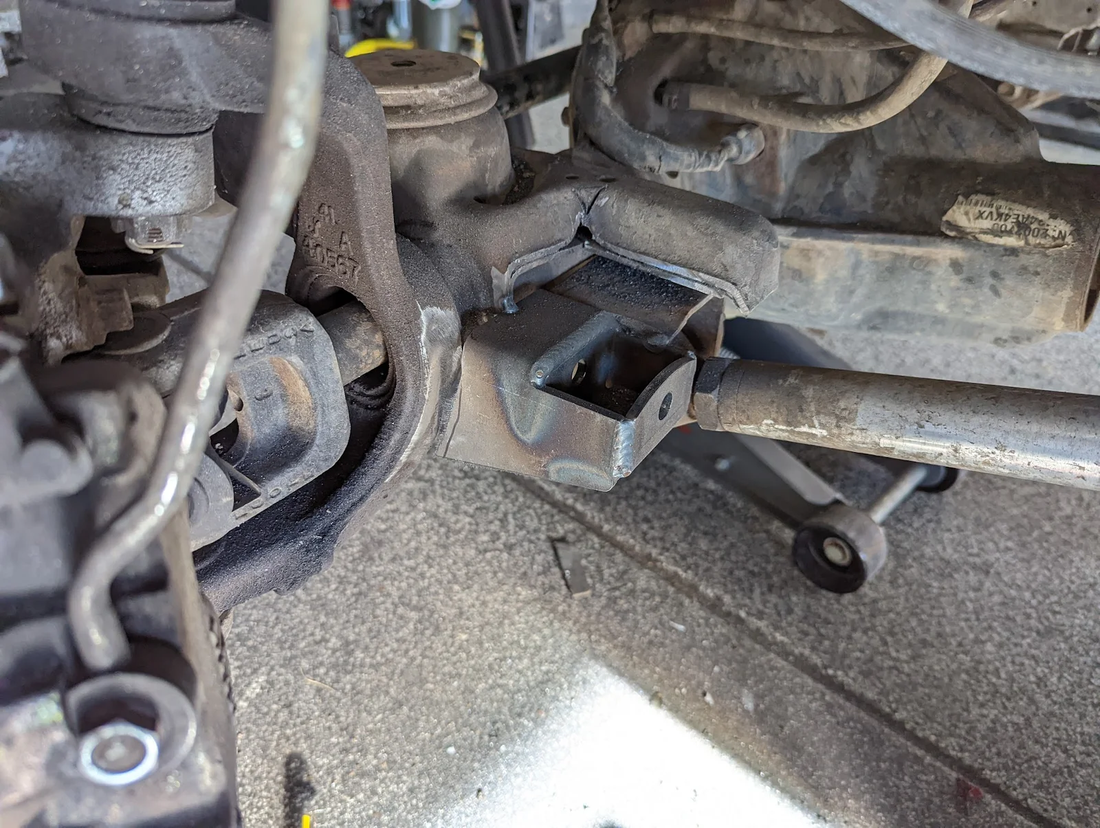

.... Now I'm looking at options for attaching the Poly lower mounts.
That part is miserable, no matter how you do it. Matt did a nicer job on his above than I did on mine. And I think we can do even better on the next one.
There's definitely improvements we could make - but it's good enough for now. The next person can benefit from what we learned :)

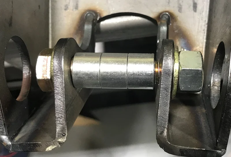

Spacers for 1.5" mounting width - $12

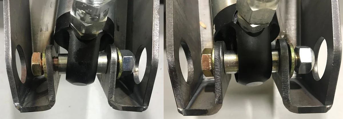

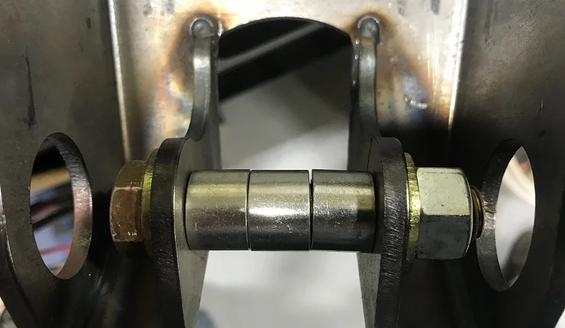

Also, be careful with the Poly Performance tower mounts. They had a run they outsourced to someone, and the top part of the weldment was overbent (in the photo below, the one on the left is wrong and the one on the right is correct - they were ordered a few months apart):
The replacement towers are in process right now (I hope to see them next week), so they are working on making things right. My point is - make sure you inspect them when you get them so you aren't surprised after you weld them in and try to mount the shocks!
That "bending" on those towers wouldn't even cause me to bat a single eyelash. Bending in quotes since that really isn't a bending issue. If you check the bend, it looks the same on all four eye side pieces. What is wrong is how they fixtured them for welding and like most places, they didn't use a piece of tube cut to length to hold the width correctly. They just hand fixtured and tacked in place. But again, that wouldn't even slow me down. I'd run a regular nut on that bolt, impact it tight and then remove it. Those two sides will suck right up to near perfection and certainly enough to work very well. In fact, I'd much rather deal with that than the ones that are too close together slightly that I have to spread some and still fight getting the shocks in.

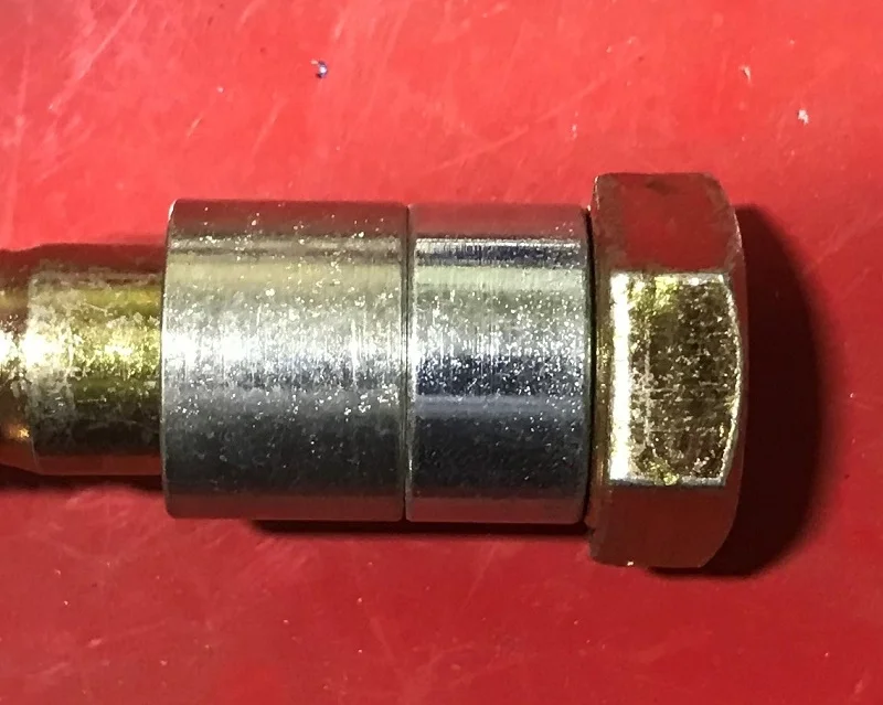

3 bucks each for spacers is cheap. How thick is the wall on them?
If ya'll will ever start capping off the back of the spring perch after it is cut flush to the back edge of the axle tube, it gets to be far less miserable. Start right in with doing that and then drilling the spot welds on the cam horseshoe and get that off of there does wonders as well. That gives you a nice face to butt up against for the inside. If you need it to move out, weld a piece of 1/4" to it.
I like to weld a JJ washer in the slot and leave the top 40 degrees unwelded. That gives a lot of up and down adjustment to fine tune the height. In fact if you cap off the back of the spring perch, you can cut the inner leg that wraps around the tube off by continuing the line straight down. That leaves one leg to cope to the inner C which is minor.
You're right about it being a fixturing, rather than a bending, problem - I didn't look closely enough at the picture. However, I did initially investigate using them as-is and decided not to. I didn't take pics when I did this a couple weeks back, but I just took a few now to help explain. Here was my decision process (WARNING: If geeked-out engineers trigger you, skip this next section): First, the new spacers are 1/2" wide, and so is the shock bearing, so I stacked three of them on the bolt and tightened them down:
I didn't like how they're loaded (tight at the bottom of the picture and gaps at the top). That'll create a meaningful stress riser at the mounting point. I then loosened them to see if the bending was plastic or elastic. I want it to be plastic because these towers are not made from spring steel, and if the bending is elastic, the joint will loosen up over time due to creep (a/k/a cold flow). The bending was elastic (photo below is after the photo above):
Okay, so at this point, I'd not given up just yet. Using sockets/spacers, I put this in my shop press and started to use it to plasticly deform the ears by bending them further than the mounting width. What I discovered is that the ears, when welded in place, are so stiff that the deformation occurs in the back plan of the tower (it bows out in the middle by the ears). At this point, I decided a call to Poly Performance was in order to get the right parts, as the next step for me would have been to cut the ears off, fixture it properly, and re-weld them on. However, I paid someone else for that (Poly Performance). Again, Poly Performance has been great through this process are have promised to make it right.
Same as the 1.25" mounting width spacers that came with the shock (about .090"):

The ears that spread after tightening, what did you torque the bolts to?
Good on the spacers. We see a bunch that are thinner wall that just distort like a crush sleeve.
