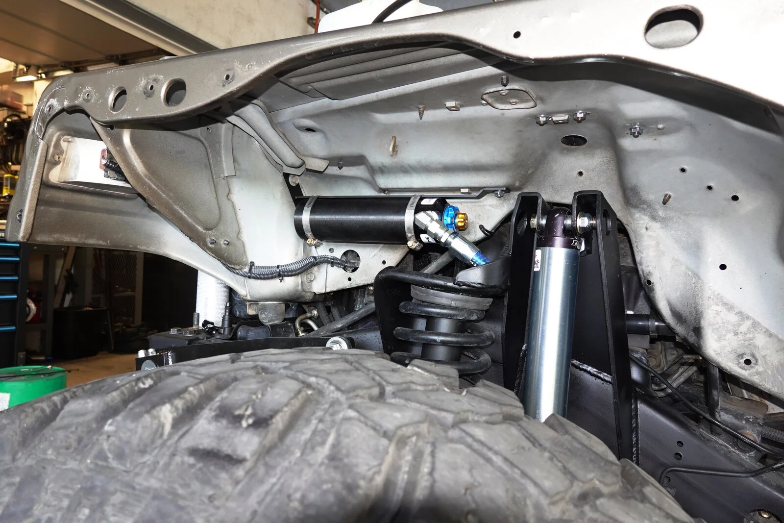

After seeing Blaine's pics that's how I'm leaning. I've already gone from hundred something dollar of the shelf shocks to the the Fox Remotes. What's another $200 on the Poly mounts. I guess I know where my Polis Bucks are going!

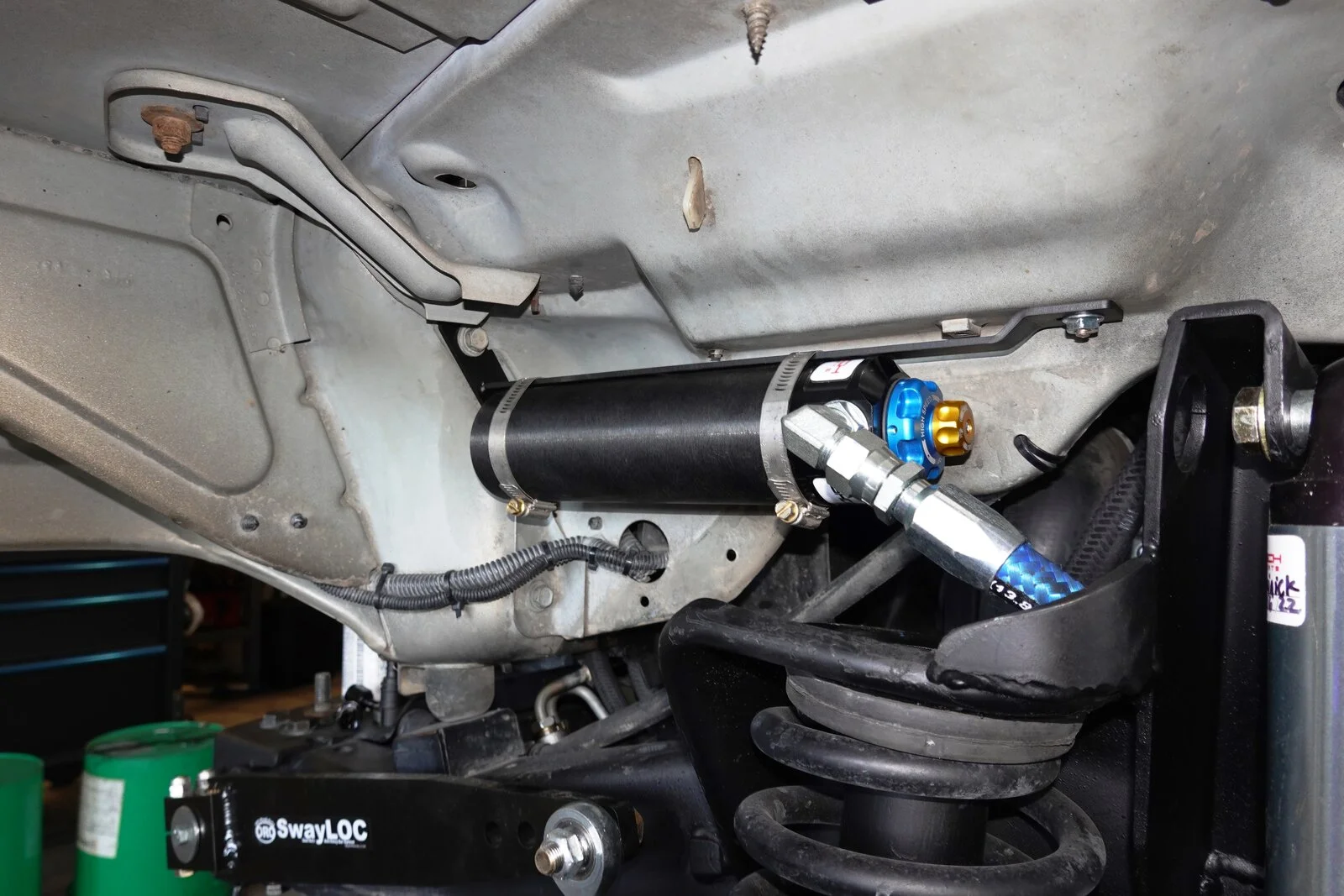

We have a few front and rear outboards under the belt if you want to take a look.

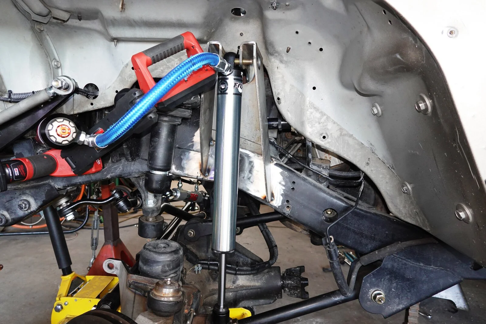

Anyone figure out that those two pics are not of the same shock and they represent $1200 just in shocks?
I noticed those, I was speaking to the tuner shop you recommended about that mod and custom tune. The two speed adjuster seems like the way to go. I asked for a price for the mod and tune and the price I received seemed way low ( I was speaking to the employee). Is that $1200 for the pair?
