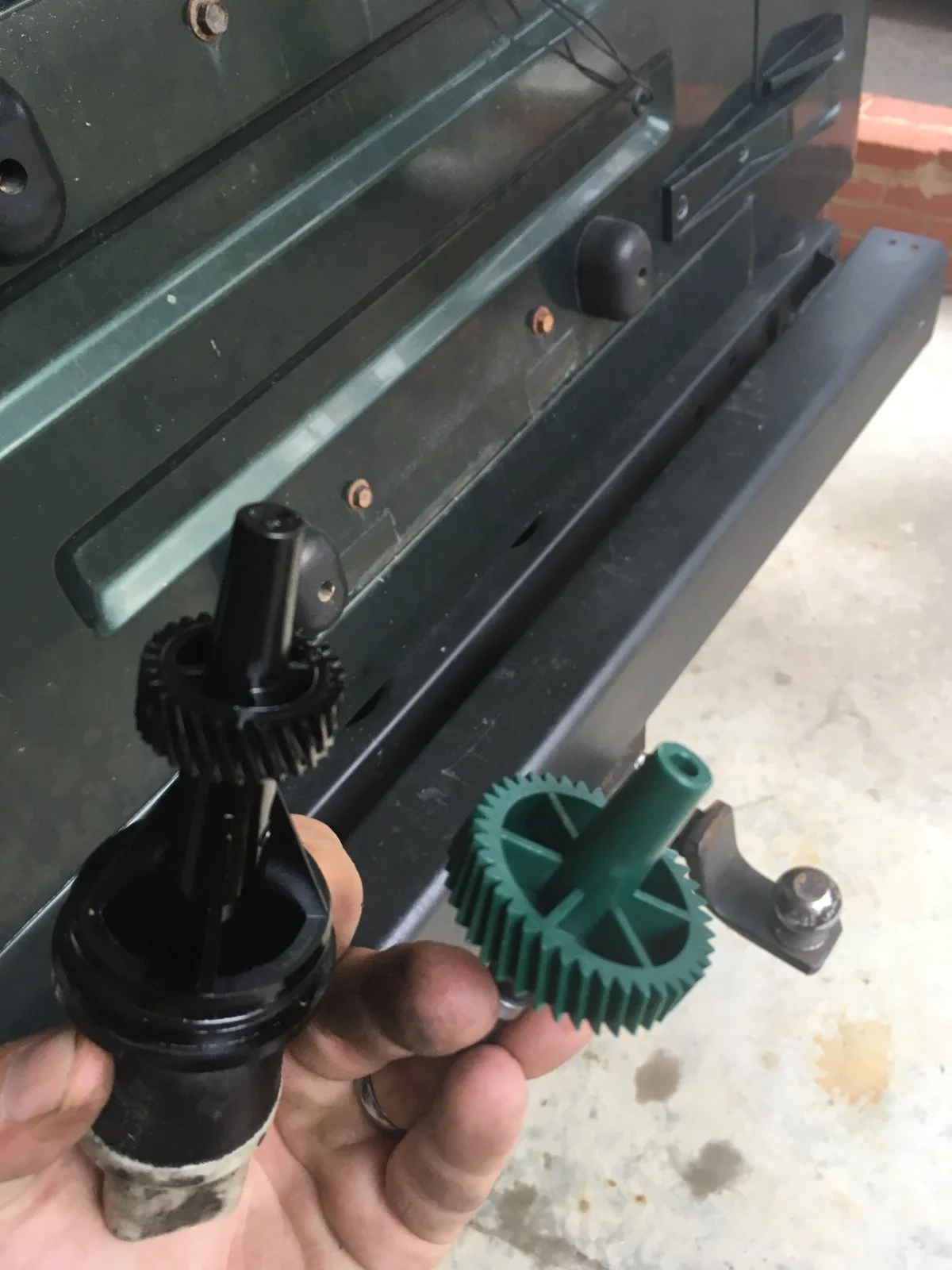

If you've been blowing off replacing your speedo gear because you weren't using it as a DD, now's the time to get it.
Right after I had my lift and tires put on (and when I was still using my TJ as a daily driver), I didn't replace my speedo gear. I couldn't figure out why everyone on the highway was going so friggin' slow while I was still trying to hit the speed limit.
It's on the list, I checked my speed with an app and at 70 my speedo reads 90.

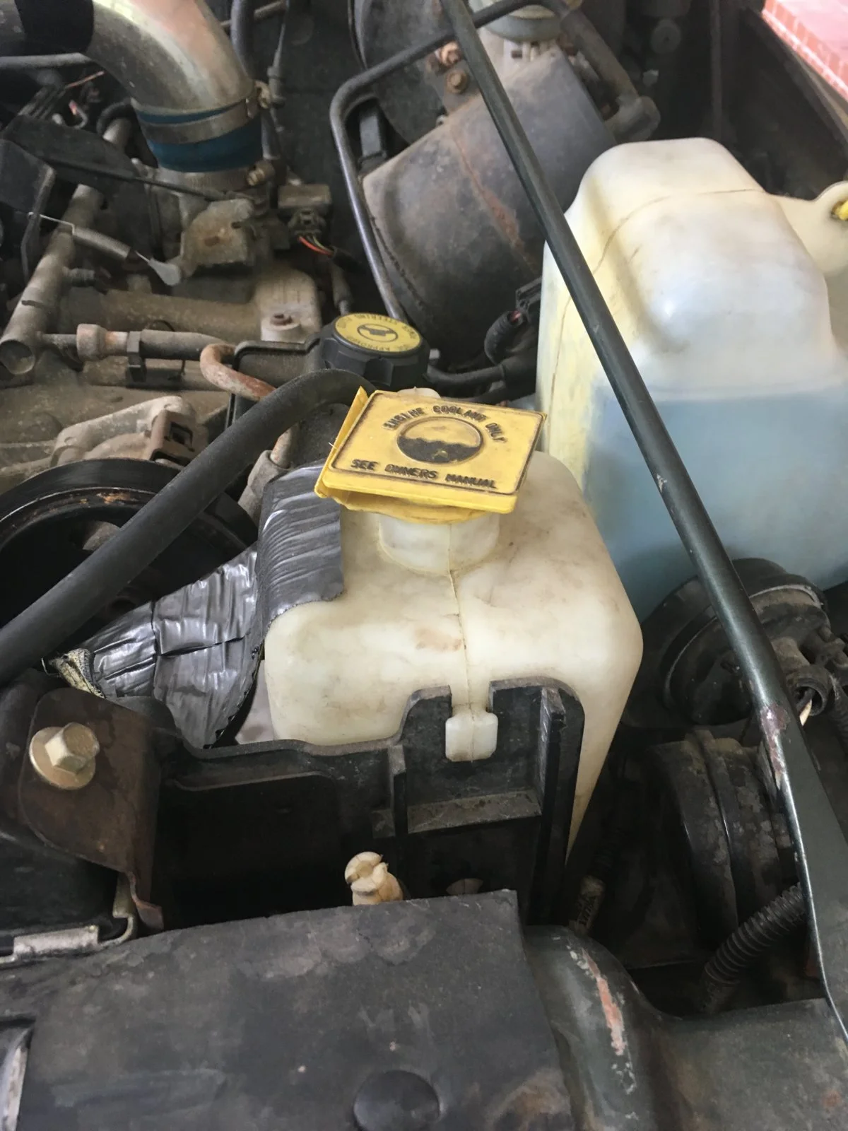

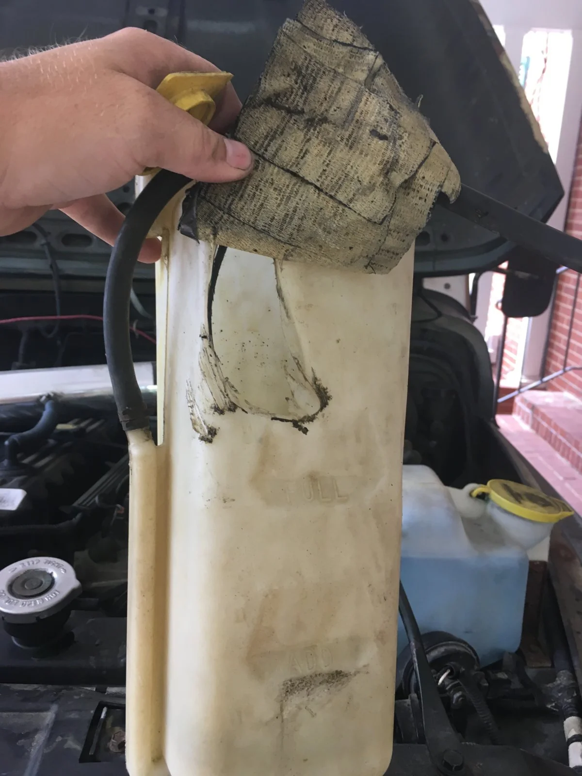

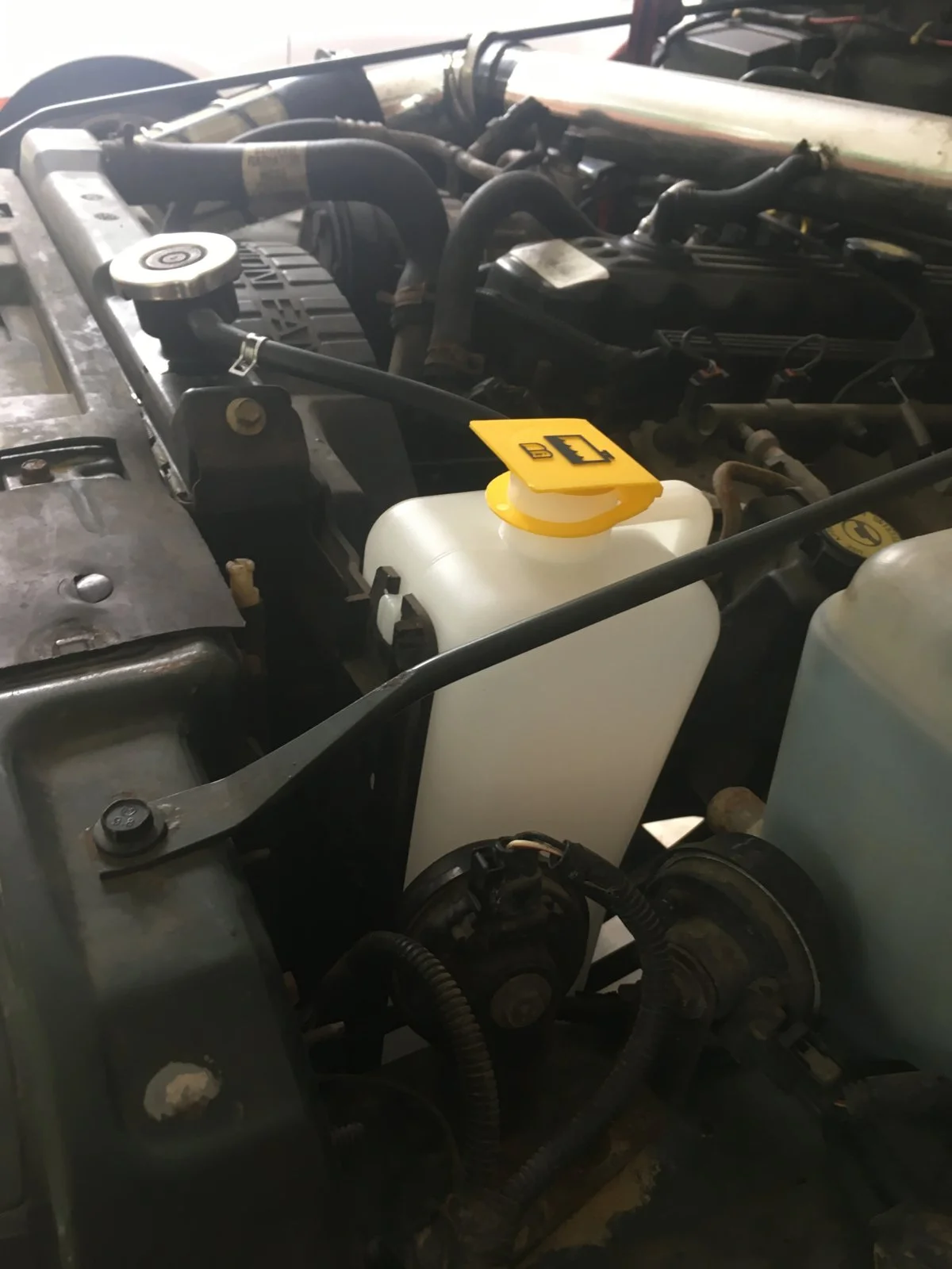

I probably sound like a broken record at this point, but I stand by my statement that one of the most important systems (and probably the most common system to fail with mileage and age) on any vehicle is the cooling system. That being said, if I was going to daily my TJ, I'd make sure the cooling system was overhauled.
A lot of people would assume that just because they have 50k miles that their cooling system is fine. However, if your cooling system has 50k miles but your vehicle is 13 years old (assuming it's the stock cooling system), then it's still time for some preventative maintenance if you ask me.
That being said, this thread may be of use to you: Jeep Wrangler TJ Cooling System Overhaul FAQ

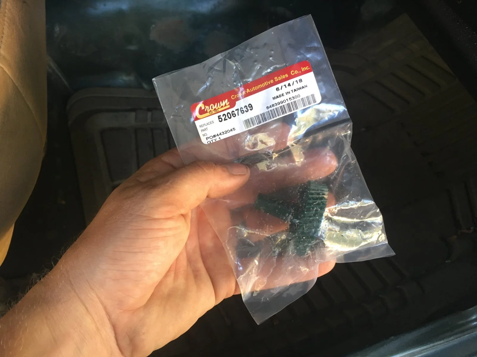

The speedo will finally be accurate.
The only issue I found was where the SYE is kept me from setting the gear mount to the 39-45 space, it's at the space for up to 38 and I installed a 39 tooth gear. Doesn't seem to have any ill effects so far.
