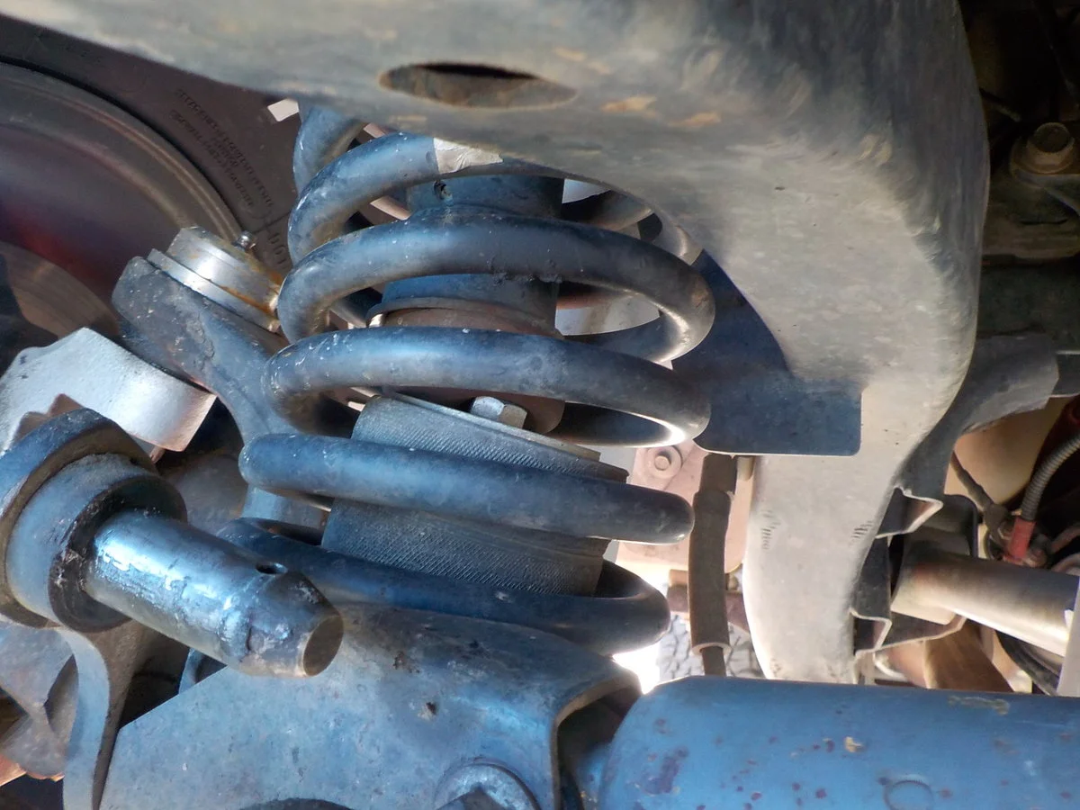

The front bump stop extension should be added to the axle side. The rear can be added to the frame side by extending the cup.
Hey, which is the reason for that? Can you please help me understand?
Extending the front upper can eventually lead to the cup plucking the springs as the axle moves. It's annoying! :)
