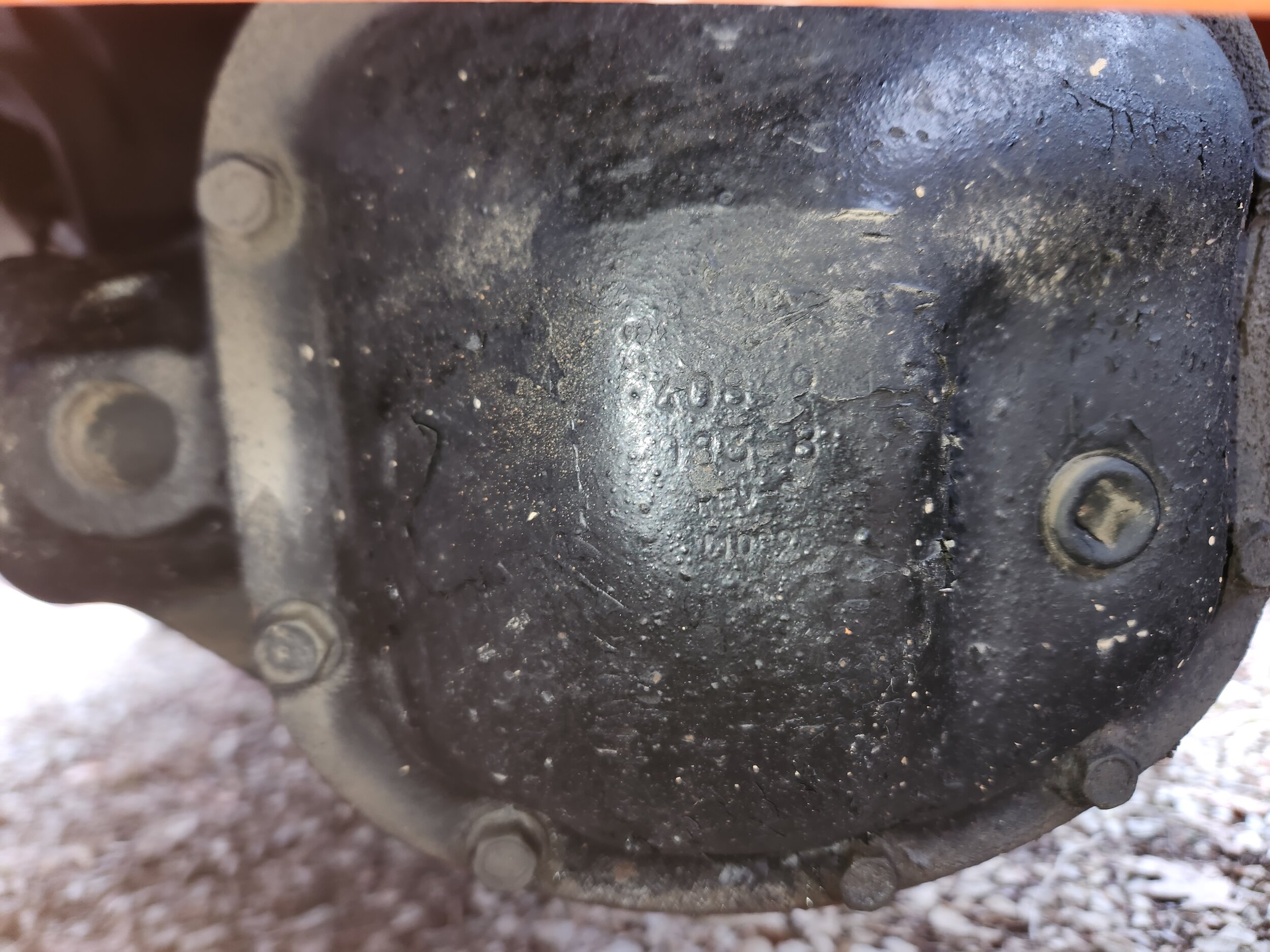

I was wondering if it might just be because of the insane gearing but the loose feeling of the front end made me question that as well as the mechanic not being able to align the front end and keep it there because he said it would move on him.
I just put on new Rough Country shocks in August and new sway bar end links last week because the old ones had a ton of movement. I'll have to check again what the axle gearing is, it's faded and hard to read and I couldn't match it to any of the usual ratios though it was close. I believe it was in the mid to high 4s.

I don't know if you'll be able to make anything out by this, but it's all I have to go off of. It could be the low gearing causing the lurching like JMT said, because when I'm engaging the clutch it never happens.

Your gearing isn't insane, nor is it the cause of whatever you are experiencing. This is most likely a shock or a sway bar issue allowing the body to react dramatically to engine torque.
