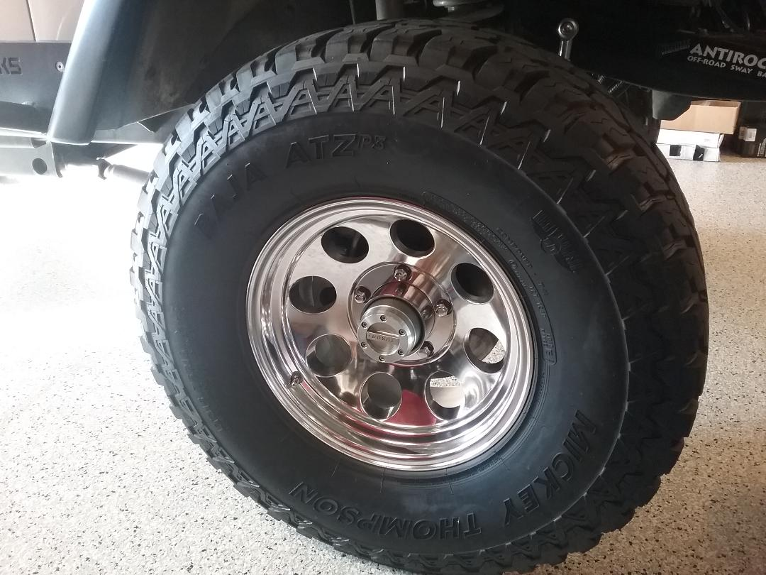

I purchased the Yukon 5x5.5 manual hub kit (YU-WA-08) on Amazon, sale price $1,078.41. Black Magic 16" brakes were installed at the same time. I sold my 5x4.5" wheels and purchased a new set of 5x5.5" wheels, but re-mounted my existing Mickey Thompson 35" tires. A few months later I was able to purchase a pair of spare Yukon hubs, bearings, seals, etc. from a board member at a good price.
I have not experienced any negative issues with my Yukon hub 5x5.5 hub kit, have not yet needed any of the spare parts, and would make the same decision again.
I'm running the same setup (including the brakes) and have been very happy with it as well.
