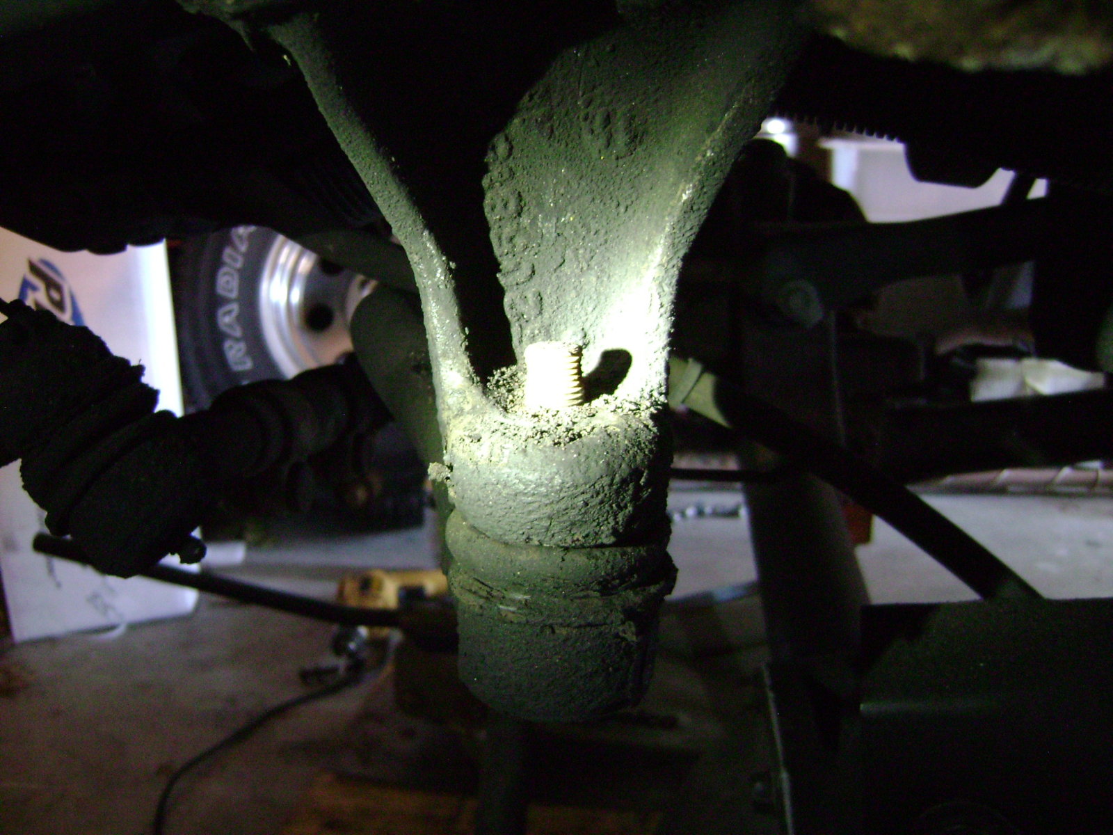

Trying to remove the front track bar. The axle side came off. On the frame side, I took the pin out, removed the nut, but the bolt won't budge. I whacked the frame end of the track bar from one side and the other. I also put the nut back and whacked it, although the angle doesn't let me put a good whack on it. So, am I missing something? Is there a secret? Thanks in advance.

Now I’m totally confused. I already took the castellated nut off. There’s nothing else to turn. I just need for the bolt to slide down, no?

That clarified your situation. If your axle is drooping from the frame being up on jack stands as it appears to be, that's putting a LOT of sideways load on that track bar bolt. Use a jack to raise the axle back up to its normal height which should remove enough sideways load off the bolt for it to come loose more easily.

The axle end of the track bar is loose, and I already propped it up so that the frame end is in a more natural angle. Still, it’s frozen.

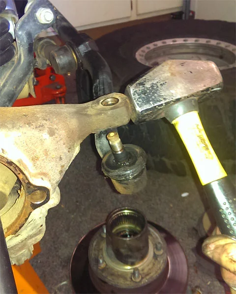

Try a BFH to give several mighty (put your big boy pants on) whacks to the side of the track bar bracket which should pop it loose. Like this picture is showing how to pop the tie rod stud down & out of the knuckle.
Thanks, I’ll try that. And if that doesn’t work, fire.

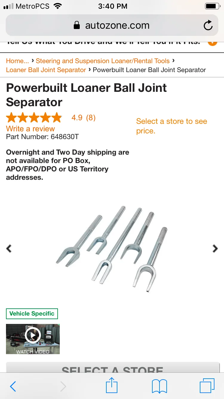

This is the kit I borrowed from Autozne that helped me disconnect the track bar some people also call it pickle fork.
