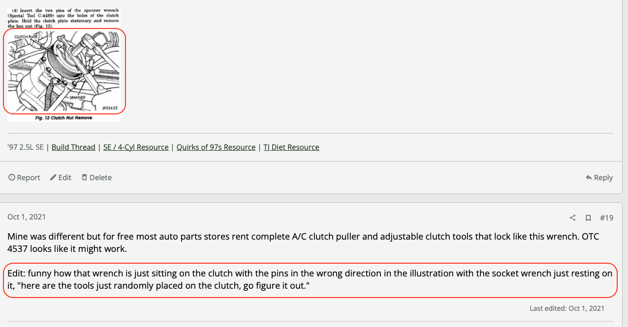

Like some of the pictures, I gather!

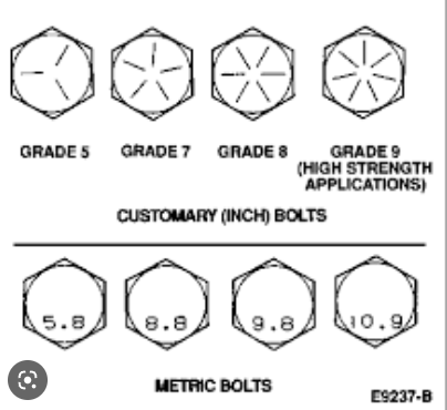

When I had issues with my ring gear bolts backing out, I did some research and this is what I came up with - at least regarding the Dana 44 in my TJR:
  • Ring Gear Bolt is PN 45784 and is 7/16-20
  • This spec for 45784 says it is Grade 8, but note in the picture there are 7 lines; Gr 8 has six
  • This spec for a kit of 45784 says it is Grade FW-9, which I can't find much online about but I was able to find one image showing a Grade 9 hex head with seven lines:
So I'm assuming the strength of the bolt is somewhere between Gr 8 and Gr 9, but I'll use Gr 8 specs for the next part to be conservative:
  • The recommended torque (clamp load) for a Grade 8 7/16-20 is about 80 ft-lbs dry and 60 ft-lbs lubricated
  • FSM says to install to 100 ft-lbs and makes no mention of Loctite
  • Proof load for 7/16-20, unlubricated, would be around 100 ft-lbs
My conclusion is the FSM intends for the ring gear bolts to be installed without loctite and torqued to proof load, which would explain why they make very clear to use new ring gear bolts (because the spec calls for the bolts to be torqued near the yield threshold) each time.
