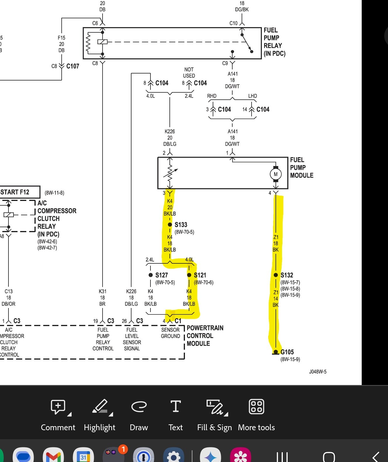

For the fuel issue, have continuity on these wires highlighted in yellow from the the pump module to the Frame, I know the Z1 wire grounds to the engine block, not sure if the K4 wire suppose to have continuity between the pump and frame..?
There are no ground wires going to the frame, but its not like it is intentionally to be isolated from ground either so the frame could have some ground continuity. For the wire going to the PCM, do you get continuity all the time or just with ignition on? Do all of your other gauges work correctly or have you not gotten far enough on the LS swap to check that? I will note when I put a Genright fuel tank, my gauge showed all the way E until about 7 gallons.
