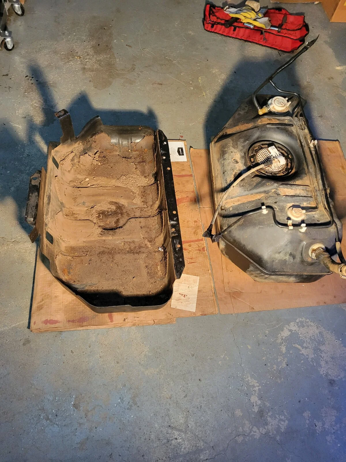

Man I forgot how annoying the filler neck is to get out.

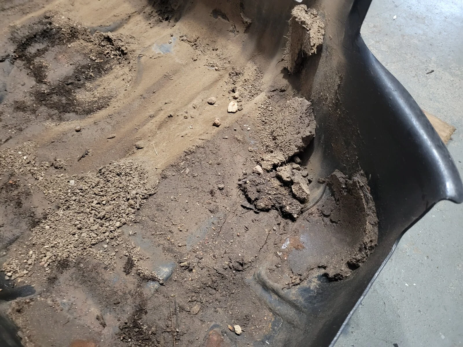

18 years of mud. Man I can't get over the fact that kids born in 2005 are voting. Even this dirt is older than them.
