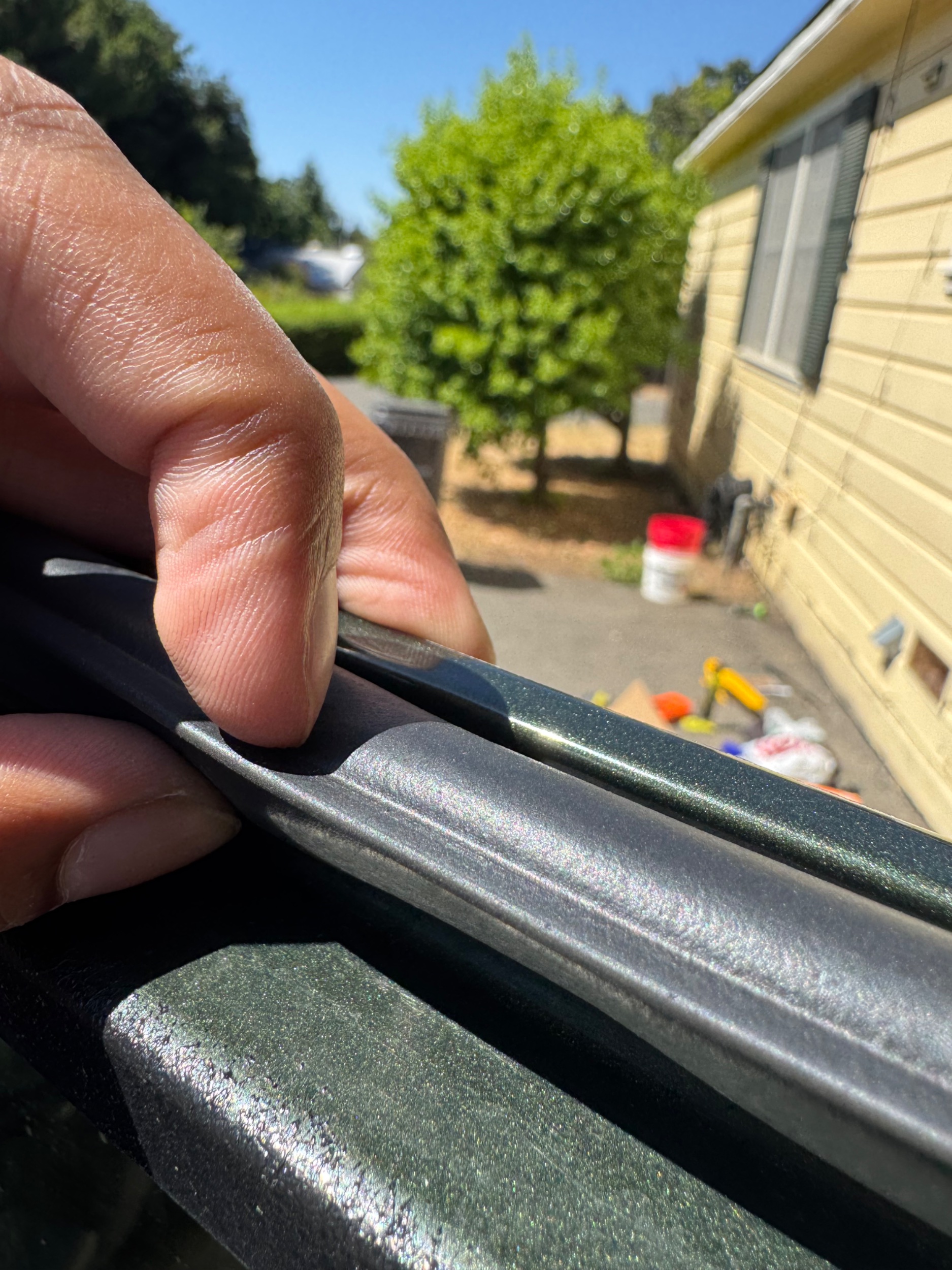

Here is my good driver’s side seal, notice how deep the inner lip is.

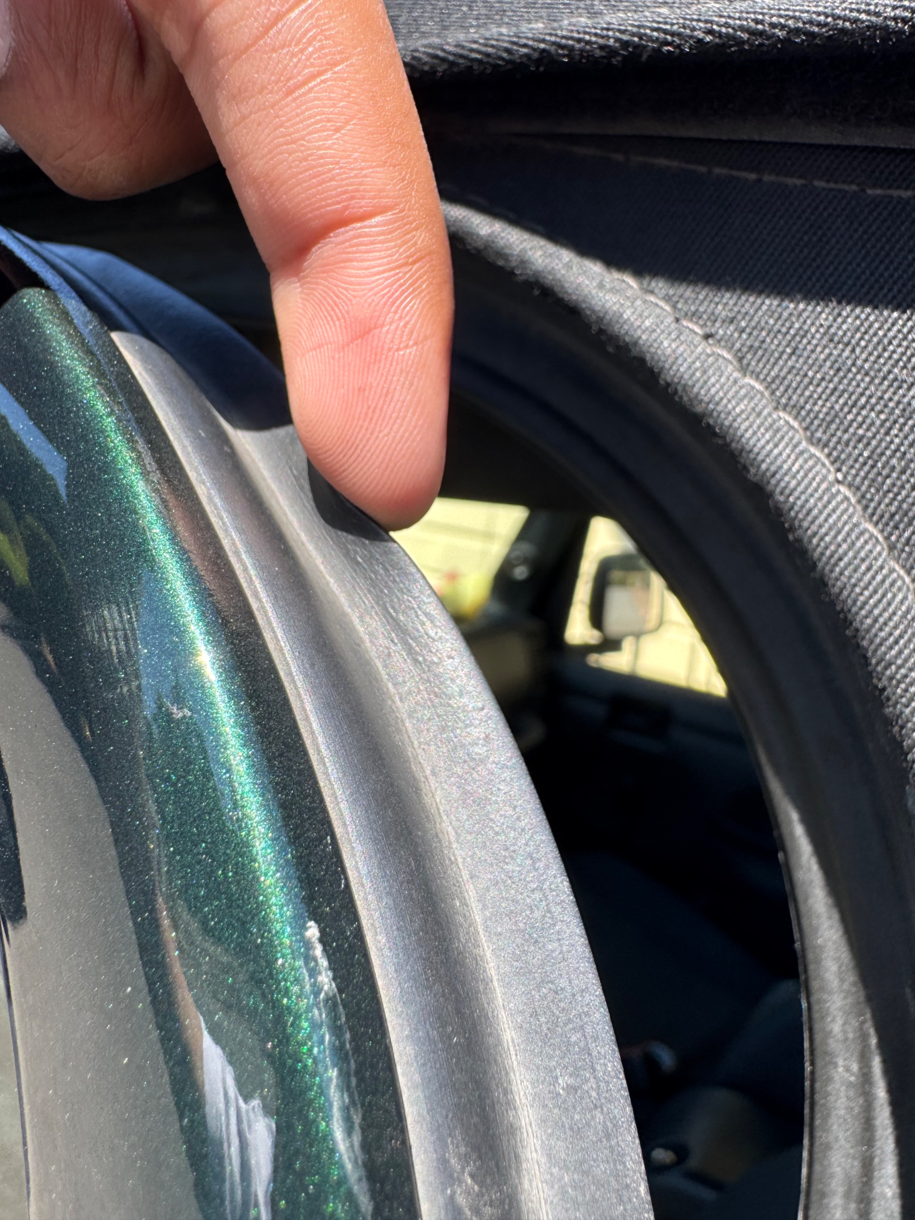

Here is one of the passenger side seals with the orange clips:
Notice how the lip is extremely shallow. Has anyone bought a full door seal in the last couple months that does NOT have the orange clips, has the inner lip, and seals at the corner?

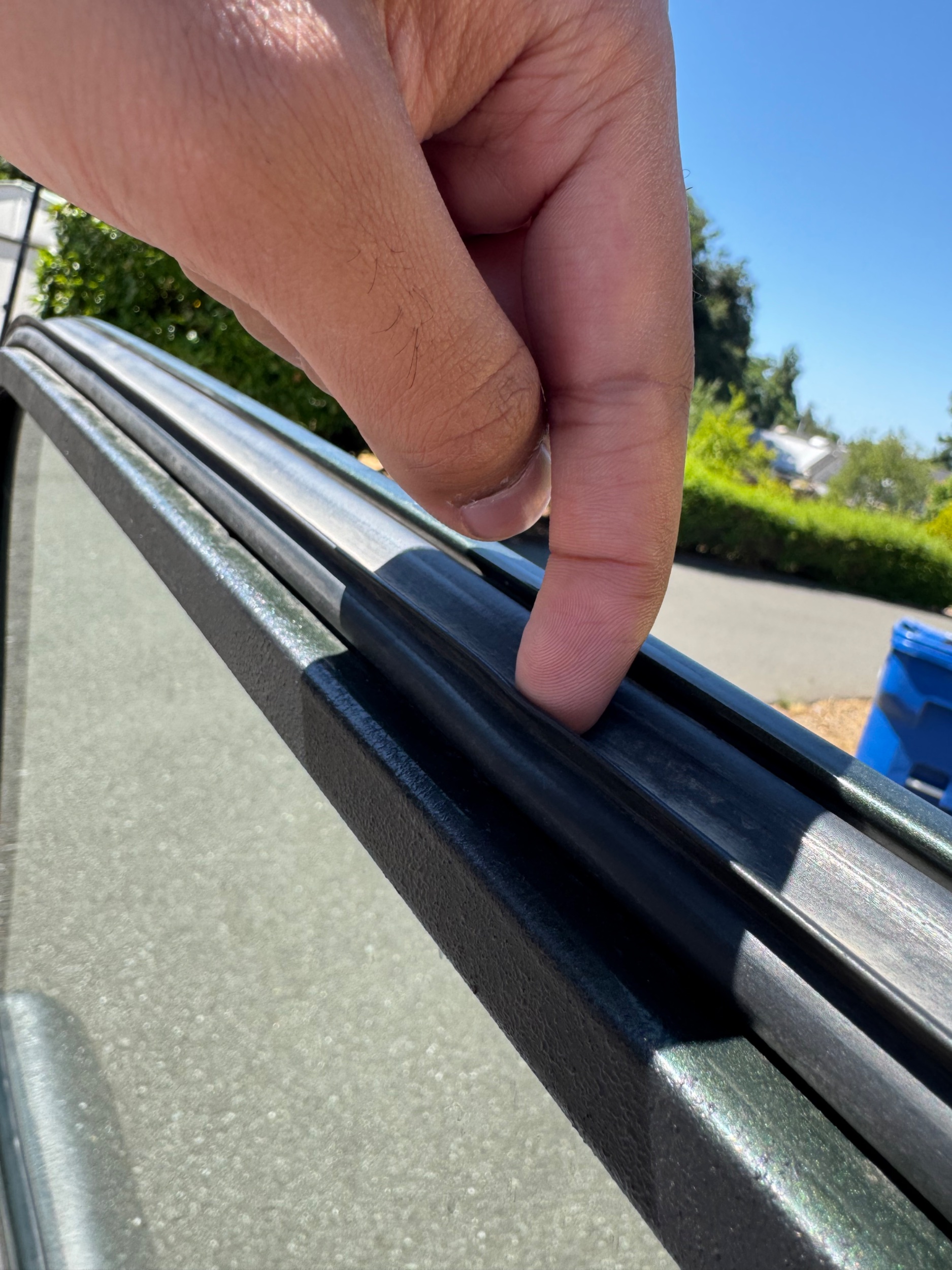

Here’s another picture of the good driver’s side seal:

I considered that but it doesn't look like it is bent. I'll look again, but I'm 99% sure it is the seal itself because of how inconsistent the results have been with each one I've tried. The one I bought from APDTY leaked the worst. I could hear it whistle at any speed at all times on the freeway. The OPR one I bought from ExtremeTerrain seems to be the best as it seals most of the time, but again it whistles when there is a 10-15 mph headwind.
I can visually see deformities in all these seals too, so I really don't think it's my door.
