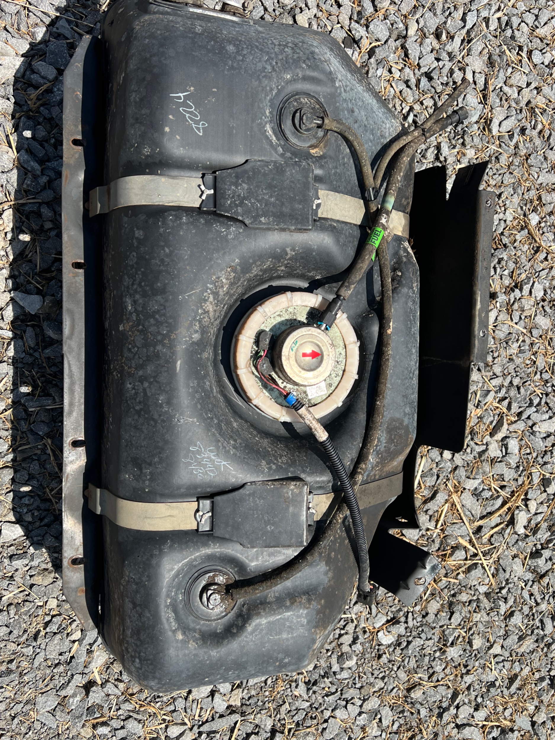

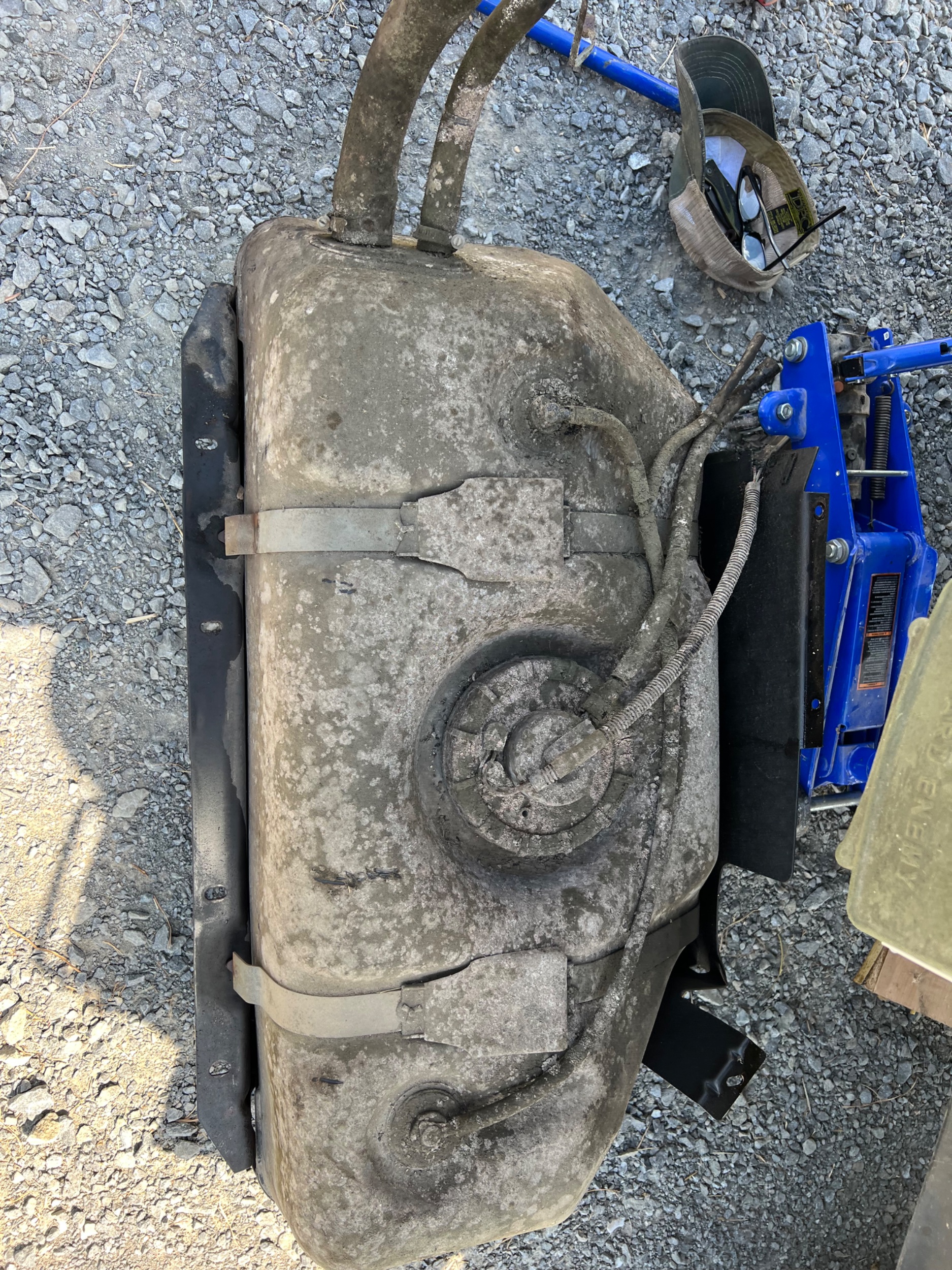

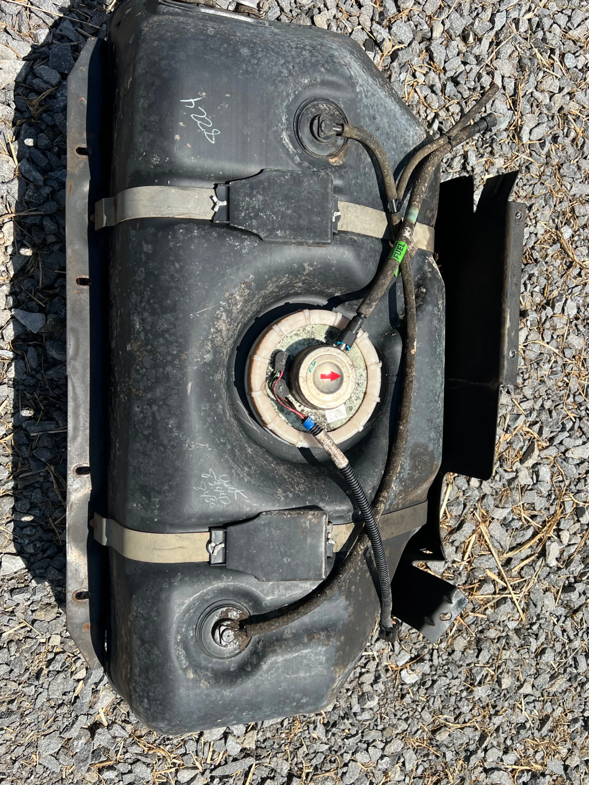

A few pics if that helps
Reactions: sfexeter
the fat 1 is a push lock fitting it should have a plastic insert, that's your pressure fuel line to the engine,
the other is a vapor/vent tube and just shoves on the hard line, it retains no pressure.

Having the right tool for the job really does make all the difference. I tried balancing the tank on a piece of wood during the removal, which I quickly realized would be a p.i.t.a. Ran out an picked up a cross beam attachment for my jack that allowed me to really be precise when lining up everything as I re-assembled. Definitely worth it IMO.
