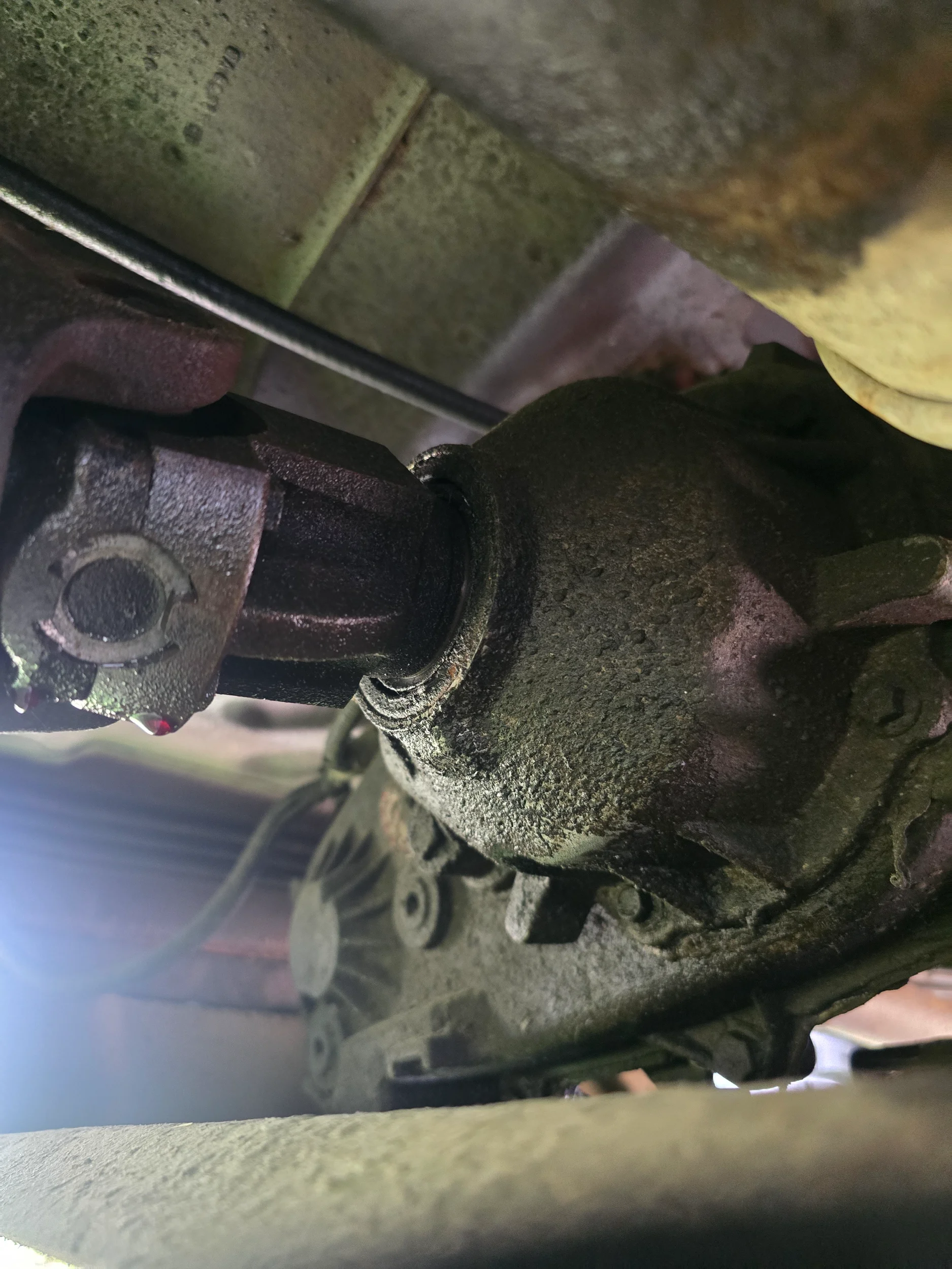

I've never owned a Jeep with one, so just to confirm, this picture shows the t-case output through a SYE?
And that's undercoating, not grease!
Plus, WHO PUTS HOLES IN A RUST FREE TJ TUB IN MASSACHUSETTS?? 🤬
Measure your springs with the weight of the jeep on them to find your lift height.yes that is an sye. Yes you can remove the skid spacers if you want to depending on lift height. You will need to change the transfercase linkage

Measure you springs with the weight of the jeep on them to find your lift height.yes that is an sye. Yes you can remove the skid spacers if you want to depending on lift height. You will need to change the transfercase linkage
