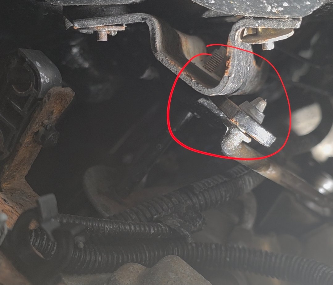

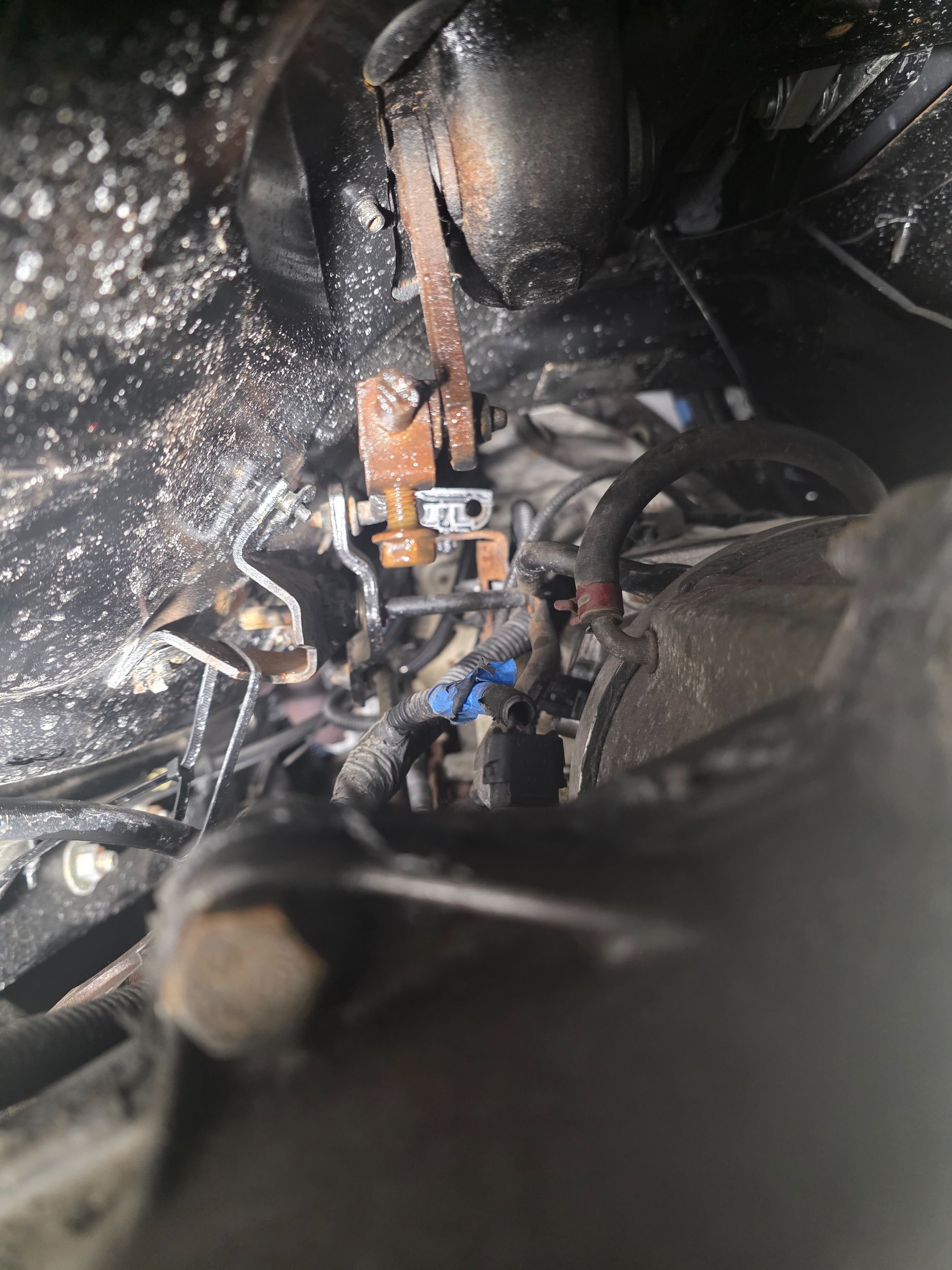

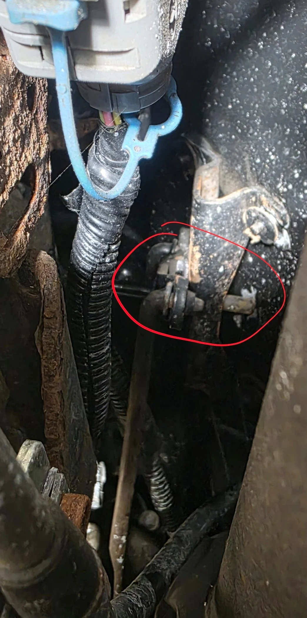

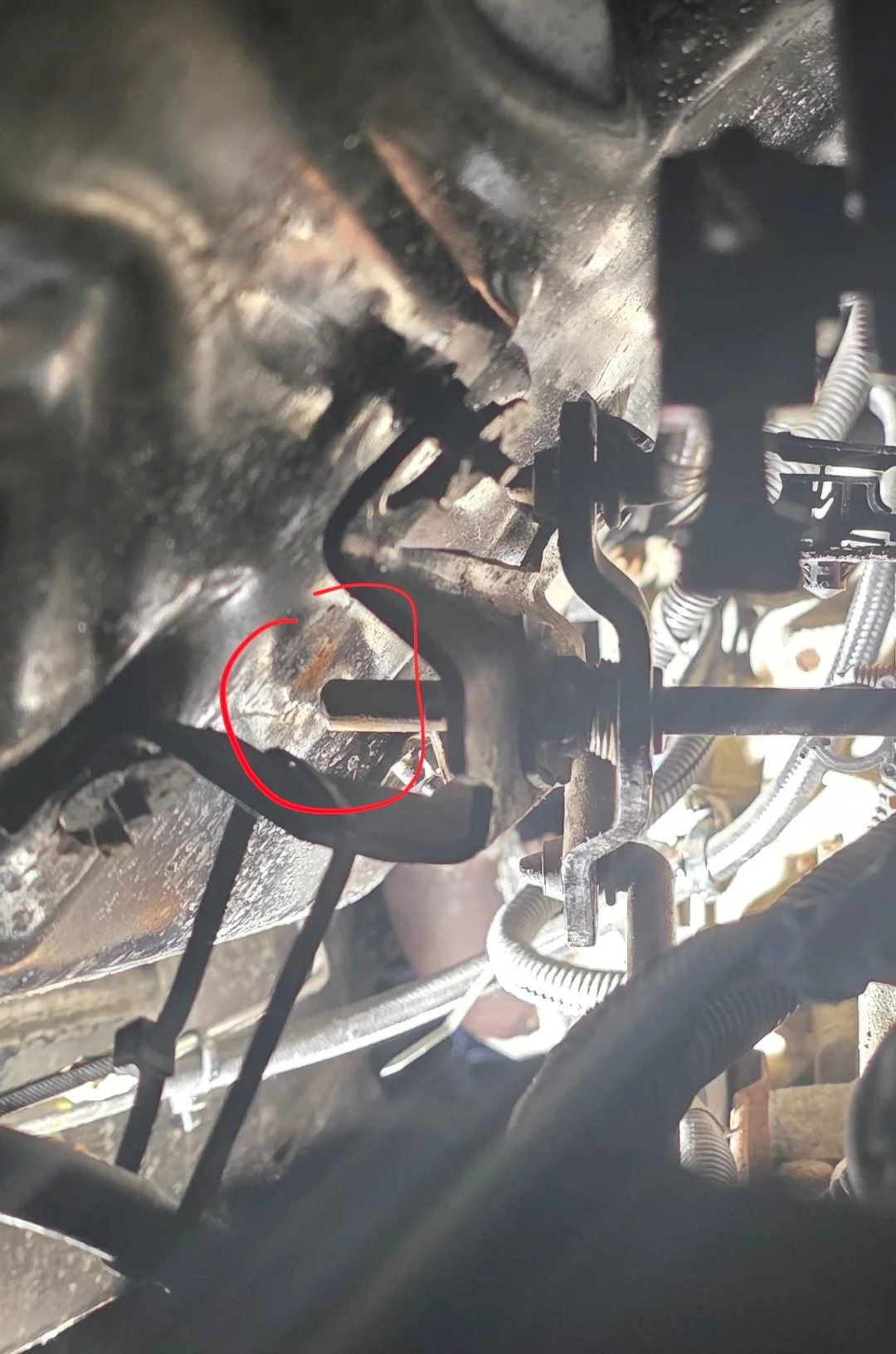

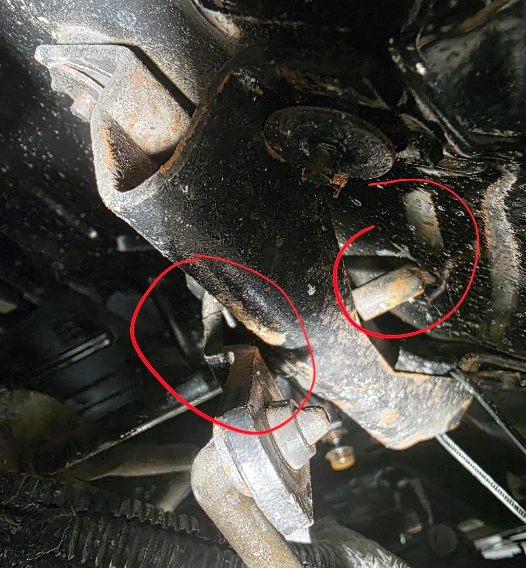

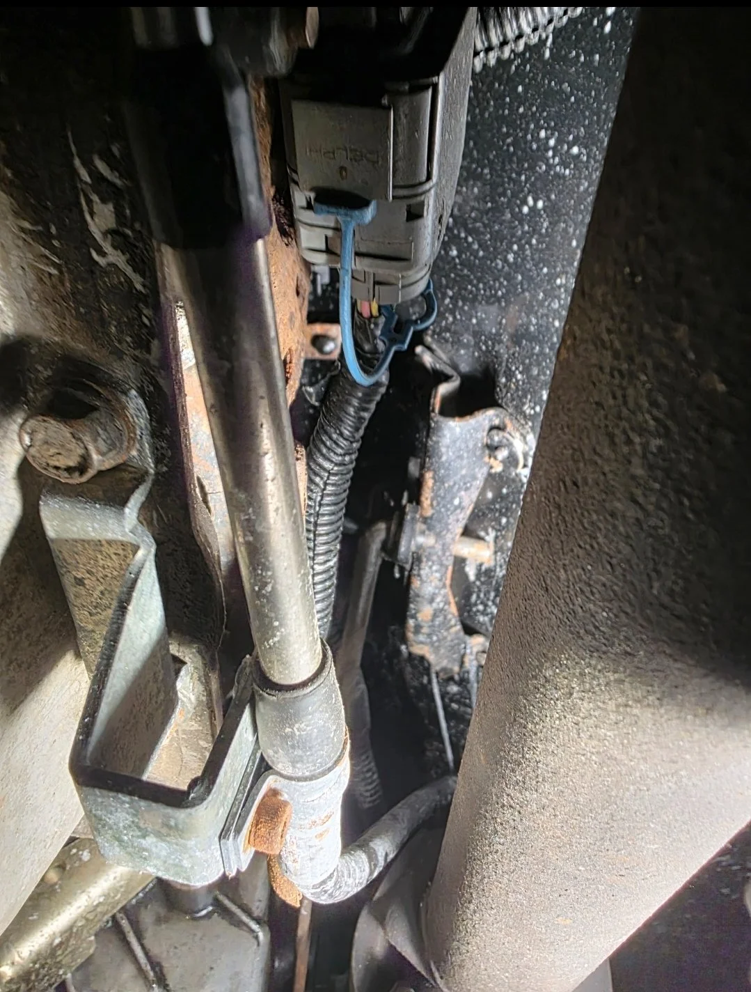

I went under the jeep to inspect the shifter and it doesn't look right. It does get stuck on the tub when I shift. I cant even get it to go in 4Low as it won't move past 4 high. See images, look like something is missing.
This might be helpful.
I'd disconnect your linkage and shift the transfer case with the lever on the side of the case...test function and then either replace with a Savvy cable shifter or repair your linkage.
