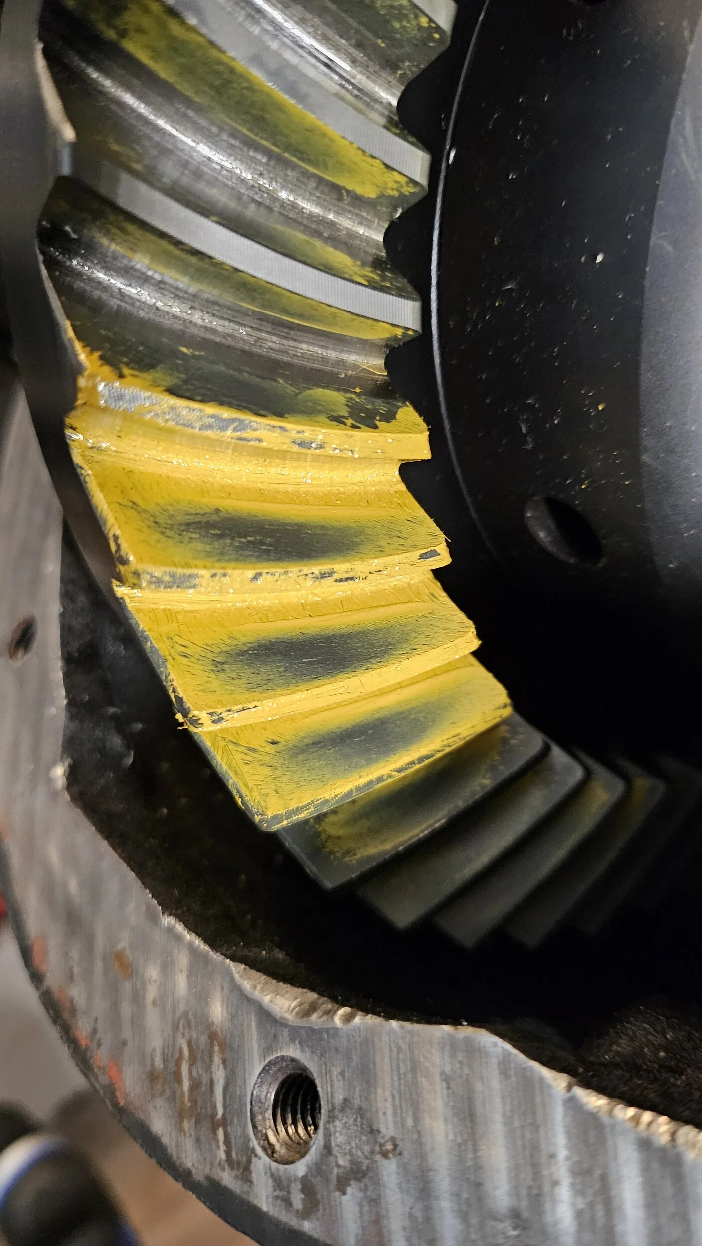

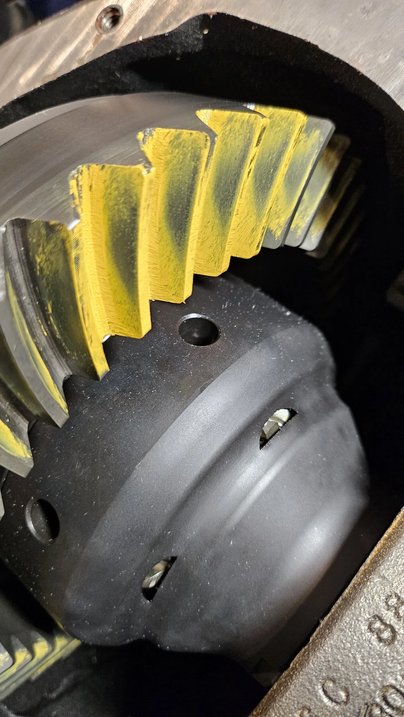

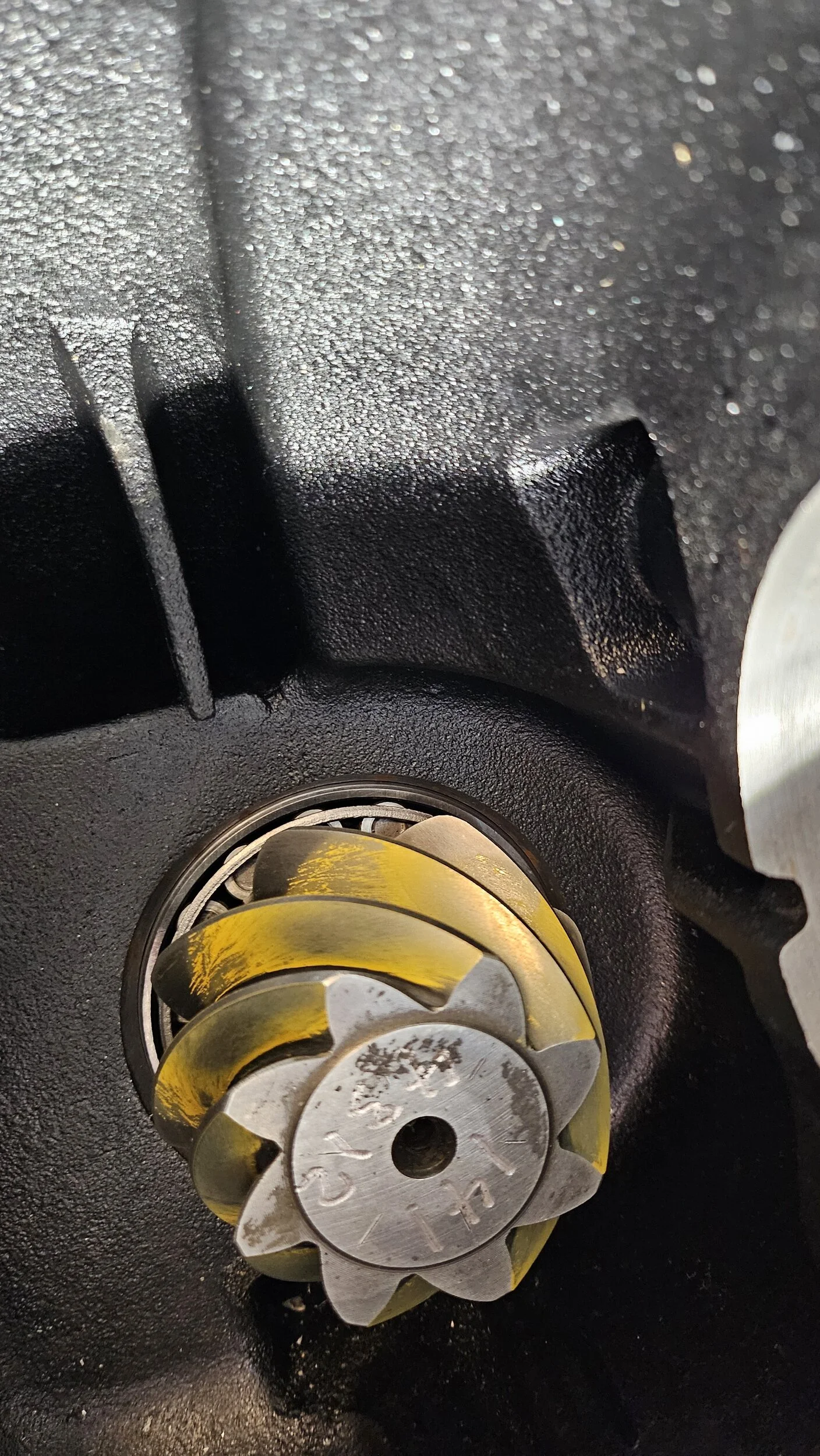

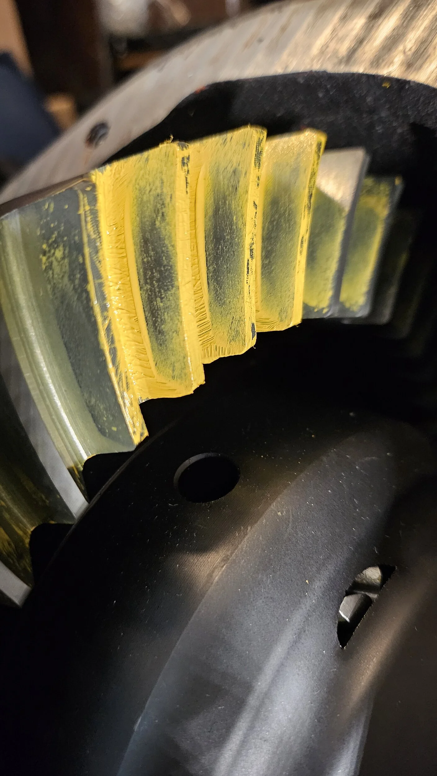

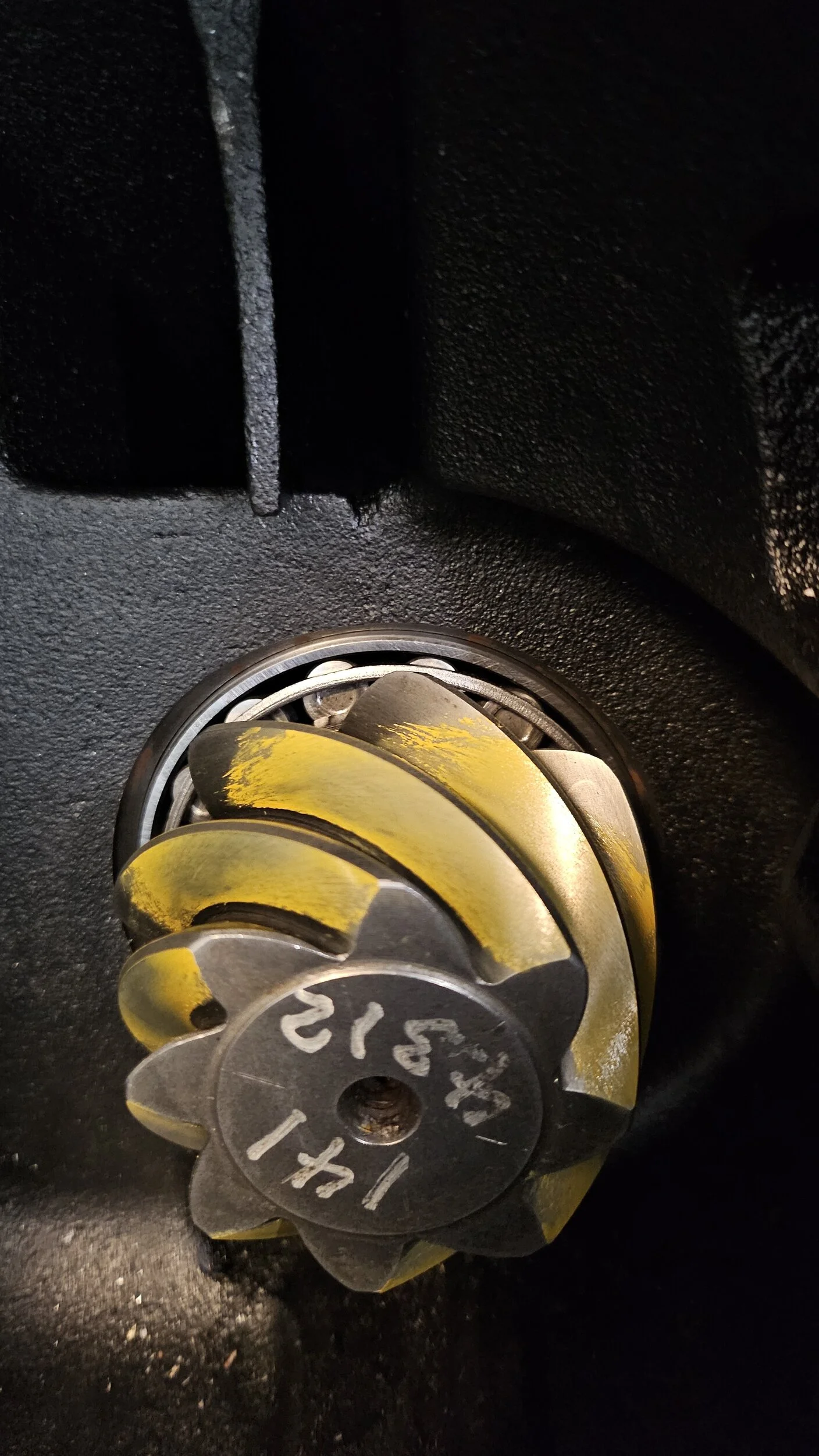

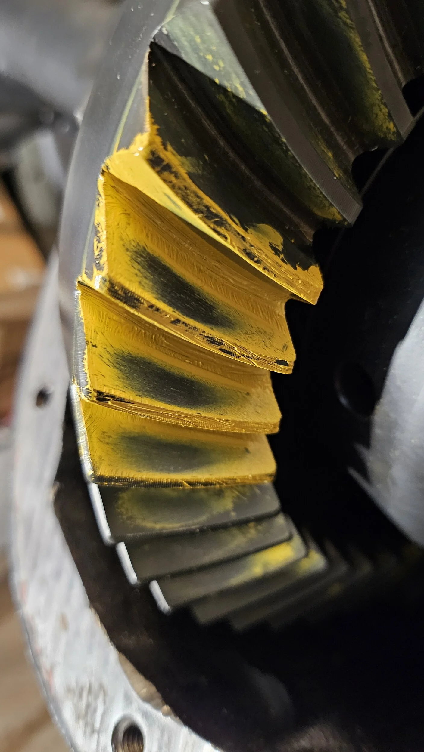

Working on setting up my rear Dana 44. I think I have a runnable pattern but would like some opinions. The pattern I currently have seems like it could be a hair deep. I tried removing 2 thousands, which was the best I could do with my shim selection and it looked a bit shallow. The first 3 pic are with the pinion shims at .053 with and a backlash of 8.
The second 3 are with .055 and backlash of 7.
Thanks!
