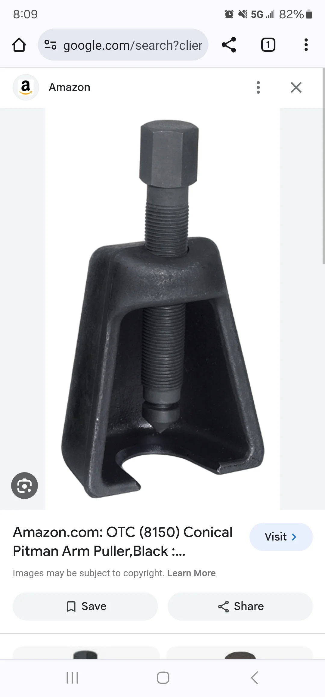

This is the puller. Okay, thanks! I got a pump the other day too so that should help with the power steering fluid. I think I'll antiseize and get it to 150 and get a little more with a breaker bar then have the mechanic finish it up when he does my alignment

Just fyi that puller may give you trouble. The problem with them is the legs spread and slip off the pitman arm. I only use the clamshell type puller as pictured.
One thing that will help with either puller. Get it tight and smack the hex with a BFH. Then smack the arm itself. Then tighten puller more. Then repeat.
You can use well placed heat but be cautious of seals in the gear box.
Pman beat me to it. If you have problems with that puller, either try to return it (if you haven't destroyed it already), or throw it in the trash where it belongs and get the OTC 8150. Blaine likes to call the aluminum one a "pitman arm annoyer," which I think is well described.
I personally use an impact on the OTC and it zips arms right off, but if you don't have an impact then getting it real tight and hammering on the arm from above with an extension or similar will work.

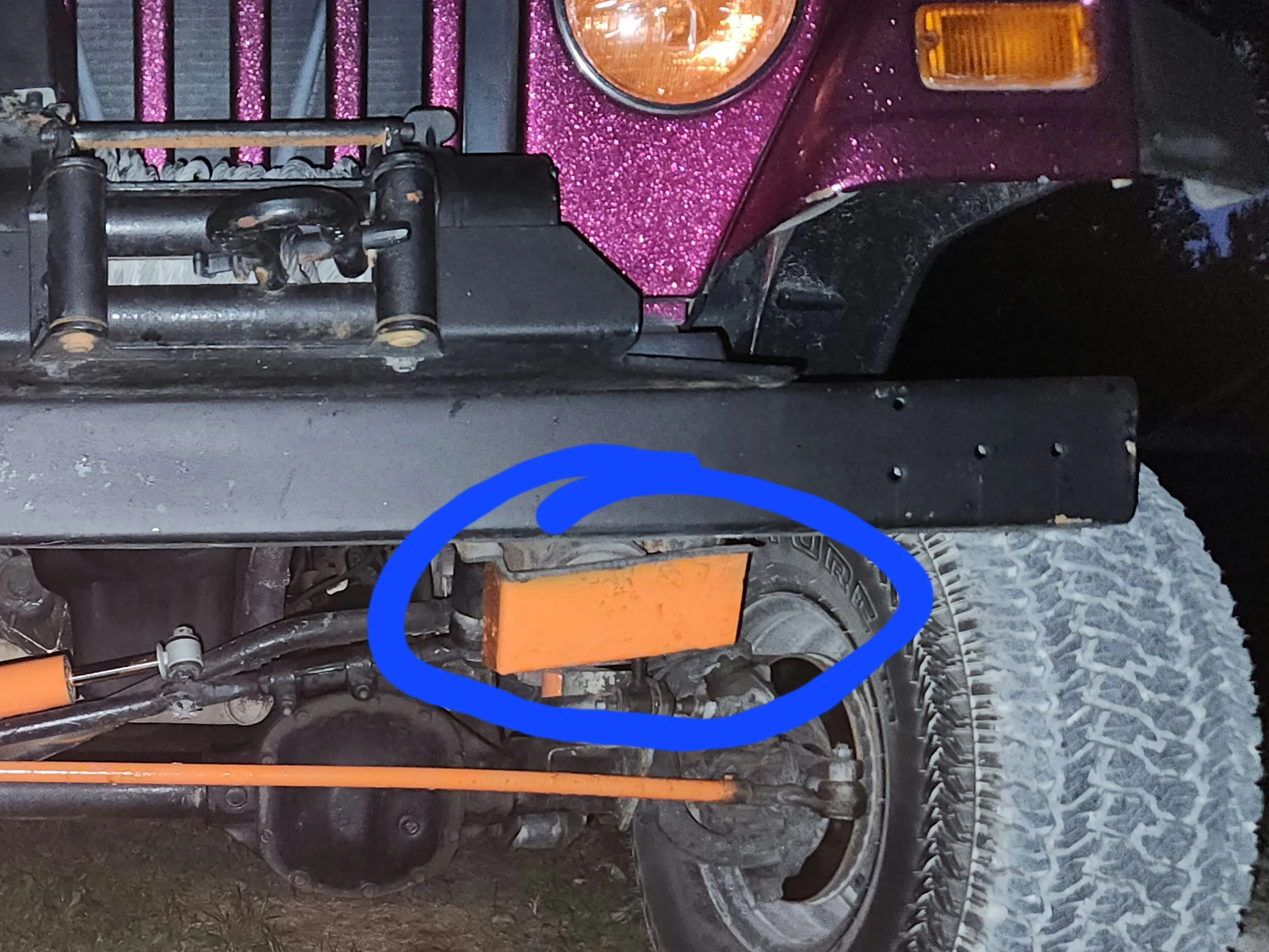

This thing. There's a small bolt on the bottom of it. I might be able to get a little wrench in to grab the nut above or possibly needle nose if they can grip it well enough.
Reactions: machoheadgames
That's a "skid plate" for the steering box. Depending on how it's mounted there can 4 bolts. 2 through the bumper and 2 that go into the steering box.

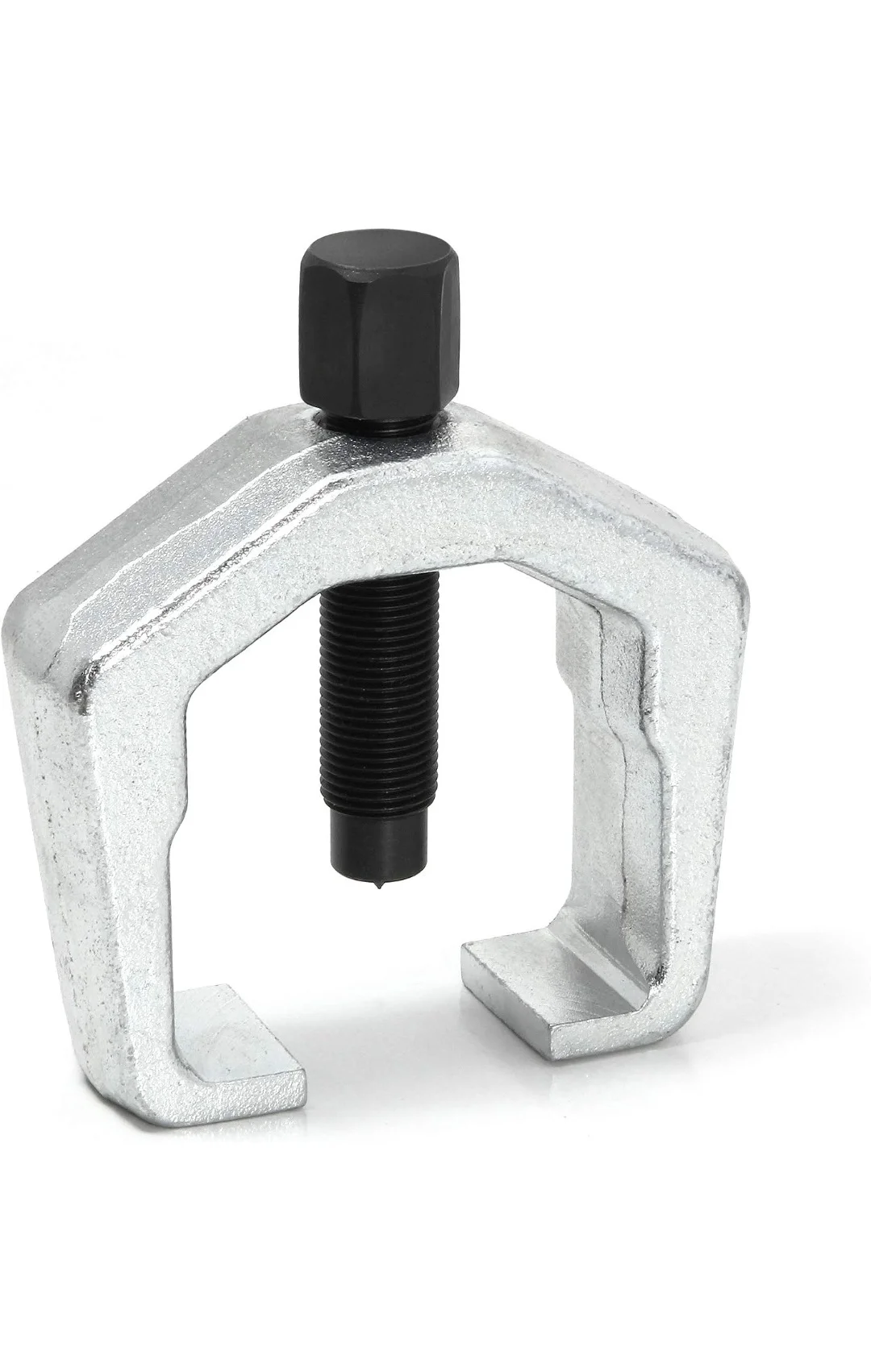

Never tried that conical one but I've had good luck with this one (loaned for free from AutoZone) when the annoyer spread and popped off.

The bolts keep the jaws from spreading.
