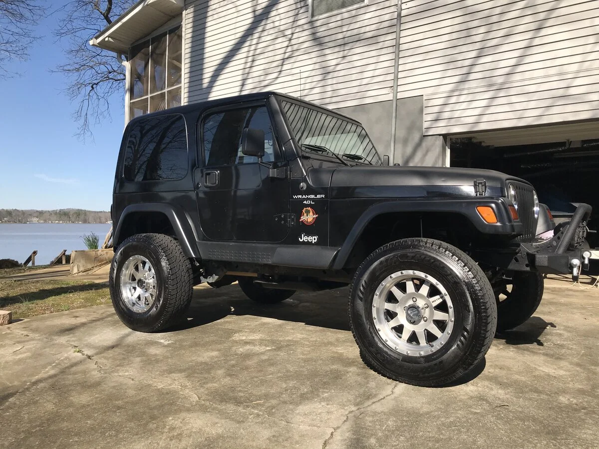

first bought it

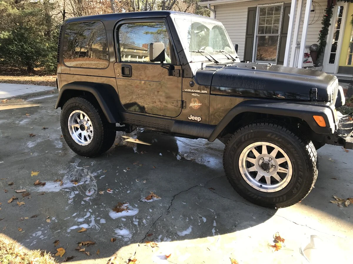

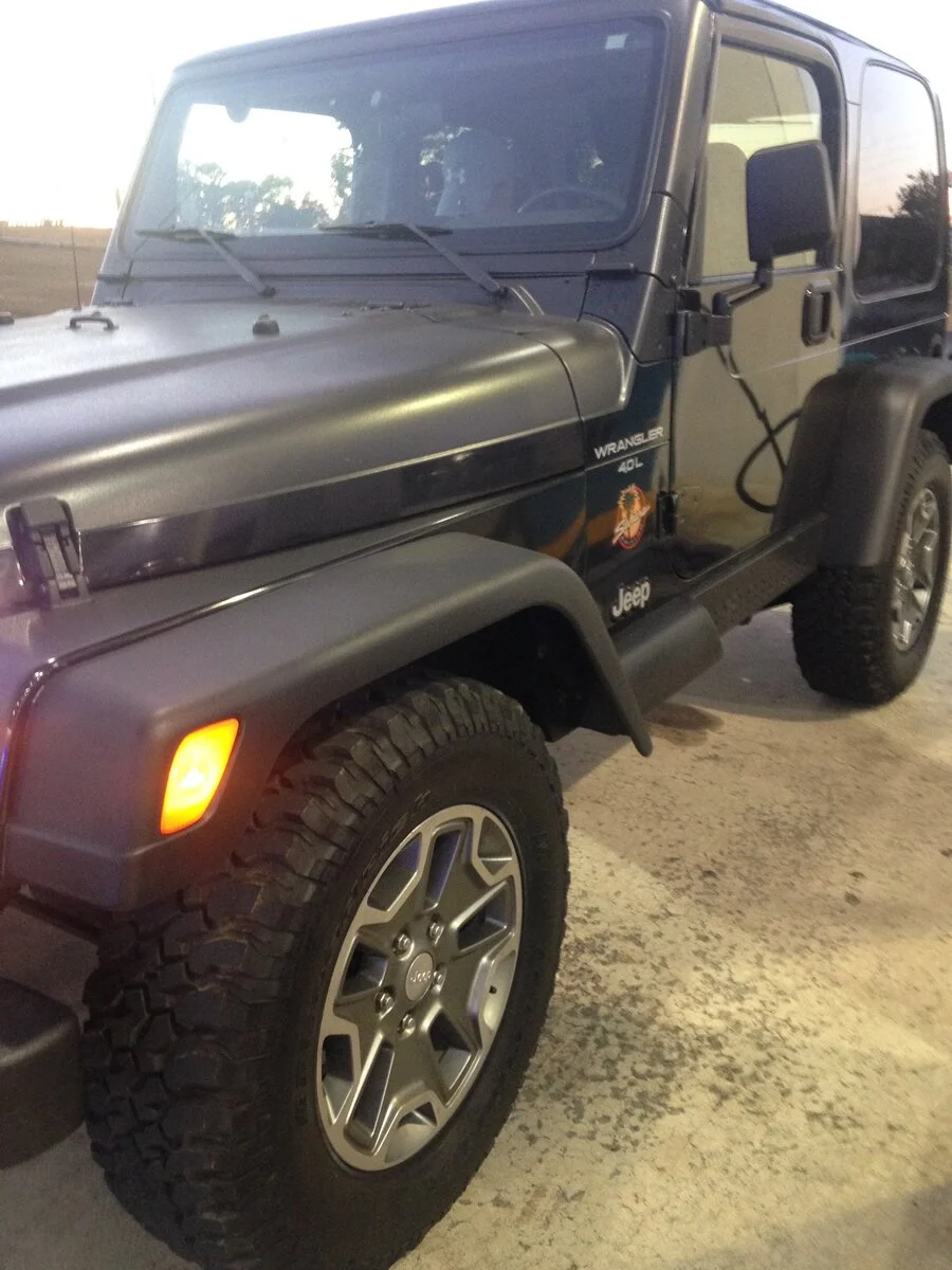

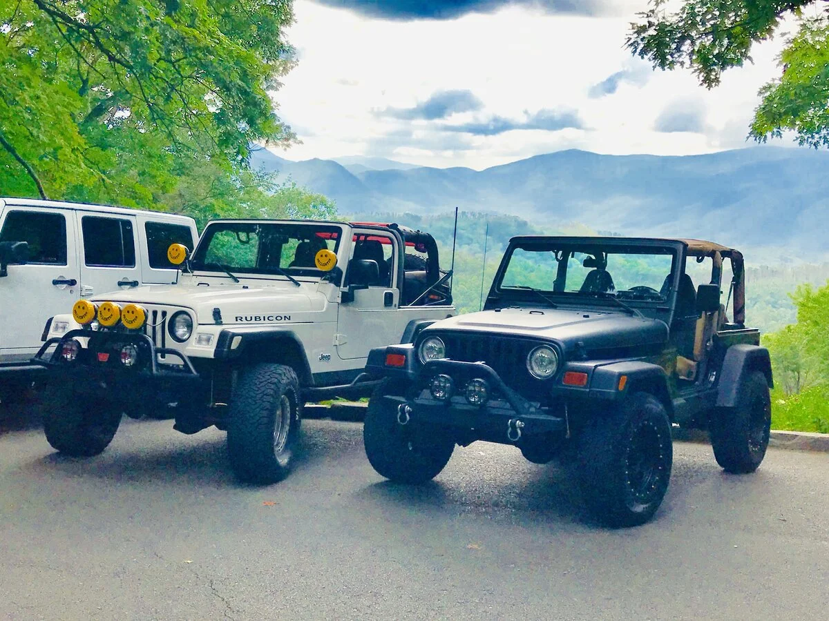

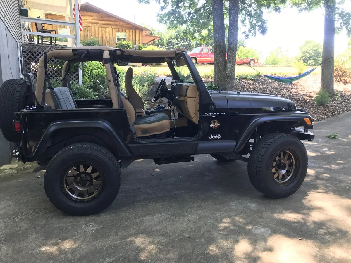

View attachment 161192View attachment 161193View attachment 161194View attachment 161195
2nd is with @AndyG
3rd is stripped wheels
4th is lifted
5th is bronzed wheels and smaller flares

That is awesome bother! Well done mods that look great. It’s amazing how much better it looks with the smaller flares.I didn’t do very good job of logging stuff, or taking pics.. it just kind of happens and poof, she looks different.. @DrDmoney and @Alex01 talked me Into some Frenched (not sure what you call them) taillights that I have to cut a hole in the tail end, but I’ve seen y’all’s build threads and mine would have a lot more cussing and slinging wrenches then cool and detailed pics.. I’ll post a couple here though

Yes thank you.. I liked the flares they were the 6.25” ones but I am much happier with the smaller onesThat is awesome bother! Well done mods that look great. It’s amazing how much better it looks with the smaller flares.
