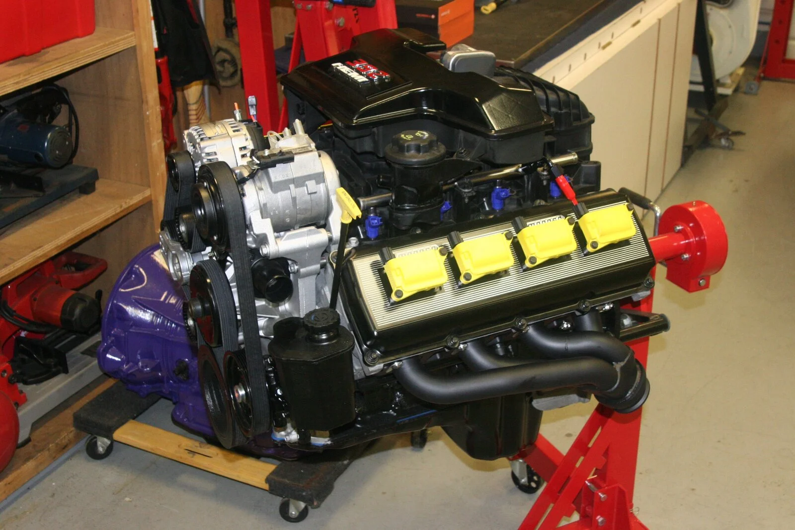

A stroker or maybe even a built Apache swap is very possible in the future. For now, I’m going to start with the 5.7/65RFE, some SRT manifolds, and a good tune and see how happy I am with ~400hp/425tq first.
I may be pinging you for some info if you don’t mind. For starters, what ECM did you use??

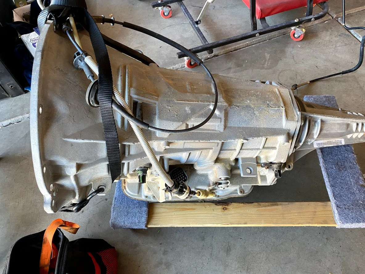

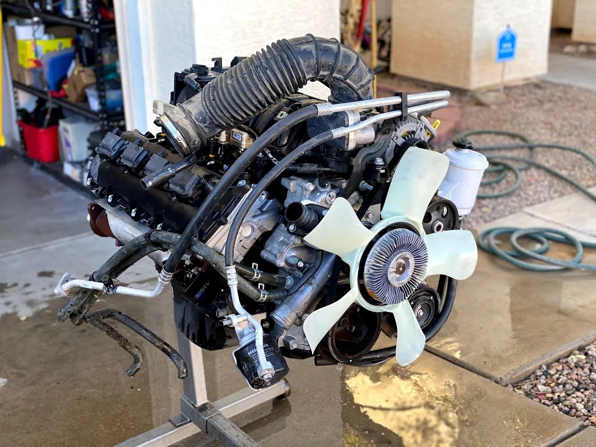

The engine and trans is out of an ‘06 Ram, but I had to use the ‘05 PCM to be consistent with the rest of the system.
Before the Hemi I ran a supercharged I6 that put out 400 on the torque side (300hp), so I did not want to do all that work for a stockish 5.7 for such a small jump in power. I’m well into the 500’s in HP and torque.

My RamCharger is ~500hp/575tq and it honestly makes me hate driving anything else in the house. Even the wife's 3.6L/8-speed Grand Cherokee feels like an absolute dog when driving it shortly after driving the RC around. I hope I'm happy with the 5.7/65RFE for at least a short while.
How's your 545 holding up? I have seen a handful of reports that it's not great at holding power. People have said this about the 46RE/RH too, but mine is holding up well to the stroker Magnum (after a $2600 rebuild at least lol).

No problems spinning 37"s :) Truthfully, I can totally see me Hemi-swapping the RC in the future and using the stroker for something else. I've always wanted to do a LRE (Lil' Red Express) build - either a true restoration or replica.
I'm basing my stroker numbers off of two documented builds with near identical build specs (one coming out of the "How to build Big Inch Mopar Small Blocks"), real world numbers from a handful of dyno'ed crate motors, and from talking to Marty Fletcher some time ago. I'm just wrapping up my OBD-II conversion (hope to be done this week!) and should have it ready for fuel-sync and double-checked next week.

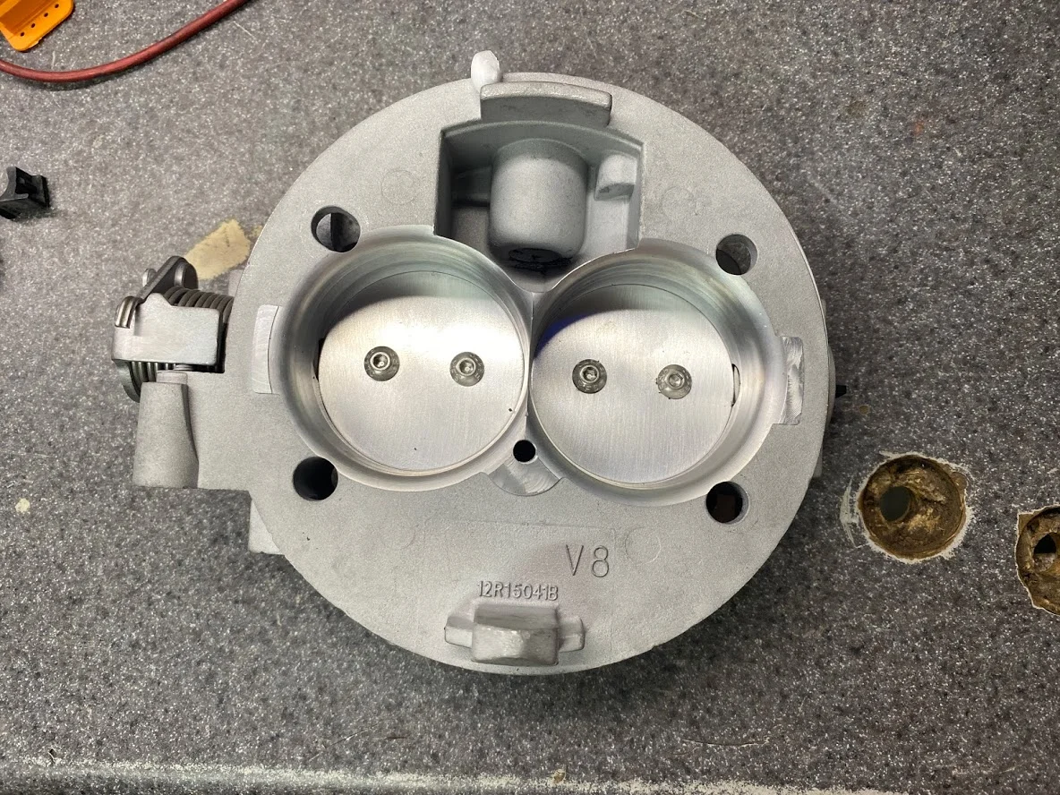

My 53mm TB arrived last Friday, so I need to reassemble that and get it back on. Once running, I'll follow that up with a few more miles on the road, throw in an oil and trans-fluid change (the trans is new as well). and then get my base tunes loaded up. I hope to hit up the dyno mid-March!

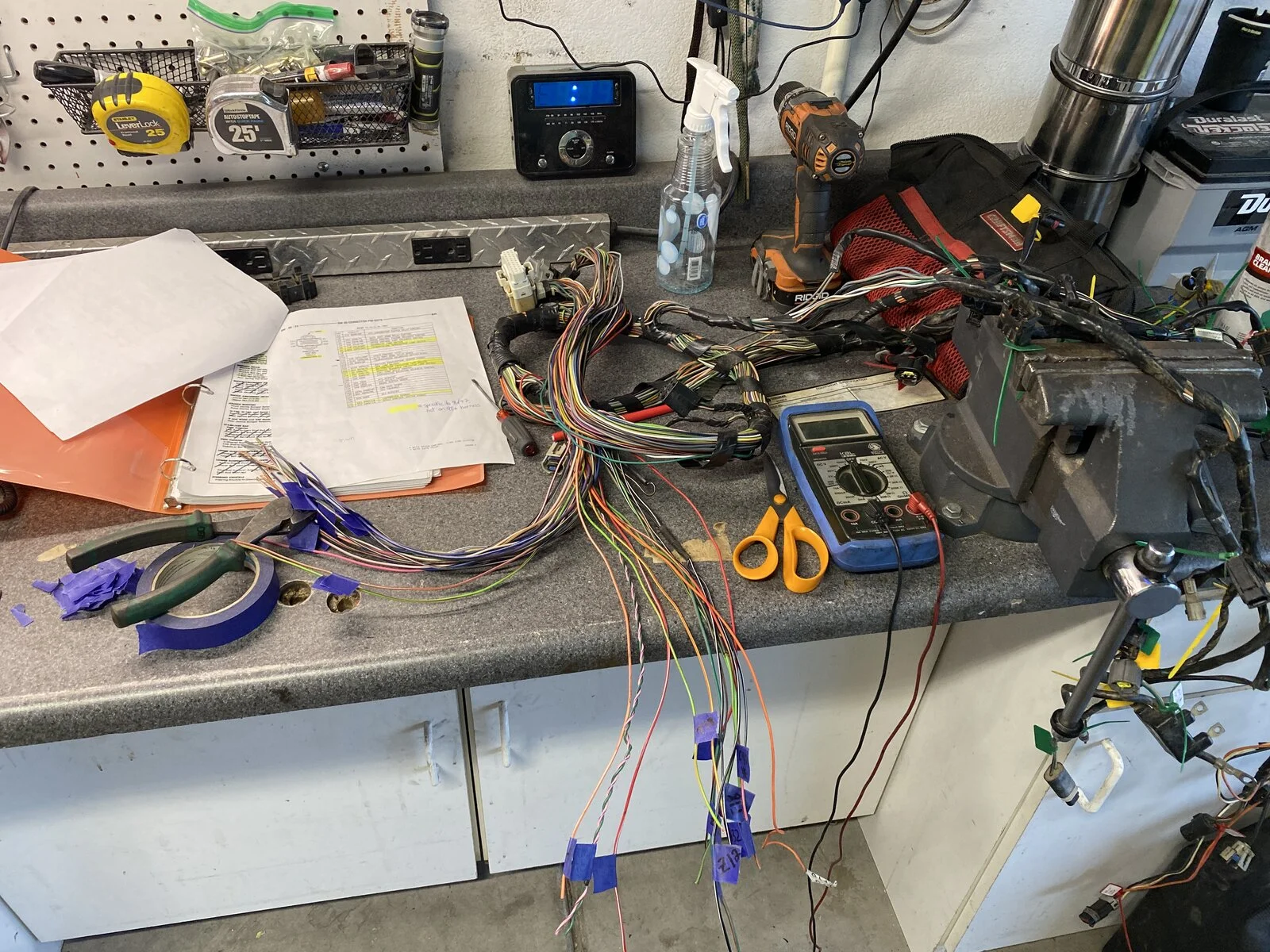

The OBD-II conversion is quite easy and I'm using another HGM Compushift Mini A518 for the trans controls on the 46RH. Since I used the HGM in the past, I knew what it needed, so I made specific TPS and VSS signal leads just for it. I'm also taking the opportunity to update some of the wiring on the RamCharger at the same time - namely getting rid of the spaghetti fusible links and fender-mounted relays (I have used a 94-96 Ram Fuse box/PDC in the past and it has worked very well). I'm also upgrading the thin 16 AWG headlamp wiring to 14AWG on 2-separate relays (which I moved inside the Ram PDC for a factory-installed look).

In 2006, Dodge went to the CAN-BUS system, which is not compatible with the 2004 Jeep cluster. The 2005 Dodge ECU works with the ‘01 to ‘06 Jeep cluster. Although Chris at Hot Wire did my wiring conversion, I know that he had to reconfigure the ‘06 Dodge harness to ‘05 specs. Again, so it would work with the ‘04 cluster and play nice with the rest of the harness. I could have gone with a custom cluster, but this route was easier and kept the stock look on the dash.
I had the 545 built by ATS. Purple power. They did their stage 4 build which is rated to 700 ponies. I’m really happy with how it came out - very quick shifts which are buttery smooth. Night and day improvement over the old 42RLE - even though ATS built that tranny for me as well.

Good to hear about your trans good fortunes. I had a local company rebuild my 46RH for use behind my stroker to the same power levels and it's been buttery smooth and reliable as well. They specialize in Dodge transmissions (mostly diesel stuff) but have a very knowledgable Dodge specialist that has likely forgotten more about the differences in Mopar transmissions than I ever knew.
