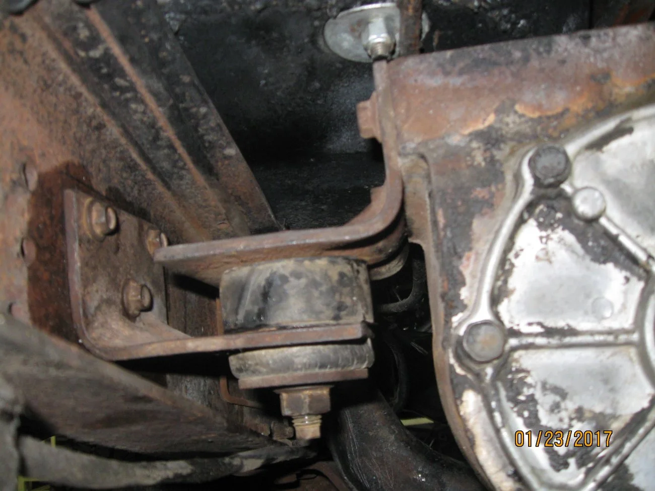

I think the non racers would be better served by something akin to the 70s Ford tcase mount. A large bushing like a body mount mounted on the front output side to take up some of the weight and control torque roll.
