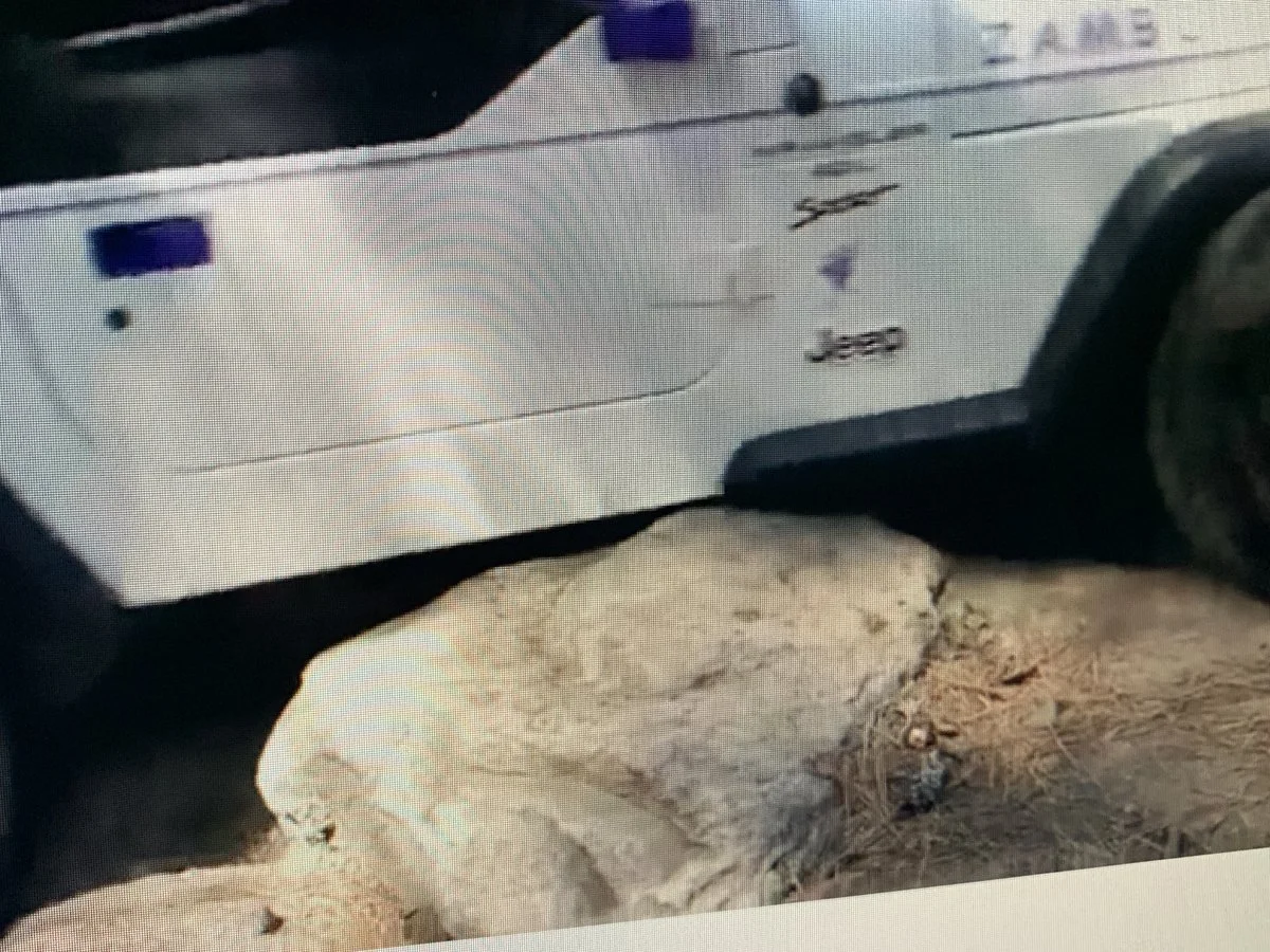

And this right here shows why I decided I needed a lift. :D

you need sliders!
Those are going to be in the works too. I will probably get those before the springs. I want hubby to weld me some square tubing to go right under that area. May have to have him add a step to my design. LOL

The BL will clear that rock nicely. Sliders are invaluable off-road :)
Yah, I was actually wanting that shortly after starting off on that trail. :D I added a bad drawing to show what I kind of want for a slider, to my above post. :D
One thing to remember - a frame mounted slider is more prone to damaging the tub by shoving up into it and bending. All depends on how hard you hit it. A tub mounted slider provides significantly more protection and will not lose you any precious ground clearance over rocks. If you add the body lift (1.25”) then add a slider below the tub (maybe 1-2”) then you’re back to square one and rubbing instead of clearing.
