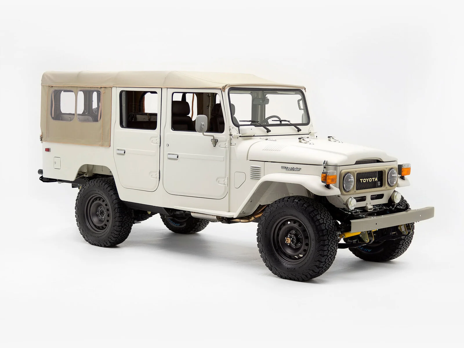

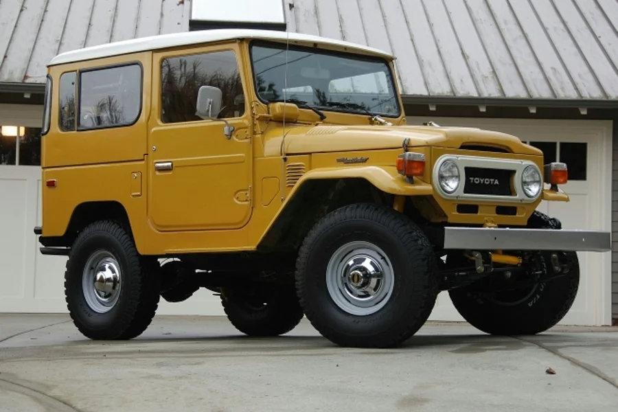

Sorry folks but the LJ looks like a Landcruiser copy whereas the Landcruiser was a Jeep copy, sort of admitting defeat lol
