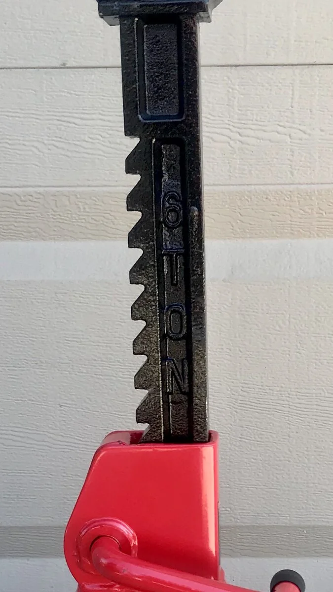

I was going to return my HF 6-ton jack stands that have lost their labels, but I have owned them since 2013, about the same time as the beginning of the production run of the recalled units rather than toward the end, so odds are that mine do not suffer from the results of aged tooling and there is at least a 50/50 chance mine were manufactured by a different company than the recalled units. The teeth on mine look fine so I've decided to keep them.

Here's a thought: would it be possible to just drill a hole through this piece of junk to turn it into a pin-type stand? How much distance between holes in the arm to have enough bearing material?
