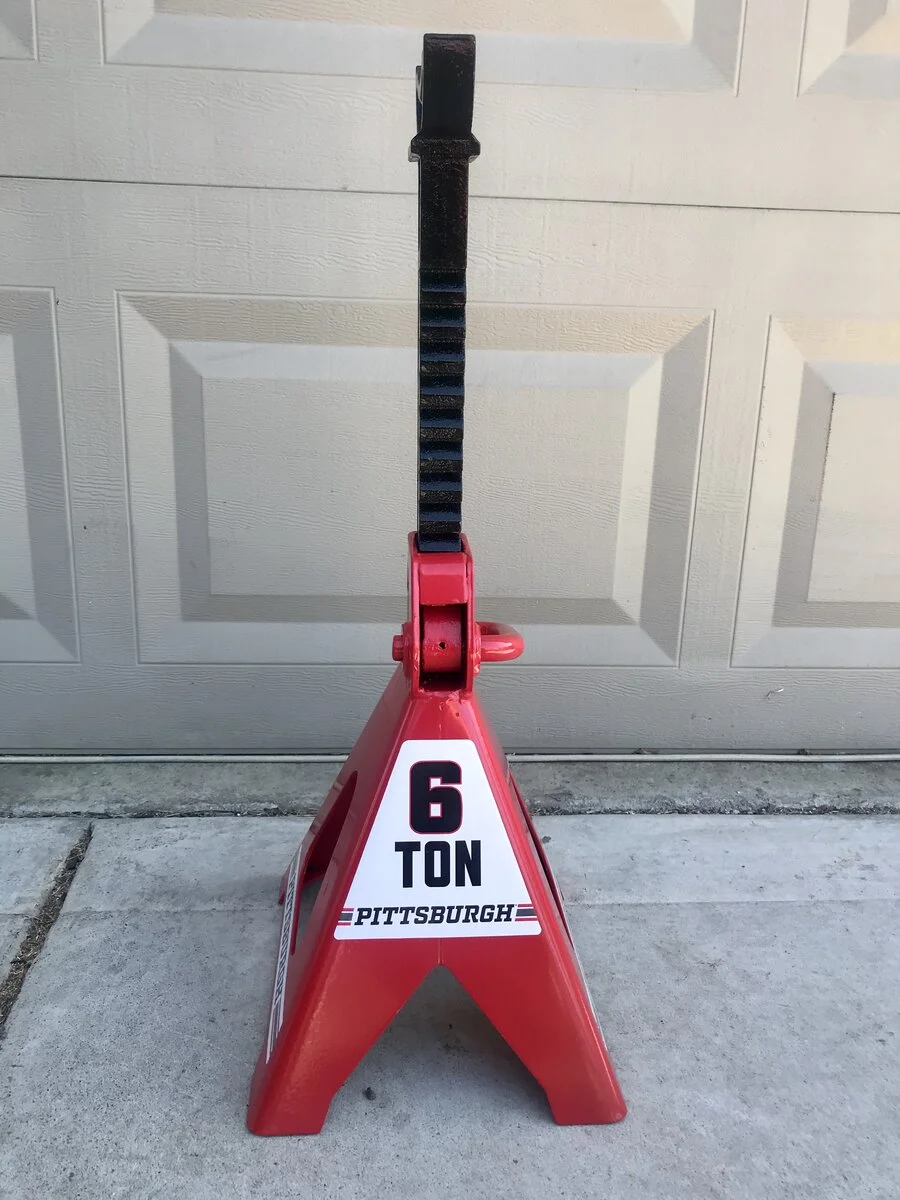

Unfortunately, I can't find part numbers stamped into my HF 6 ton jack stands and the labels are long gone. I don't know whether I have good ones or defects.

Harbor Freight Tools (“HFT”) has decided that a defect which relates to motor vehicle safety may exist in certain Pittsburgh Automotive 3 Ton Heavy Duty Steel Jack Stands (models 61196 or 56371) and 6 Ton Heavy Duty Steel Jack Stands (model 61197). Our records reflect that you purchased at least one of these pairs of Jack Stands.
What is the Condition?
For certain units of the Pittsburgh Automotive 3 Ton and 6 Ton Heavy Duty Steel Jack Stands there is a potential, while under load and with a shift in weight, for the pawl to disengage from the extension lifting post, allowing the stand to drop suddenly. This condition could cause serious injury for people near or under a lifted vehicle, and/or damage to property. As a precautionary measure, we request that you discontinue use of the jack stand(s) identified below immediately.
