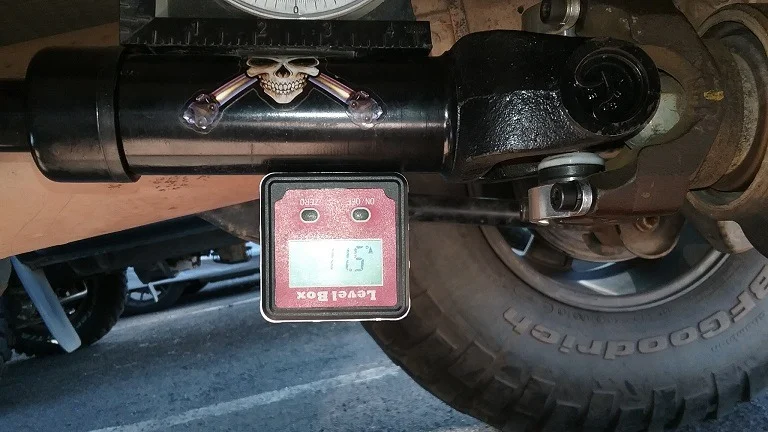

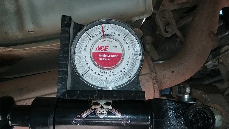

I assume i would have to adjust the pinion angle also.
Maybe. I'd wait till after you lower it and them measure the pinion. Get a good digital angle finder. This is what I use,
One of these will work too,
I have one of those, the non digital type. Good advice. I’m thinking the drive shaft may become one of the bigger issues.

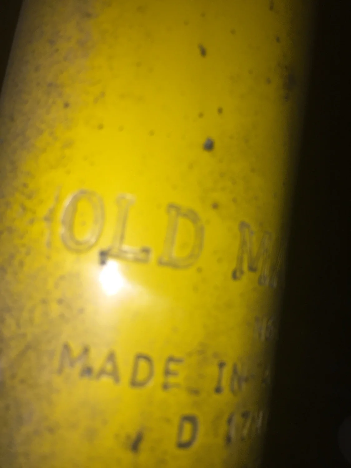

Can't quite tell from the pic, but it looks like the shock might have the part # stamped "N??" Curious to know what length shocks are on there. Also, they look like maybe 1st gen Nitros.

Alright Larry, play detective with me. Just below the "Old Man EMU" stamped on your shock is a "N??" part number. ie, N66, N67, N66L. Let's get that number.

I will see what I can do. It’s not easy to get my phone in there.
