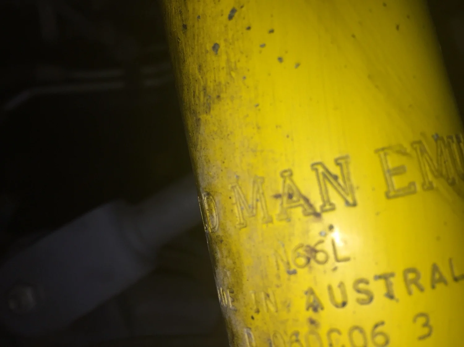

a pic of the part# on the front shock will work too. Which ever is easier to get at.
No need to take a pic of it, just find out what it is and report back.

N66L. That's a long travel front shock. My front shocks were "N66". The "L" stands for long travel, but that shock isn't on ARB's spec sheet anymore, so I don't know what the collapsed/extended length of the shock is. I'm speculating here, but OME's N66L may or may not have the correct length for your current setup. A call to ARB may be needed to find out the spec on that shock. Of course, if you plan on replacing the shocks, I guess it doesn't really matter much.

Made a call to ARB tech. Those shocks are 3" longer than a shock for a 2.5" lift, so they seem right for the current lift. If you drop it, you'll need new shocks, fyi.
You are going above and beyond! I expected to have to buy new shocks after the drop. What you have helped me learn is that I probably won’t need to buy a whole kit. [emoji106][emoji106]
