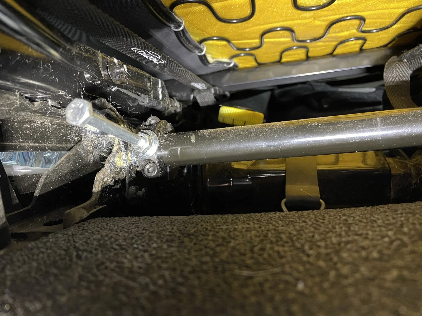

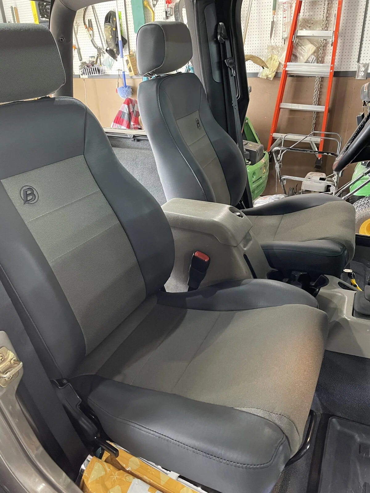

These are the seats I got. Getting the three seats redone locally was going to cost me $1500, these cost $800. They are firm and sit great. The flip and fold part works on mine because I drilled and tapped a 7/8" collar and put a 4", 1/4' -20 bolt in the collar. The bar that is usually operated by the cable assembly is 7/8' diameter which the collar fits on and lets you reach easily under the seat and release the flip and fold. Ill see if I can get a pic for a better explanation.
