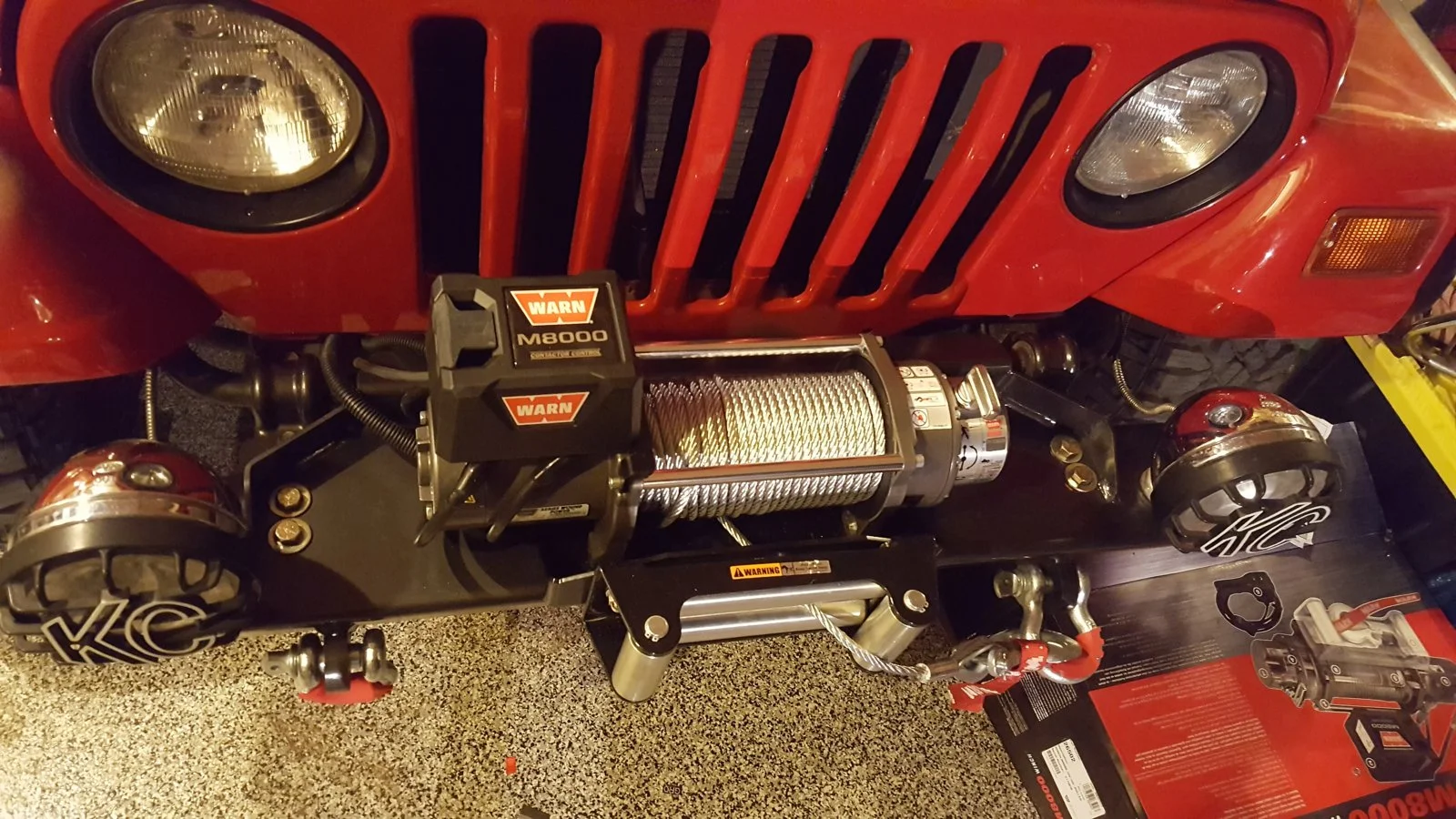

Stripping the powder coat was a PITA, @bobthetj03 suggested using a flap disk which I wish I would have, but I did it over Thanksgiving weekend, and Home Depot was closed, and there was nowhere I could get one, so I went to my local Auto parts store and bought airplane paint stripper, and scraped and scraped and scraped. Then I did as @Jerry Bransford said earlier. I sanded it smoothish and covered it with about 3 coats of etching primer and 3 coats of hammered black. (Rustoleum) I already had the paint because that is the exact same thing I did with the Dirtworx rear bumper.

In the end and the point of this thread is it turned out perfect, and I will always paint my bumpers from now on. In fact I will not order bumpers that come powder coated.
Honestly between you and me and whomever else reads this. I honestly believe that it looks way better painted than it did powder coated. and I am not just saying that because the powder coat was shit. It was only shit on half of the bumper. Don't get me wrong had the PC been good, I would have left it, but the paint looks so much better, and it matches my back bumper.
