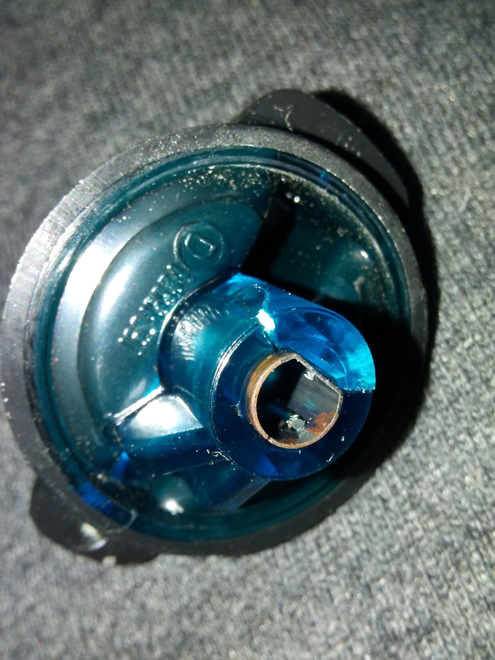

Right so this is what is happening with the replacement one. ( the small cog bottom is attached to some kind of position sensor and seams flimsy and i guess isn’t stopping the drive at the right place ), the original has 2 copper tanks which run on a track and is how it stops the drive ( these are obviously knackered).
So replacement was cheap Chinese shit i guess.
Still can’t fathom why it jitters though ( unless the position sensor is just rubbish.

Ok trying this as a gif, you can see in the 2nd video , i remove the middle cog ( so isolating the drive sensor cog) and it all runs fine - obviously without stopping-
So that’s how i came to the conclusion the replacement was just rubbish
