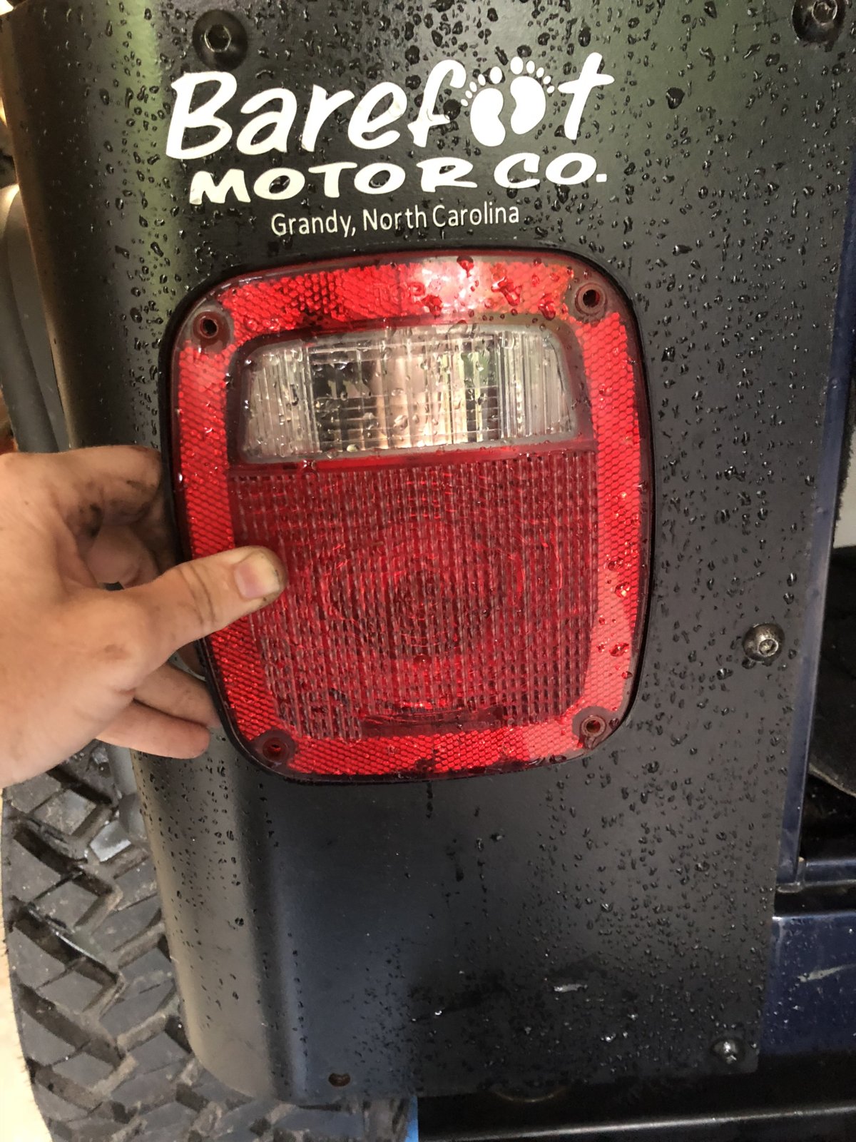

I do see that the bottom of the right tail light is clear unlocks the left tail light. So I’m guessing my only option is to splice into these wires.
The tail light with the clear bottom should be for the driver side.This will illuminate the license plate when the main light sw is activated.Its possible someone removed both taillights and put them back on the wrong sides.
The clear on the lens in your picture is for the backup lights. The clear lens for the license plate light is in the bottom of the housing.

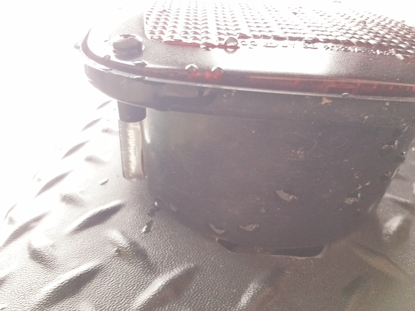

What the bottom of the taillight should look like on driver side(clear underneath)

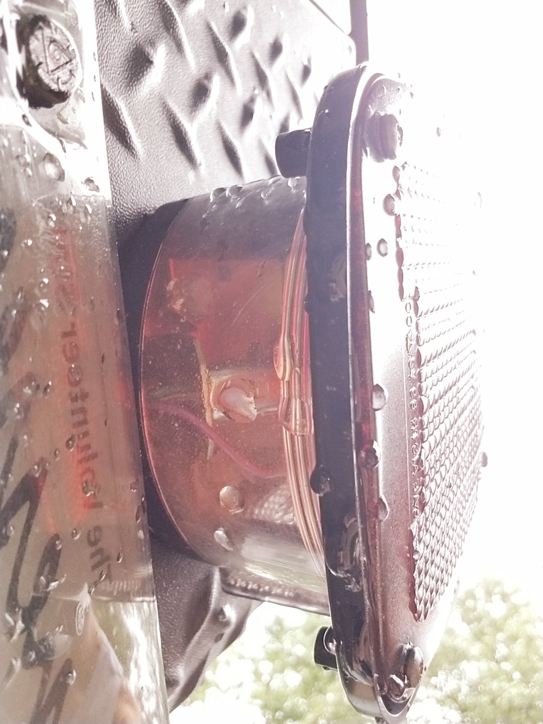

What bottom of passenger looks like,
like were saying the driver side has a clear lens to illuminate the taillight down through the housing and onto the license plate, therefore there is NO NEED for a light to be wired in

What the bottom of the taillight should look like on driver side(clear underneath)View attachment 42550
View attachment 42551 like were saying the driver side has a clear lens to illuminate the taillight down through the housing and onto the license plate, therefore there is NO NEED for a light to be wired in
Thanks Silver for supplying those pictures.

That lamp assembly appears to be flush mounted. You’ll need to wire in a separate license plate lamp as TJ4Jim stated.
