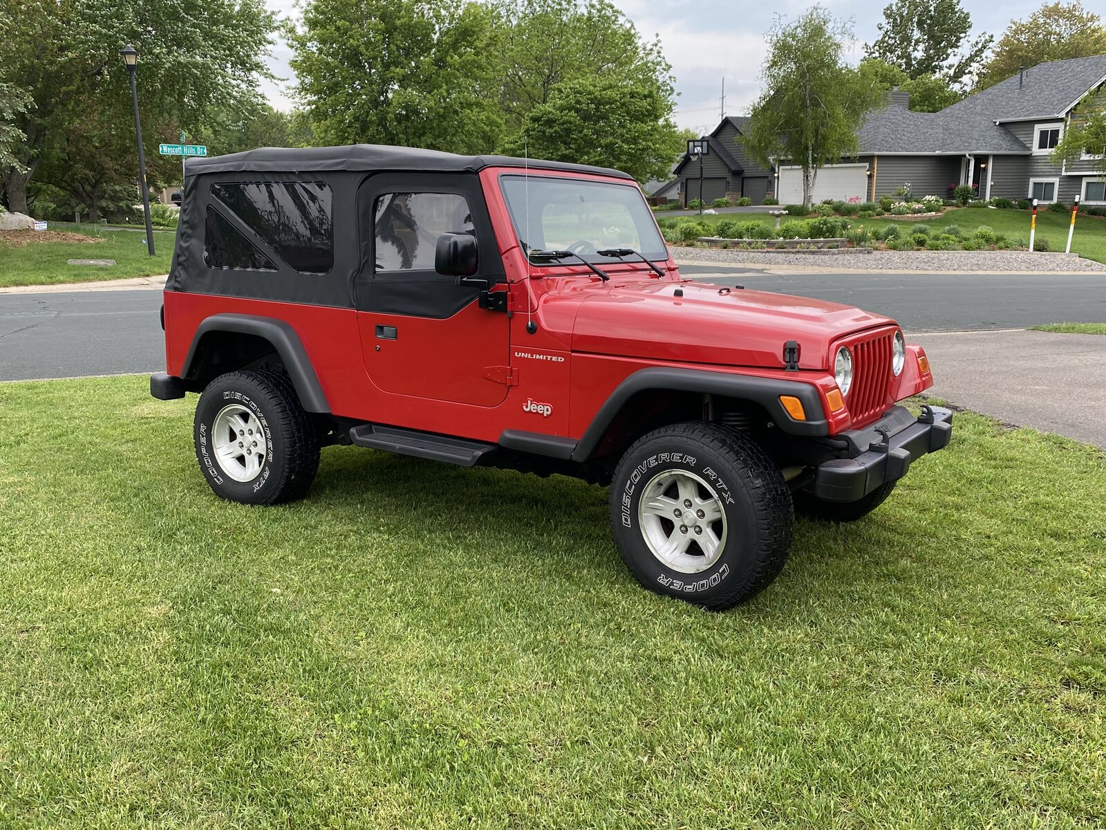

I want to see this Red LJ of yours. Is it out of the bag yet?
Just moved into position to start its transformation.
Here’s a pic before it went into position Monday.

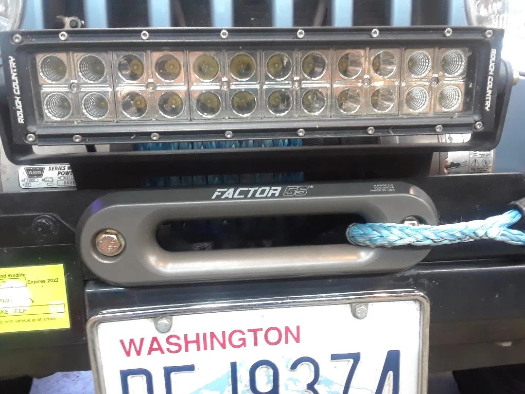

Ok, I'm here to bring about some closure. I'm sure some of you have been wondering if I ever installed this fairlead, and how it went (and did I have to trim anything).
It was fairly straight forward, but Jeep projects are never as easy as you think they will be. The only issues I had were:
1. I had a small LED light bar that mounted on a mount that bolted in front of the winch mount between the roller fairlead and the winch mount plate. So now I had to mount it behind the winch plate so the hawse fairlead would be flush with the winch mount. But to put it behind the winch mount, I had to cut about 5/8" off the bottom of it. Easily done.

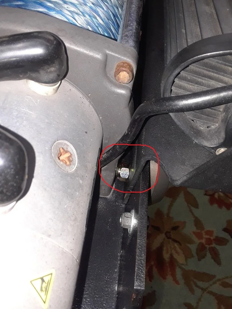

2. The original bolts would not work - too short. The original ones were 1.25" long; I needed just under 1.5" long. Too long and the bolt would hit the winch body before the hawse fairlead was snug on the mount. And with the LED light mount now between the winch mount and the winch itself barely had enough room for a nylock nut. So there are actually two washers behind the bolt heads on the fairlead to give me that credit-card thickness of space between the end of the bolt and the winch itself (circled in red).

4. I ended up trimming about .25" of material off the bottom of the opening of the winch mount (and then ground it all smooth) before mounting the new fairlead. The sides and top were fine, but I wasn't comfortable with how close the bottom of the opening on the winch mount plate was to the bottom opening of the hawse fairlead.
I'm pleased with how it turned out - I think I made the right decision going with the Factor 55 hawse fairlead.
