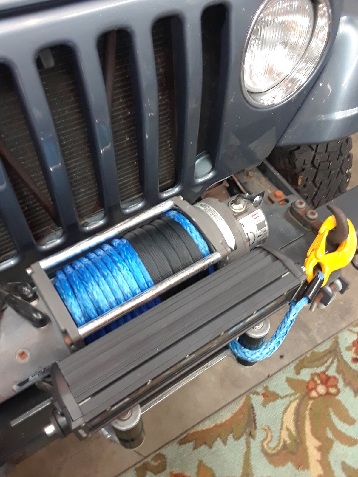

I don't have a thimble - just a big yeller hook.
I sent an email to Poison Spyder last night asking how thick their hawse fairlead was. They replied back this morning - 0.75". Which was too bad - if it was an inch I mighta bought it (blingy).

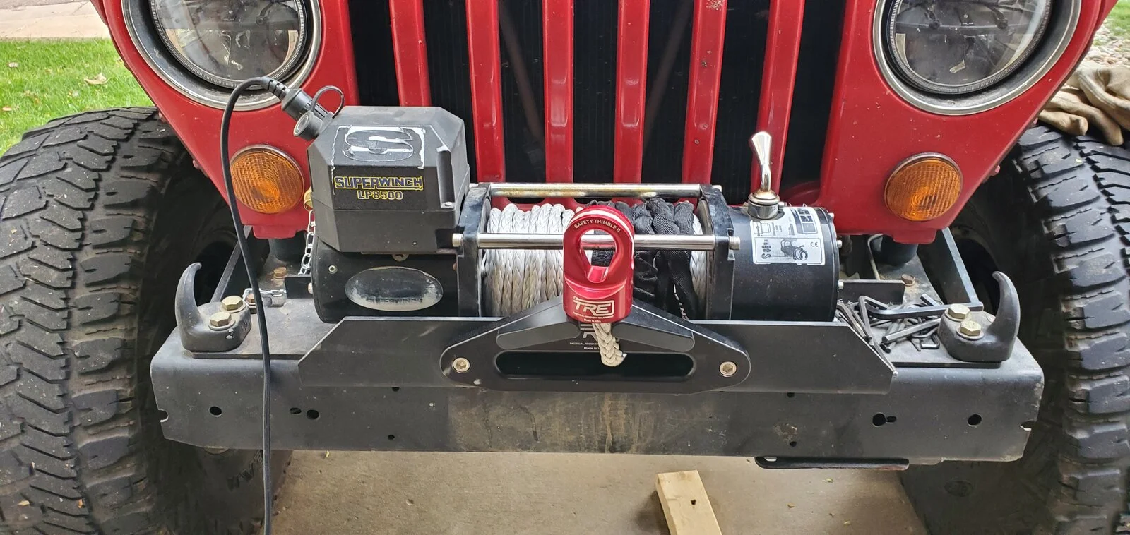

The TRE I have is 3/4” thick. I have the basic one, not the one that holds the thimble pointing up.

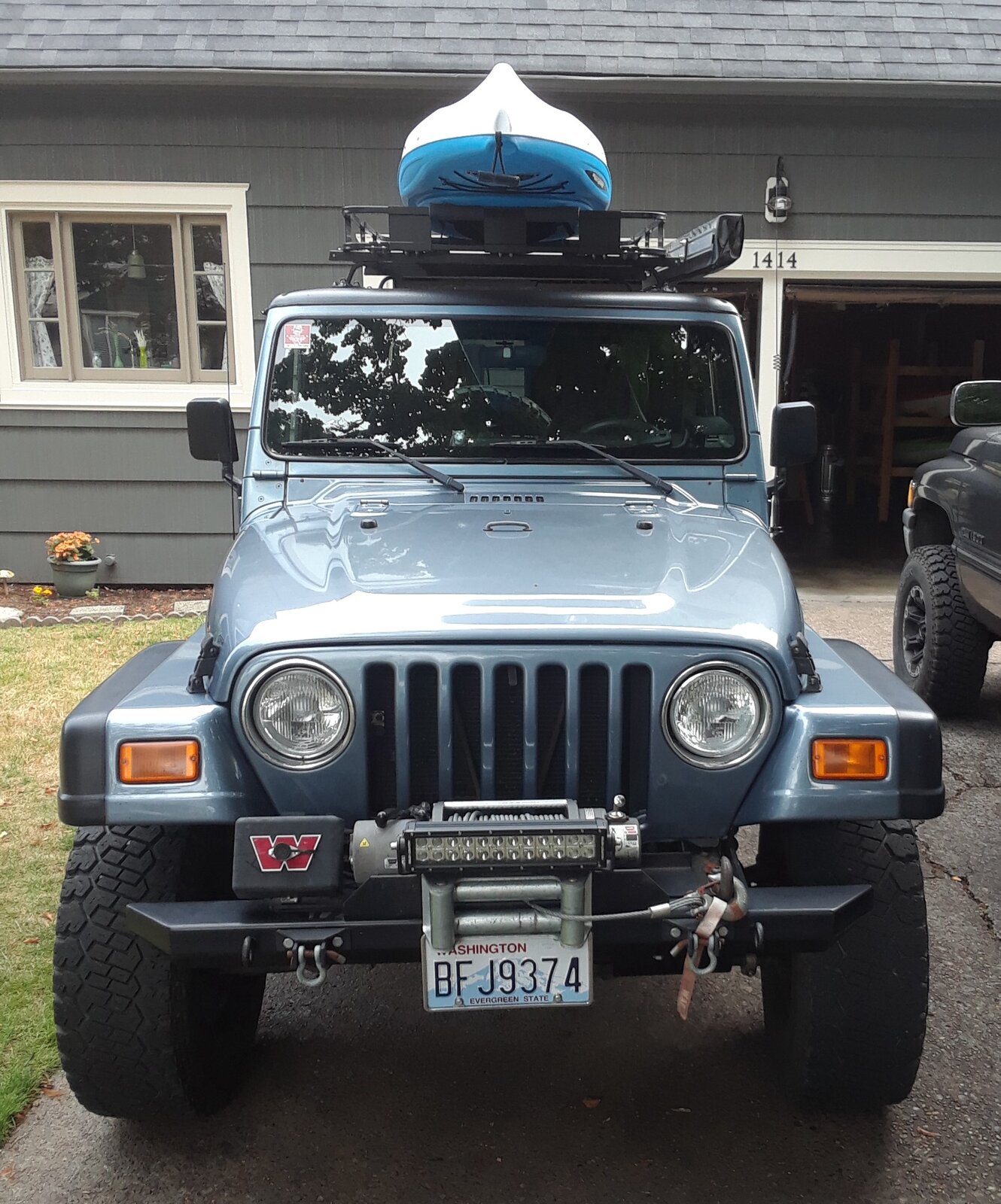

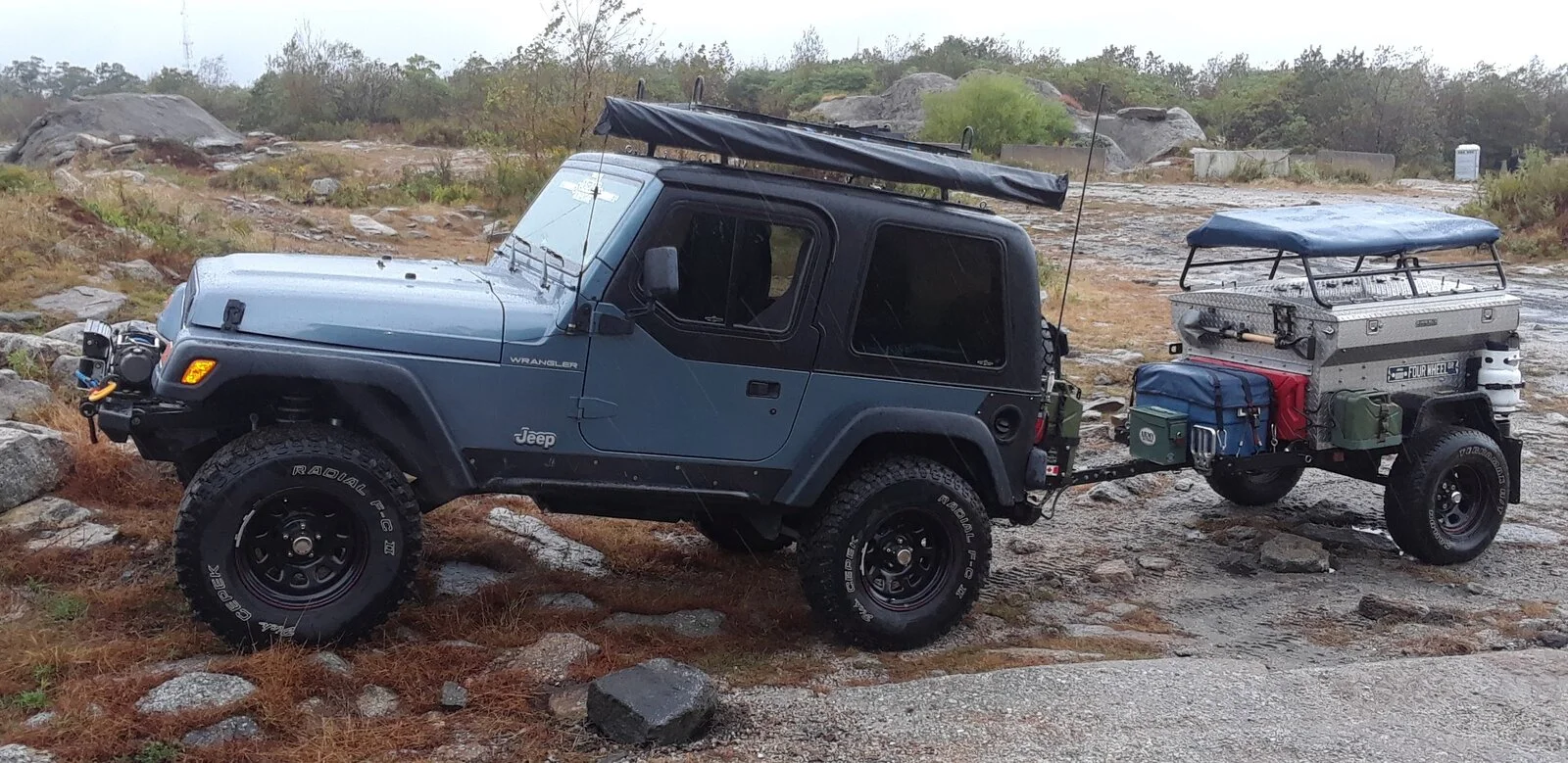

And sorry for all you TRE fans - theirs' is only .75" thick, and it sounds like nobody has any in stock anyways. And I have a light bar mounted above my current fairlead (shown below), so even if I did have a thimble, I don't think there would be enough clearance if I got the thimble holding one (I know there wouldn't). Maybe I'm just a boomer, but I just haven't got into the whole thimble thing or see the great advantage of them when I've got a perfectly good HD hook on the end of my winch cable.

I may have to enlarge the cable opening on my winch mount for this new hawse fairlead. I'll find out when I go to mount it up. And since my hook is permanently attached to the winch line (see pic in post #22 above), I may have to unspool the cable before I can mount the new fairlead. There's always a domino effect it seems.
