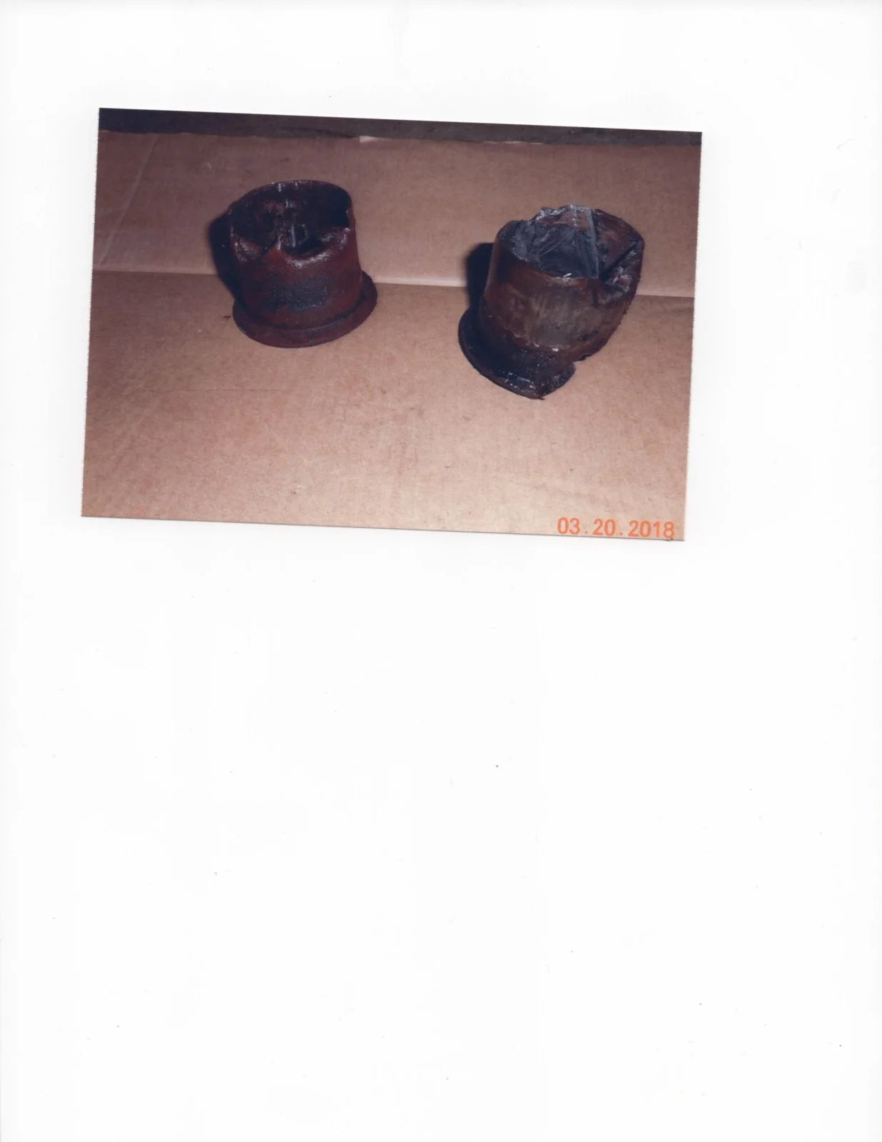

Did those used to be control arm bushings?
the upper front on the axle, just got them out. took like a 3/8 drill bit/ drilled the rubber acouple holes, an pressed the rubber bushings out on drivers side, an on passengers side, the drill bit went in an rolled around the entire outside of rubber bushing an spit it out:) . then took a sawza an cut into them cups a bit, an then took a screw driver, an a flat punch an banged in the ends, with pb blaster, an then punched them out. used a monkey pipe wrench to turn them a bit, also. wasnt to bad. got the new ones in the freezer next to the frozen blackberries..we'll see what happens putting them in tommorow:)
Nice work there! You saved yourself a lot of money, and kept the original control arms
