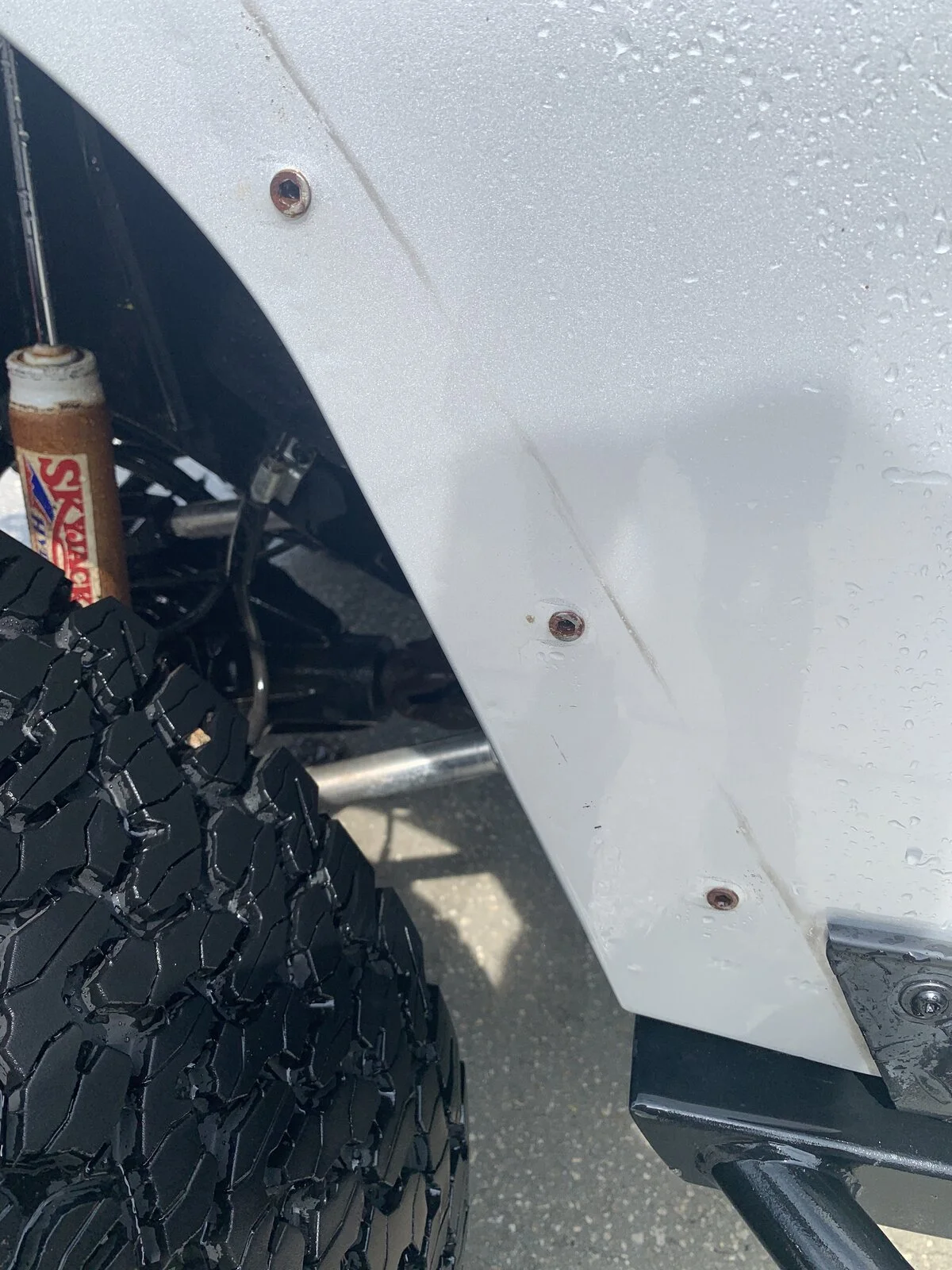

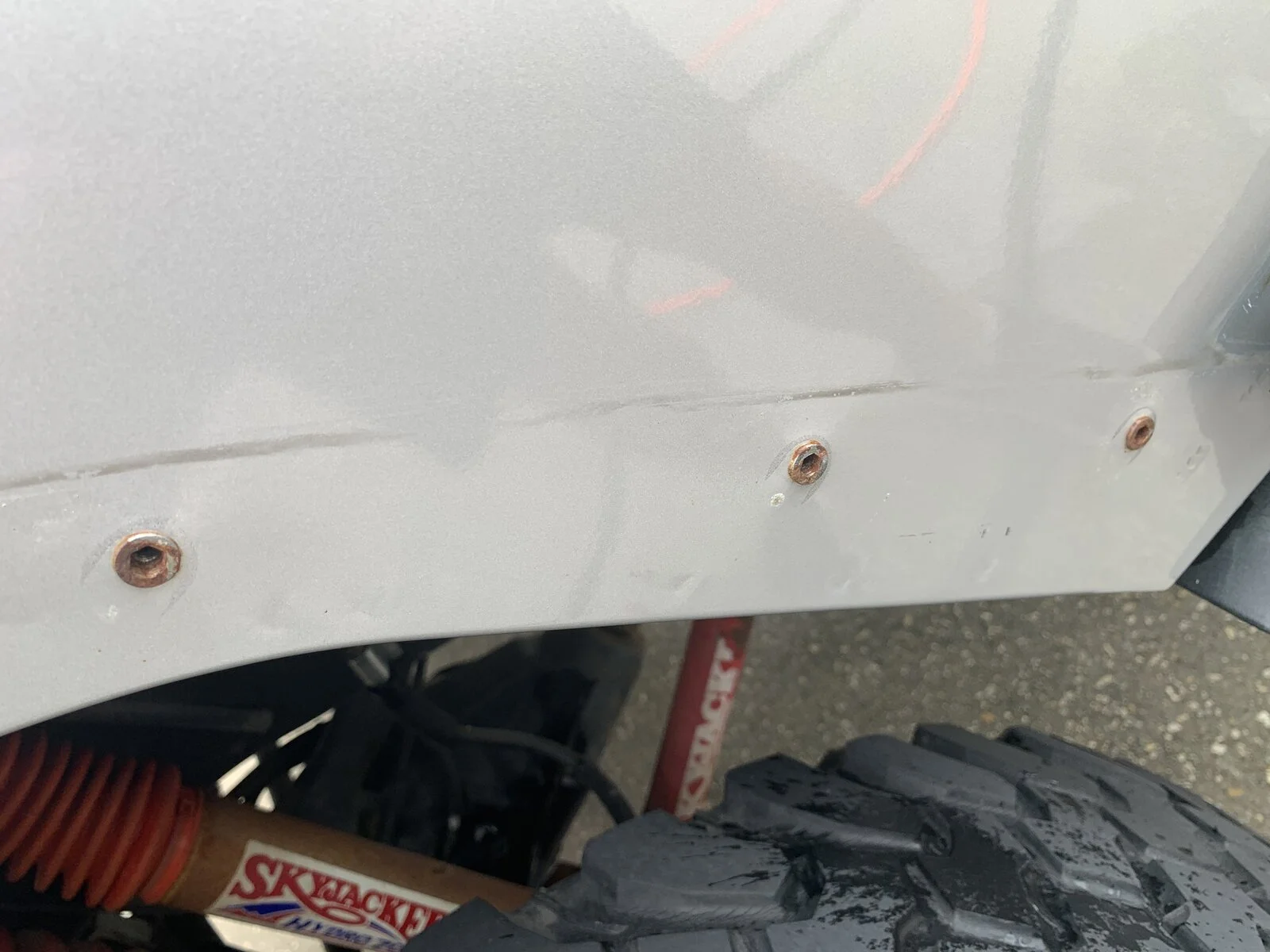

How do u get the metal alan nut off to make a new hole?
If you are referring to what I have pictured below its not an Allen nut, it is a nutsert that for some reason has a six sided hole. Mine were rusty so I drilled them out with a 9/32 bit and replaced with a new nutsert. You could also just use regular nuts and bolts. On the rears though the liner realy gets in the way.
When I replaced my flares, I replaced all my plastic ones with aluminum nutserts and stainless steel bolts (10-24 I think). Bought a nutsert driver and it worked like a charm.
Hope you used Lanocane, TefGel or some other insulator on the SS fastener threads. The SS will weld itself through dissimilar metal corrosion to the aluminum NutSerts in short order without an insulator.
