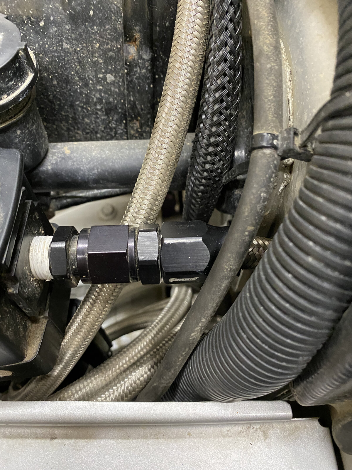

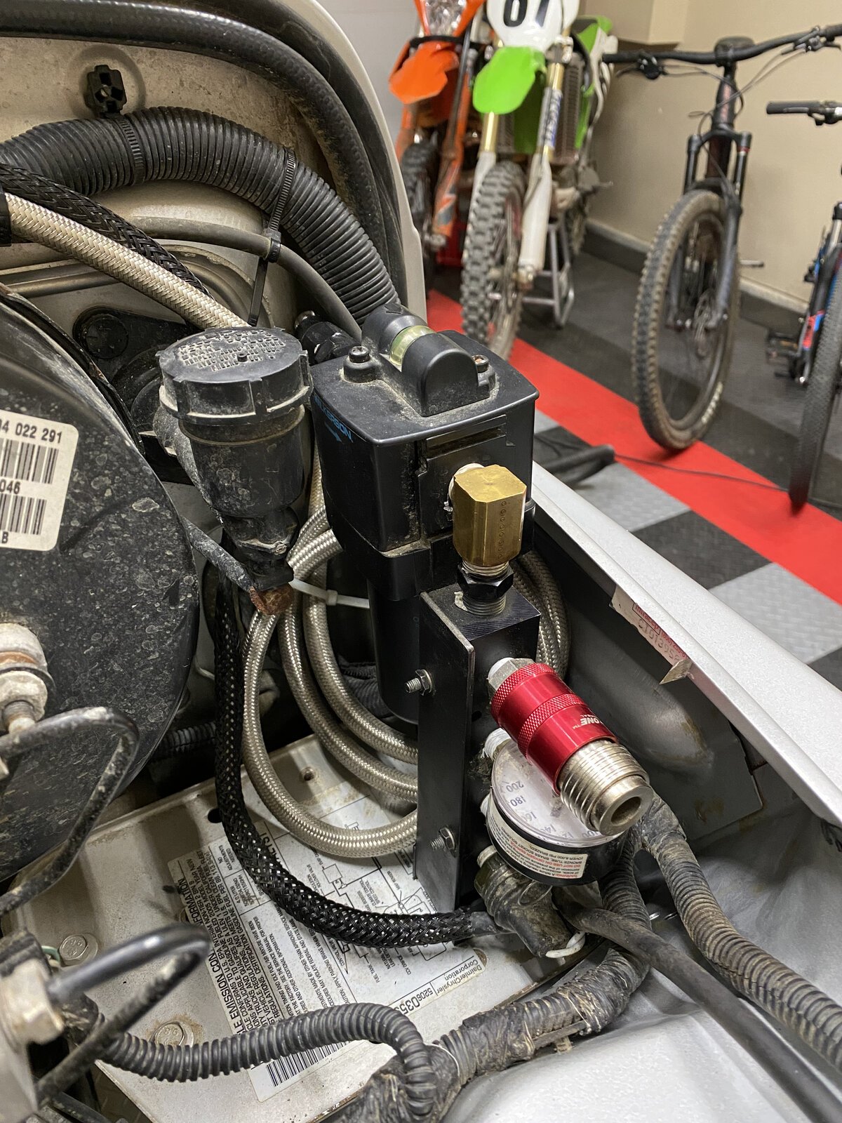

I ended up using -8 AN PTFE stainless steel braid from Summit Tools. This is 1/2" diameter which is probably overkill but it fills my tires really fast! PTFE has a higher temp rating and is oil safe.
Summit then has screw on hose ends in various male/female NPT sizes. If you use PTFE you need to use their special PFTE fittings.
I used the flange fittings from C U Offroad which were 1/2 NPT male.
Air intake filter, pressure switch, guages and manifold were from McMaster Carr.
Draw out your manifold to figure out how many plugs you need to buy.
I highly recommend the Milton 5 in 1 Safety Exhaust Coupler. It makes it super easy to connect/disconnect the pressurized line.

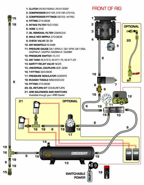

Here is KIlby's manual on installing OBA. Just like many other things there is going to different versions of the proper way to install OBA.
Here is a typical setup in a layout.
You want a unloader/check valve like this also so that when it shuts off it takes the pressure off the compressor head.
https://www.amazon.com/gp/product/B003H7Y03Q/?tag=wranglerorg-20
While a little expensive it works well. You need some type of hi temp hose coming off the discharge side and the one ORO sells fits the bill.
https://offroadonly.com/shop/on-boa...air/braided-high-temp-compressor-outlet-hose/

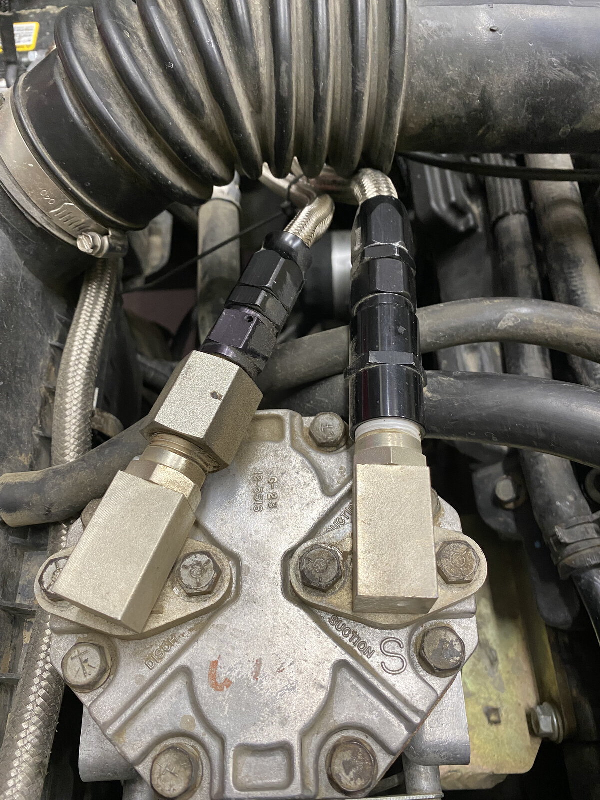

Do you have the fittings for the top of the compressor yet? Is your York the new one from ORO? I might have the fittings you need for the top of the York. Send me a picture of your York head.

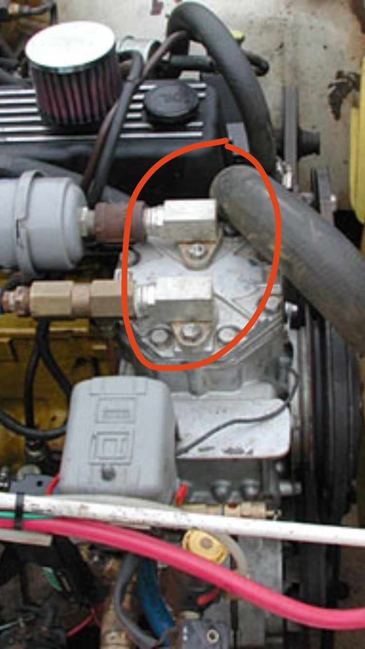

for the fittings what style head is on your york?
Ill skip those mentioned above, how do I know what head I have?
Reactions: Wildman
You need the RotoLoc fittings and they are $52 a pair on CU Off-Road
https://www.cuoffroad.com/product-lines/onboardair-com-components/
I have a pair of the bolt on style that I don't need any longer. Bummer it's not the type you have.
