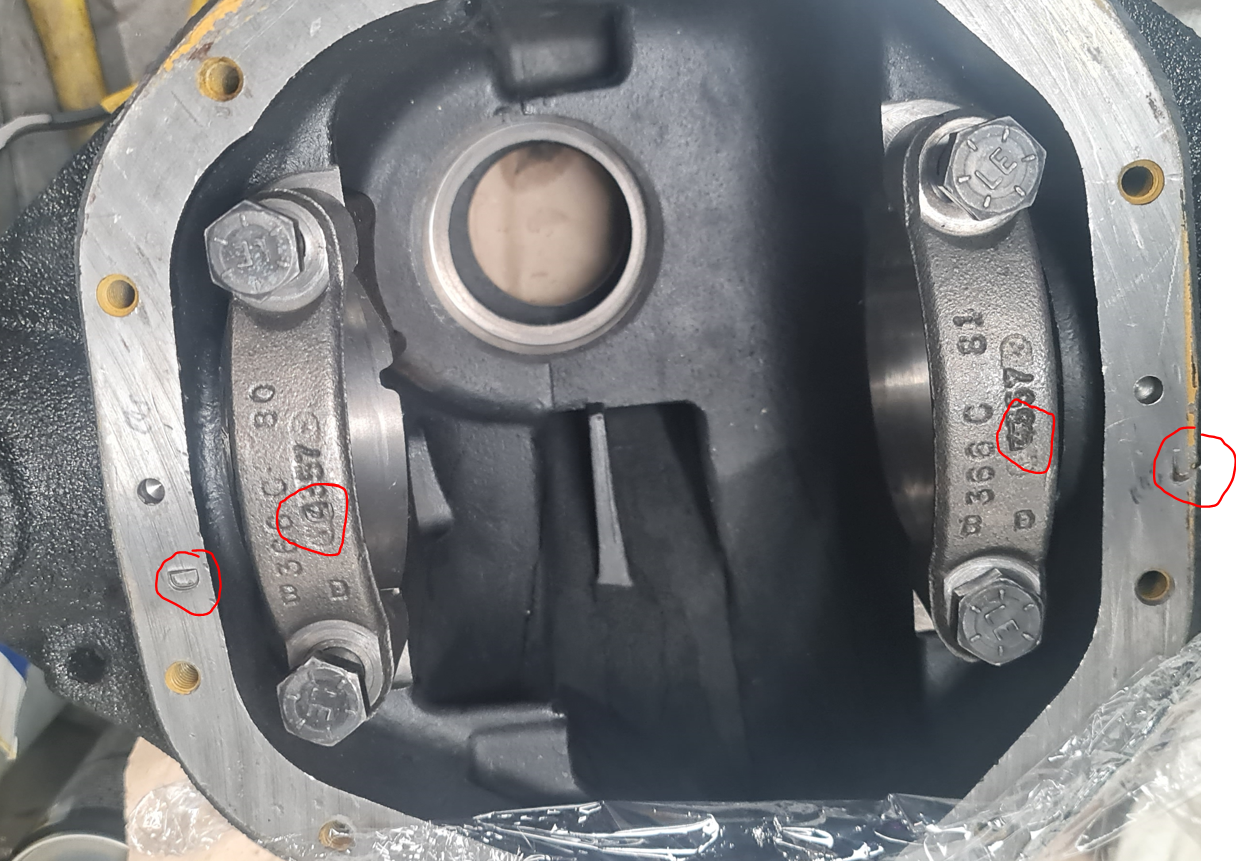

Option a (stamped letters): All the photos below represent bearing caps put in referencing correct letter orientation
Pros of this option:
- it seems intuitive, and one would expect factory has marked these correctly.
- Serial code is orientated consistently across two bearing caps.
Cons of this option:

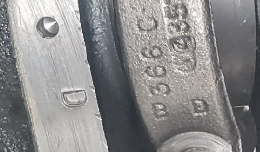

- Letters are stamped in weird placed - too far on the edge of the casing, and over the serial code on the cap:

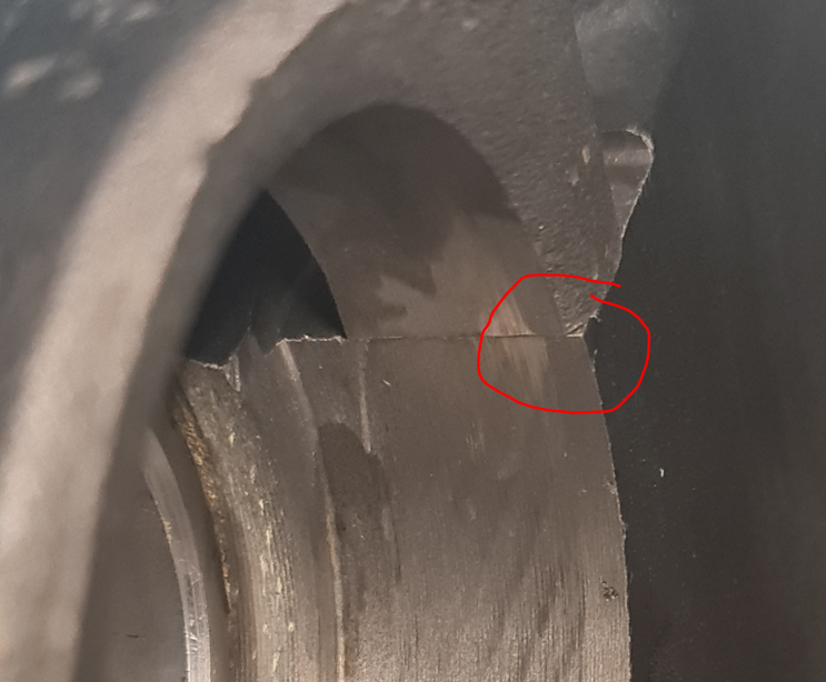

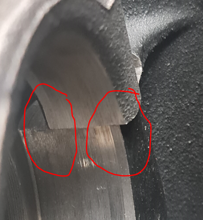

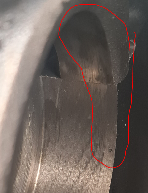

- When inspecting machined marks in this orientation, it seems they are all over the place, to an extent that probably one of the caps is upside down (if I use darker ring mark on the cap/casing as a reference):

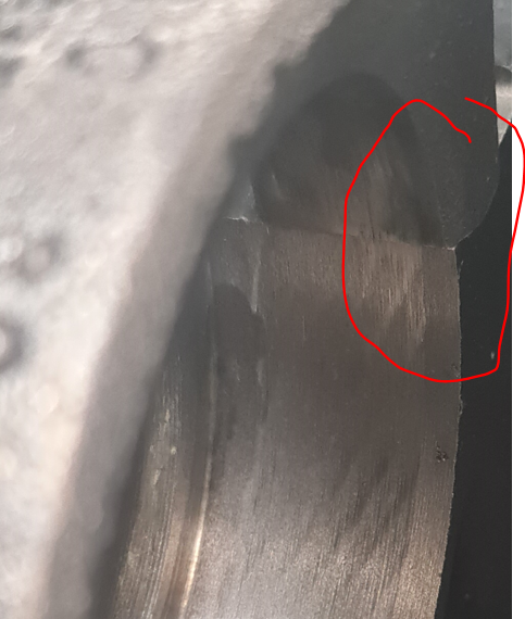

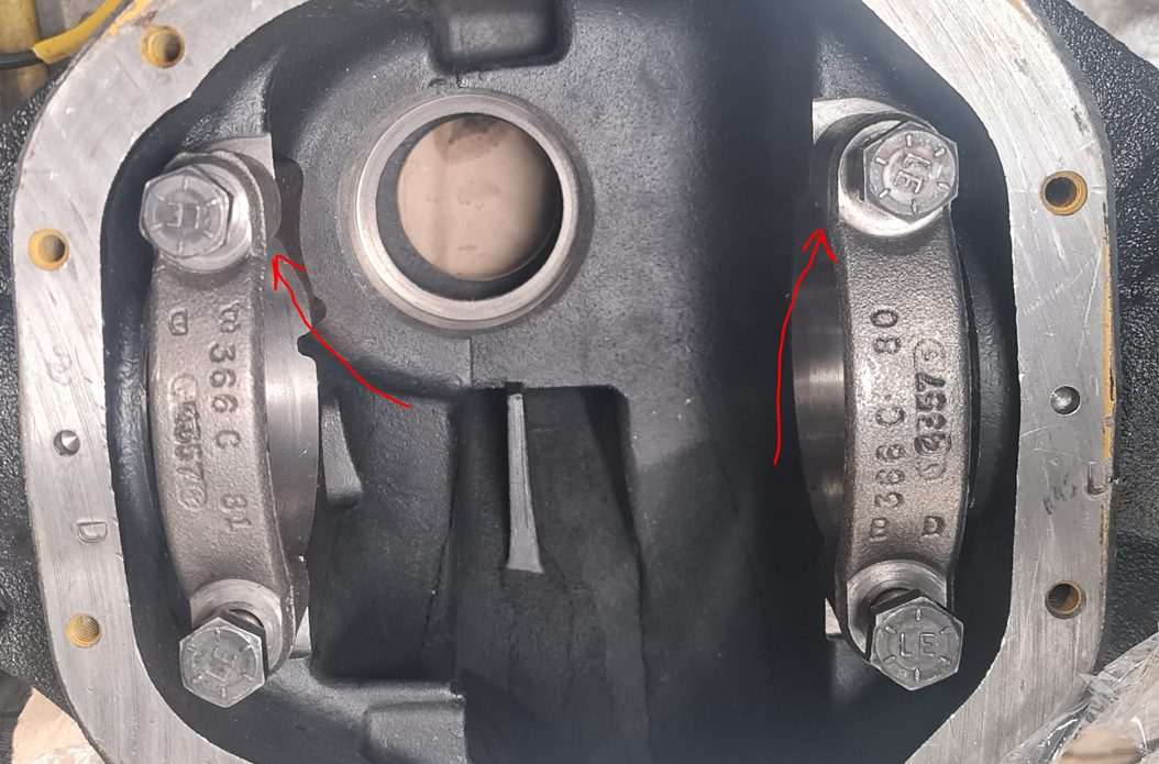

Option b (machiened marks): All the photos below represent bearing caps put in referencing matching machined marks (mainly the dark ring colour facing the center of the axle from both sides):
- the pattern matches REALLY WELL ono all 4 sides:
- Mismatch of darker ring mark on one side
- Wrong side of the dark ring mark on the other side:
