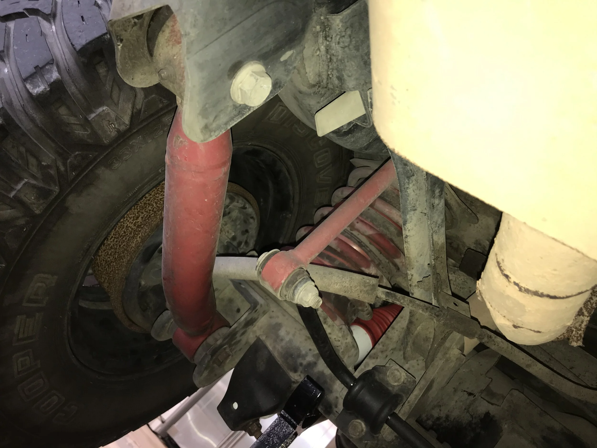

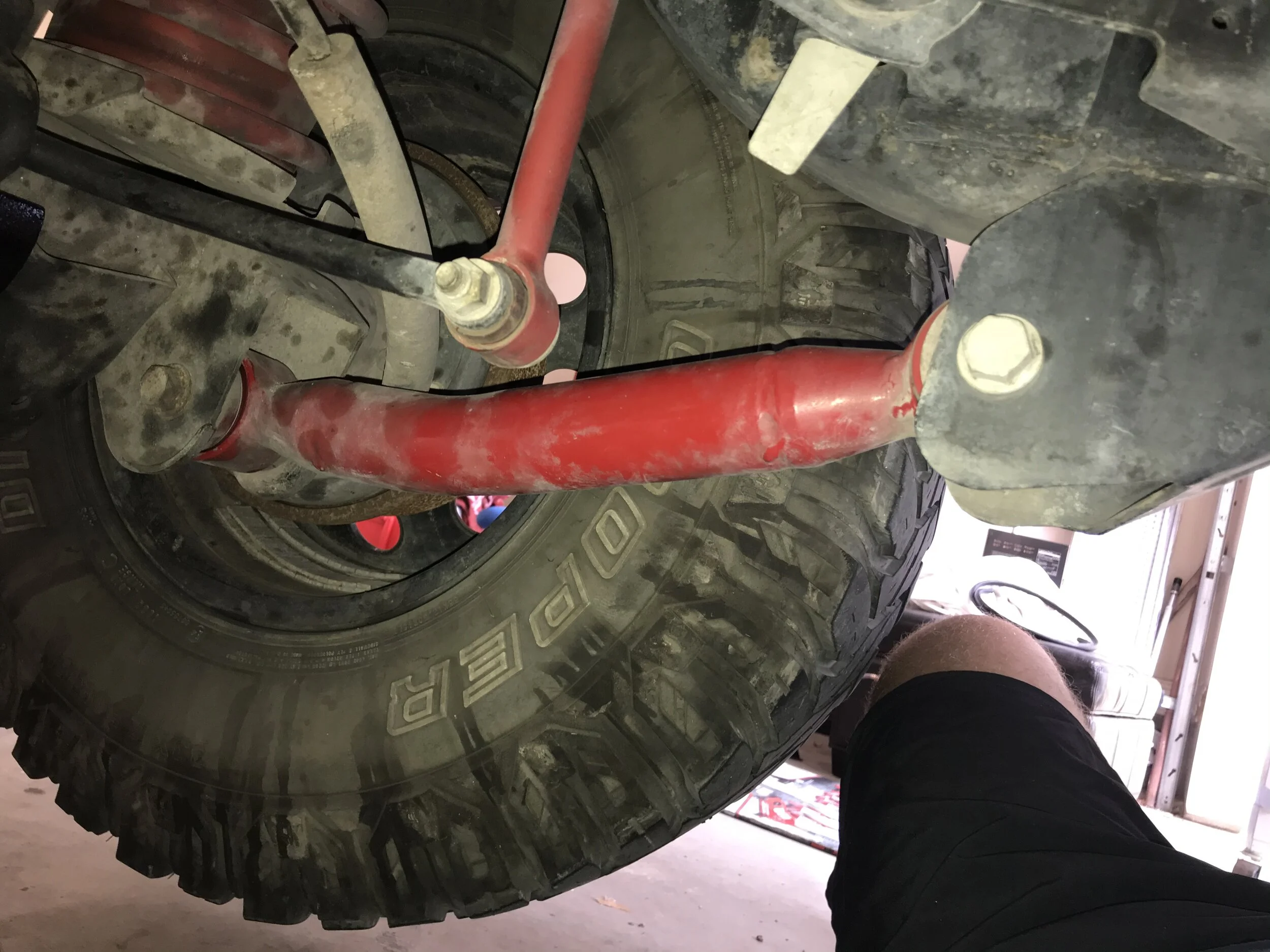

I mean, I guess there could be aftermarket fixed length control arms....but that would be REALLY dumb.

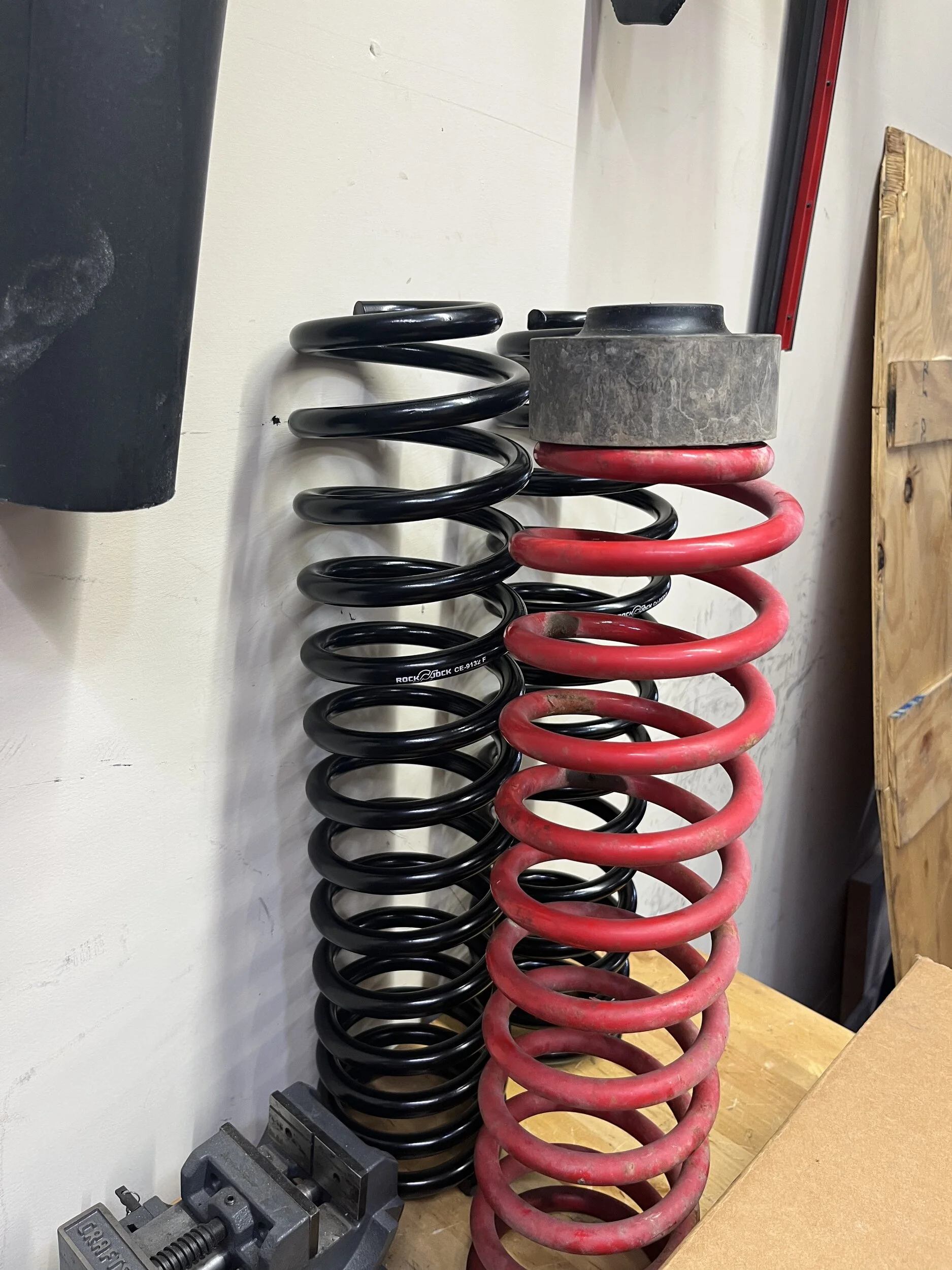

This is what came on mine when I bought it.
3 1/2” Rancho lift with Fixed lowers front and rear. Even cooler, the Springs weren’t 3 1/2”, Rancho had a Spring/spacer combo as their springs in their lift kit.
Yeah, I'm aware of the lower fixed arms. I forgot to include the word "upper" in my post. I'm not aware of any aftermarket fixed length upper control arms. (I'm sure someone will be along to prove me wrong on that).
