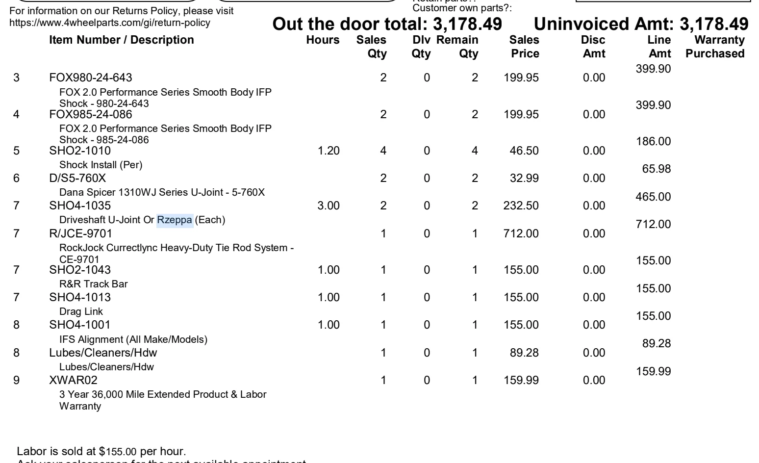

Took it to the nearest 4 Wheel Parts store to get it evaluated and this is what they came back with:
Feels kinda pricy is my first reaction 😅
I'm going to skip all the shock work, I'd love to use Fox but those are way out of budget. I already have a set too as I had a suspicion the shocks were all going out due to the harsh ride. I must have been hitting on the bump stops half the time.
It looks like they're also saying I have some u joint issue. Is there a way I can check this on my own? I have crawled under to take a look and aside from what feels like a little bigger than usual lash in the front shaft, everything else feels fine. No vibrations going down the road. I'm incline to let this one wait a little longer if it's even needed?
They also said slop in my steering geometry was to blame for the death wobble issue. It looks like they're asking to replace the tie rods, drag link and trackbar. Is that something that can be serviced instead? I am also planning to do this part on my own as it doesn't look hard.
Like was said, you already have the curry link they are recommending @ $750. For $155, that front IFS alignment is useless, search on this site how to set your toe… it’s about the only thing you can do on most Jeeps.
I talked to the shop some more and it looks like it’s just the tie rods that are worn. They put drag link and track bar as labor costs for tie rod install
Are you saying that the curry link is likely good? Or that there’s something I can do to service it?

I wouldn't let them change out the currie parts without careful diagnosis. They are expensive. Your estimate is blurry so its hard to tell what they plan.
Worn front track bar and imbalanced/out of round tires/wheels would be high on my list of DW causes
