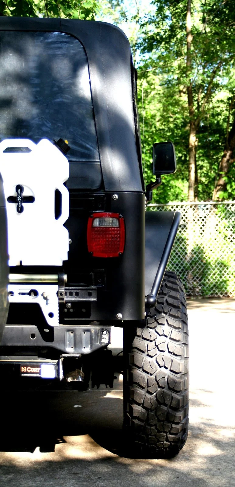

don't have a good pic..but mine hangs on the tailgate with the help of the Ace Gatekeeper
