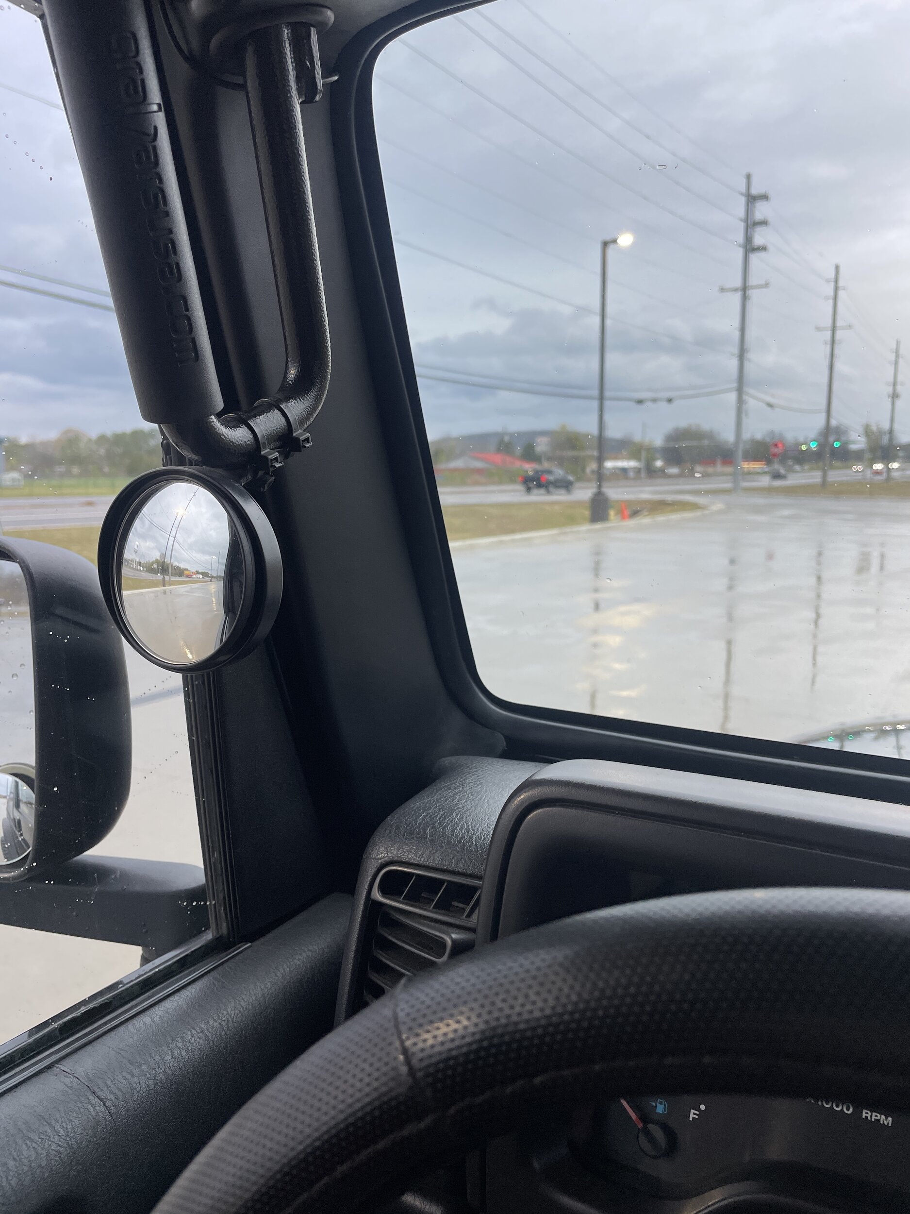

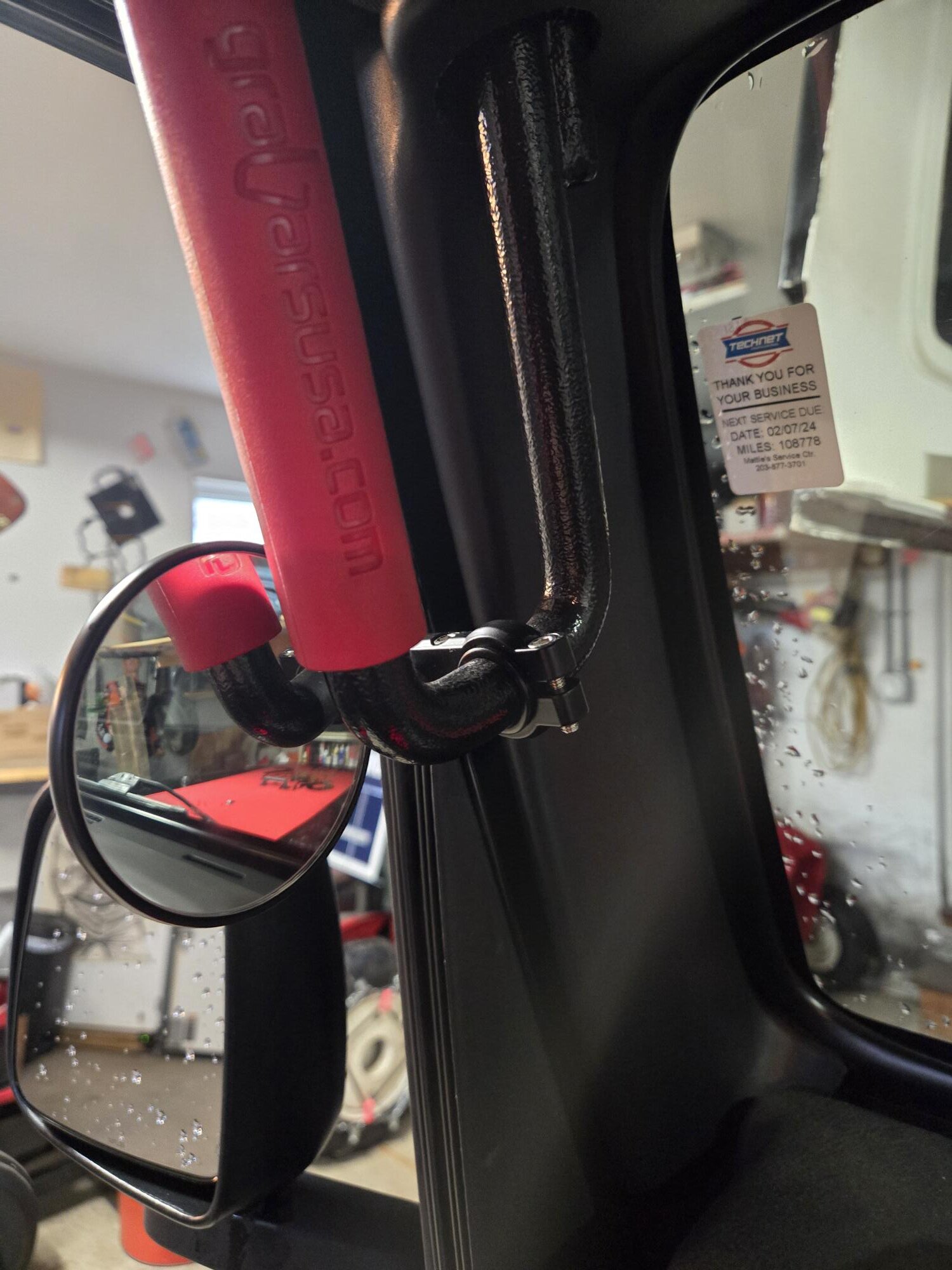

Thank you gents...Exactly what I was looking for. I was thinking motorcycle end bar mirrors. They clamp onto a 7/8" diameter bar. Mine is 3/4". I'm certain whatever I find, I'll have to mess around with it to get it to work. The goal is to not have to take them off. Most likely have to fold them in when not in use.

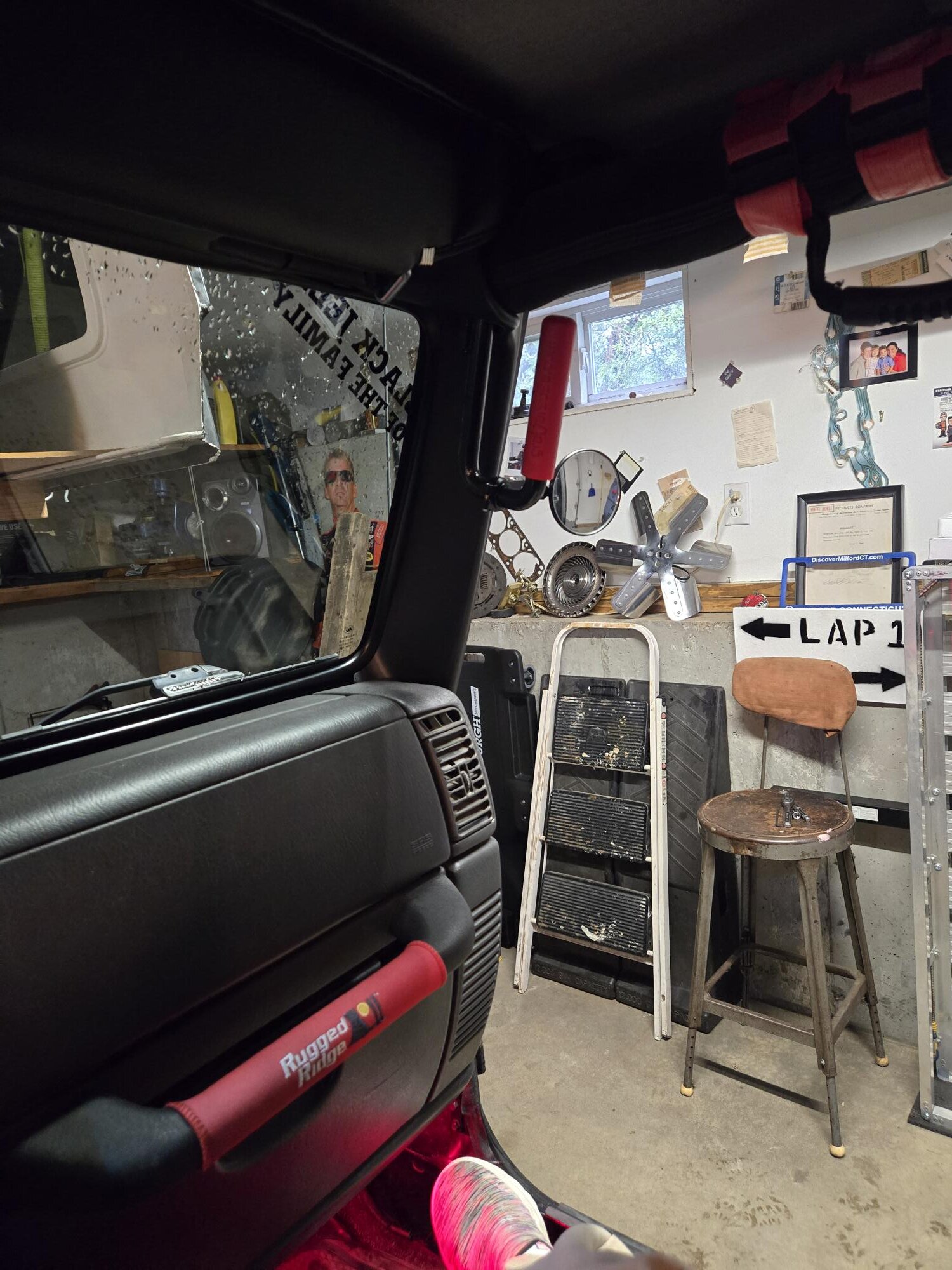

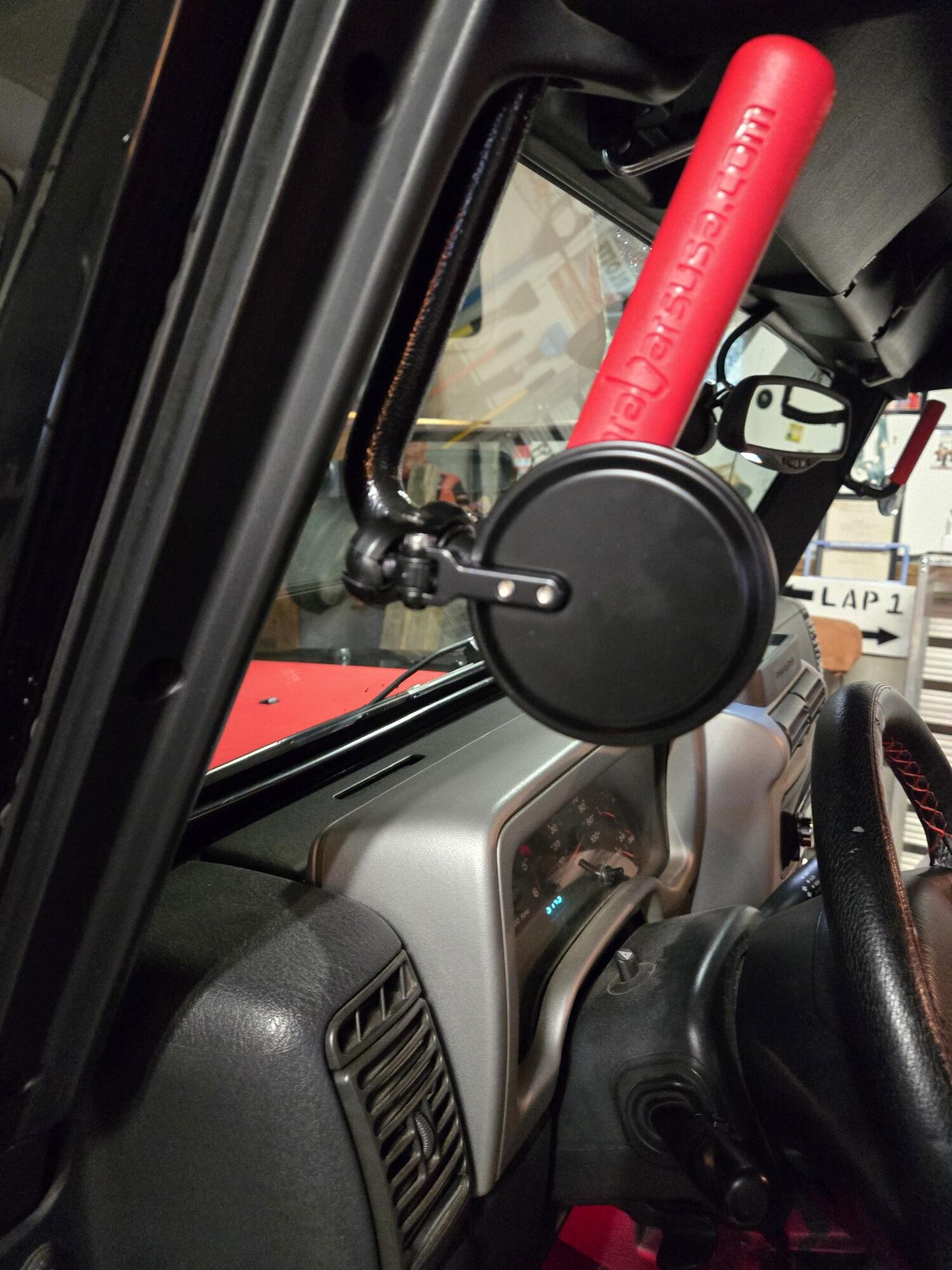

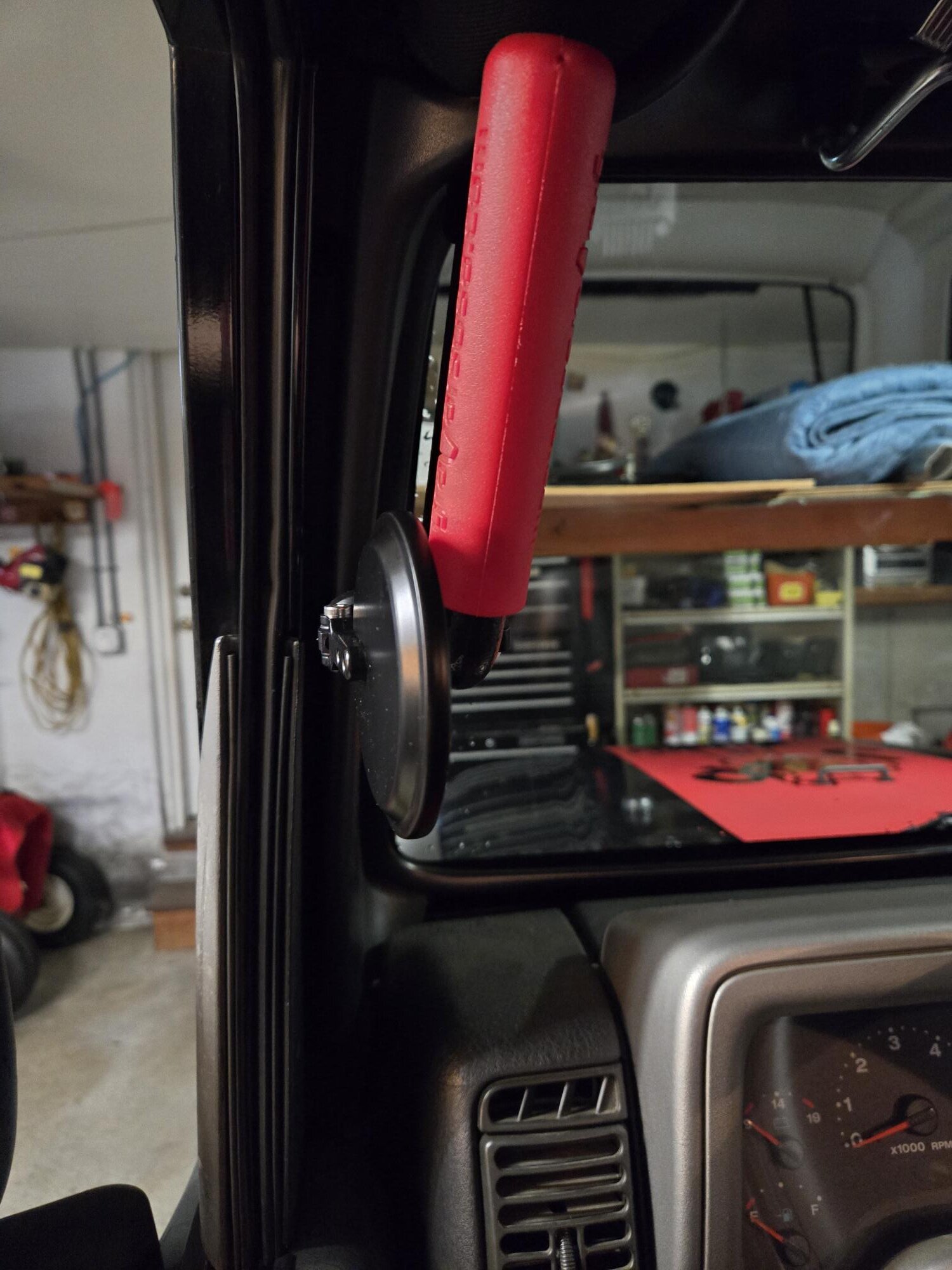

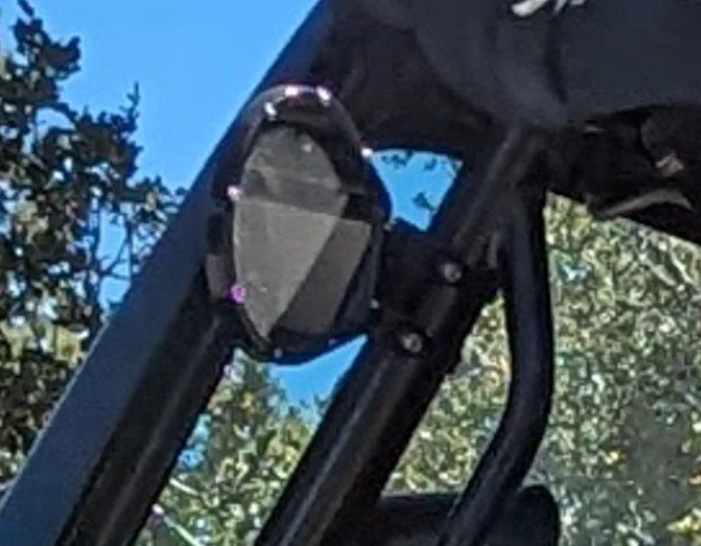

Thank you all. I ended up getting motorcycle bar end mirrors. I modified them as needed, and here is what I ended up with. When folded up, they stay in place and clear the door when closed. They are also out of the way enough so the grab bars function perfectly. Pretty clean install, mission accomplished.

I like those, this might be the door off mirror solution I have been looking for. I like the idea of the CMM Grab bars + mirror but can’t get over the look or the price. Do you have a link for those mirrors?

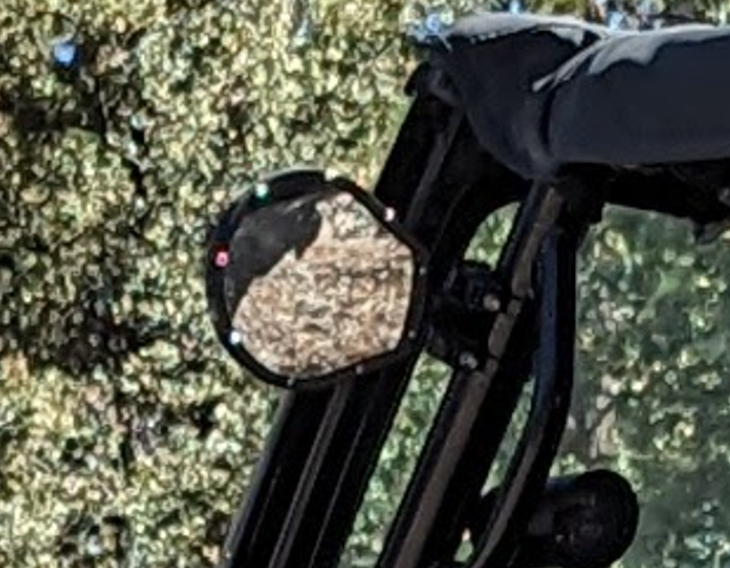

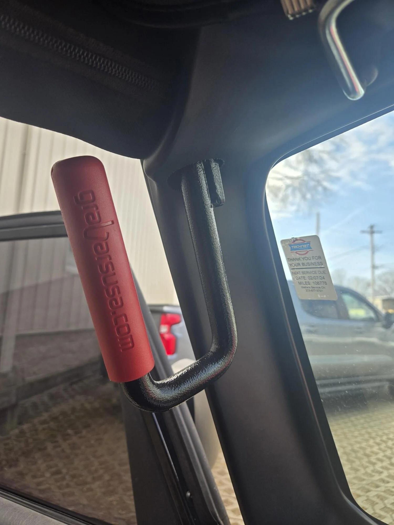

I sucked it up and bought the CMM bundle. Over the past years of TJ/JK ownership I have had so many frankenmirror setups.. some worked better than others, all looked decent. CMMs were not cheap but they are solid and complete. So far no regrets
That said.. you're look like a great solution. My first choice would have been Grabars, second was ATP but both are on intergalactic back-order.
