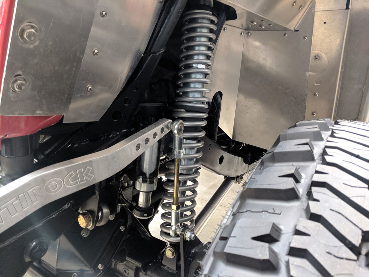

I loaded up the coilovers with their new springs and got them back on the Jeep.
The front springs are Eibach 2.5" 14x150/16x250 with 1" preload.
The rear springs are Eibach 3.0" 14x125/16x200 with 1.5" preload.
The lockout rings which stop the dual rate slider were set to prevent coil bind on the upper springs. I'm going to play around with the position to see if an earlier transition into the harsher spring is beneficial.
I charged the coilovers with 200psi of nitrogen. The idea here is that the nitrogen keeps pressure on the internal floating piston (IFP) which separates the nitrogen from the oil. If you have too low of pressure the piston can cavitate in the oil, if you have too high the IFP won't be able to move. Generally, ride quality changes should be made by changing shock shims not by changing nitrogen pressure.
The pressure in the bumpstops is set to 1/6 of the corner weight. The front corners weigh 787lbs so I set the front air bumps to 130psi. The rear corners weigh 590lbs and the air bumps are set to 100psi. Unlike shocks, air bumps can be tuned with pressure. 1/6 of weight is just a starting point and will change as I get the suspension dialed in.
The ride height with those springs came out just about perfect. I'm going to see how things settle over a few drives, and may need to adjust preload slightly to dial in ride height. Right now the coilovers have the factory tune in them. Once I get a baseline on the ride quality I'll figure out how I want them tuned.
(The rear parking brake cable gets in the way and is disconnected until I finalize the tune in the coilovers)
Looks great. Nice work.
I think you'll find you can run less pressure in the bump stops, they can be pretty harsh and cause kicking when you get into the desert. But definitely play with it, see how it feels.
Good to know. Once I get to trail runs I'm going to have to find space for my nitrogen bottle so I can play with the tuning.
