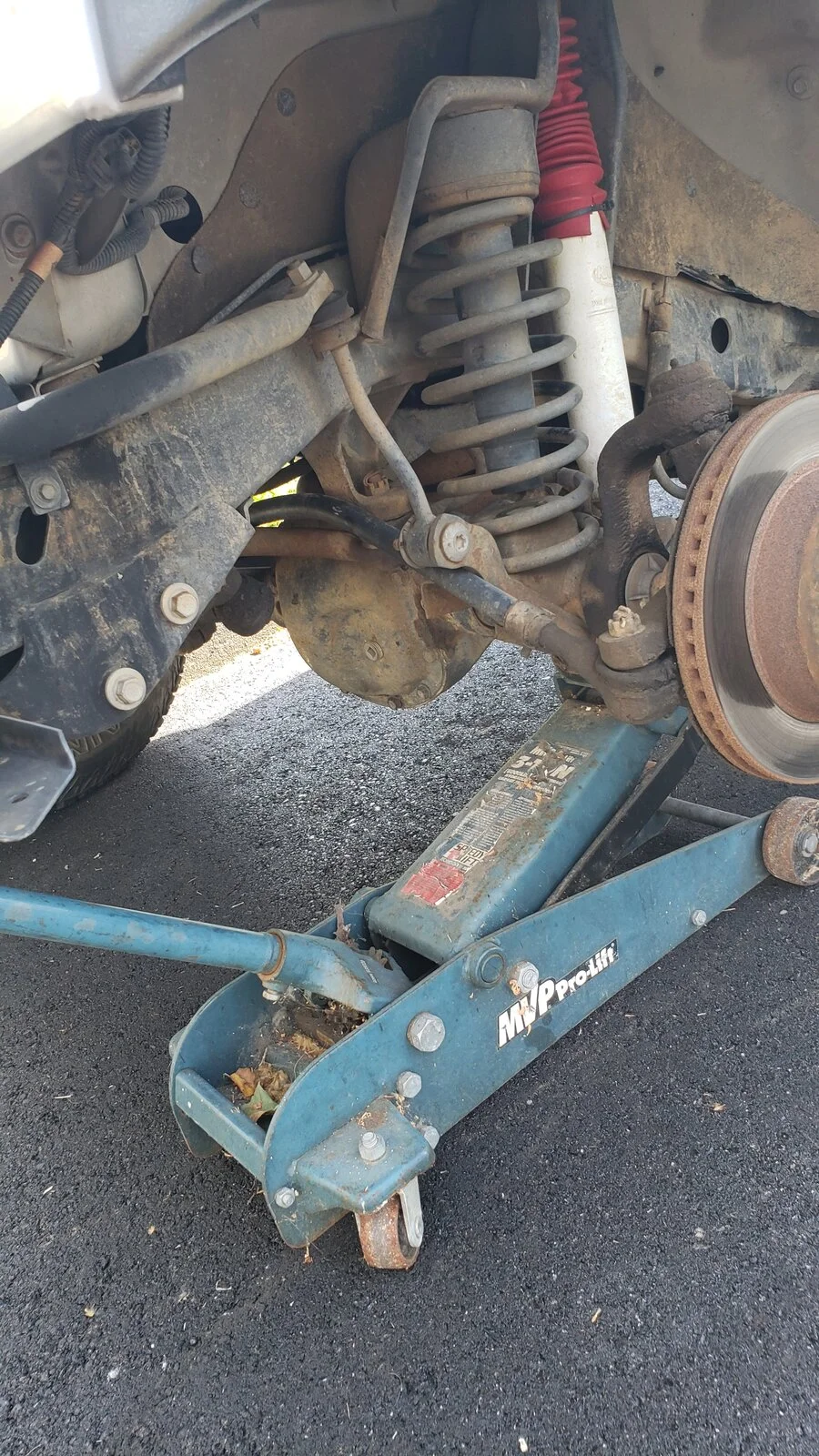

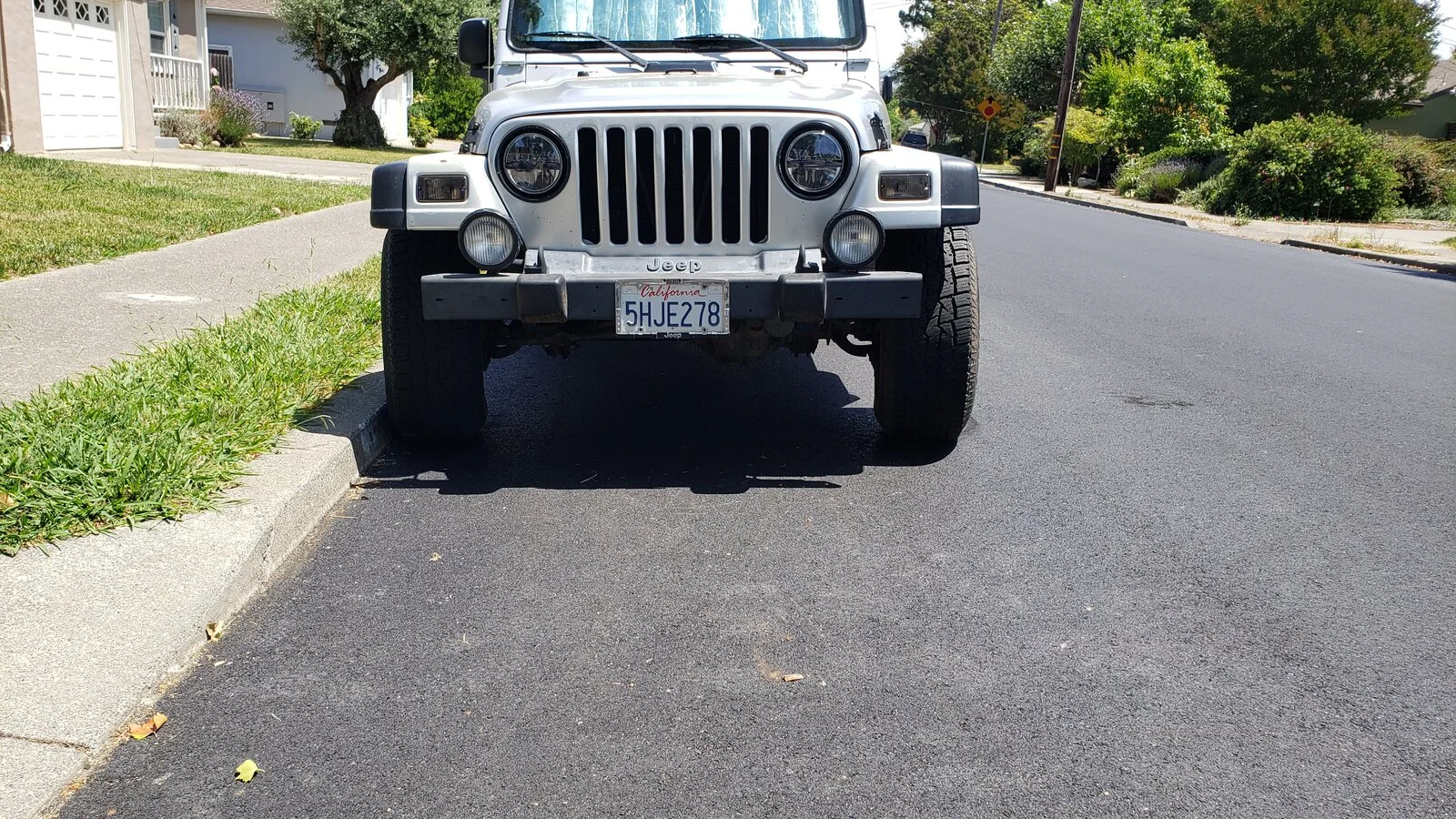

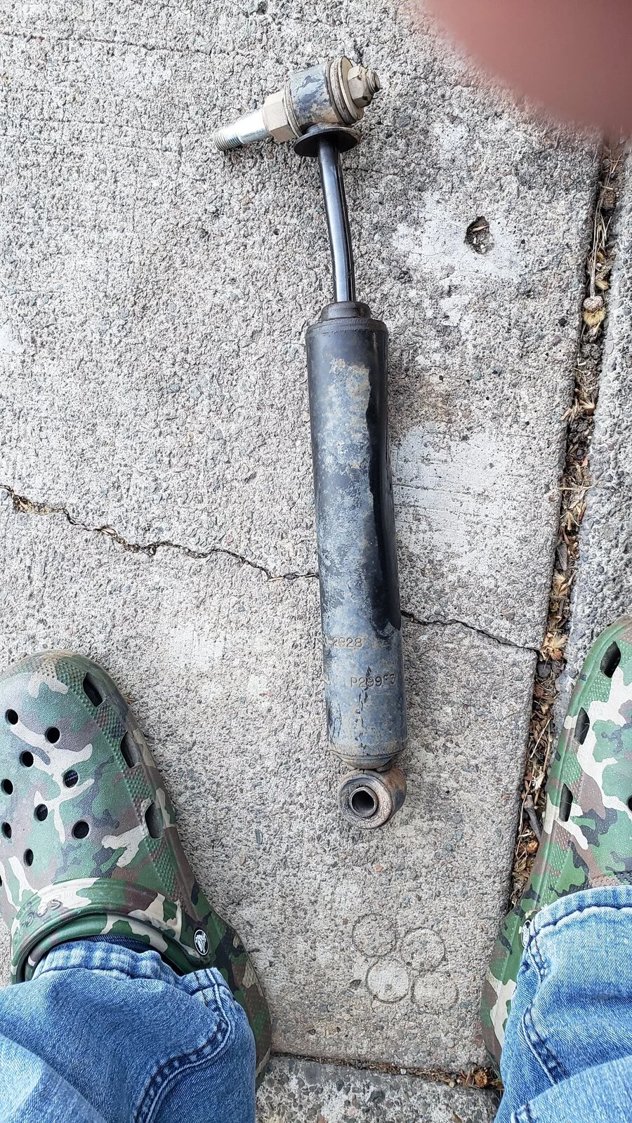

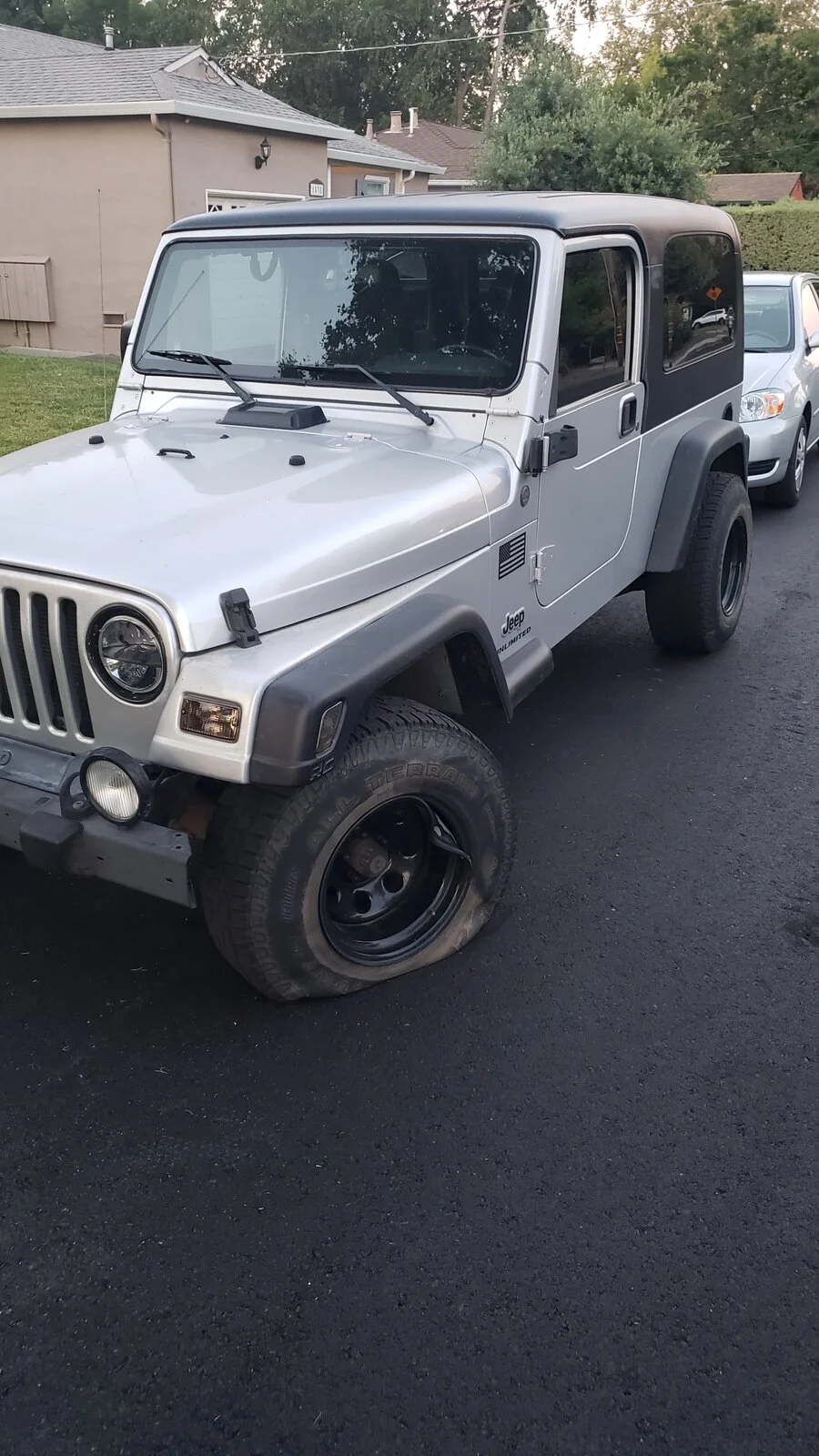

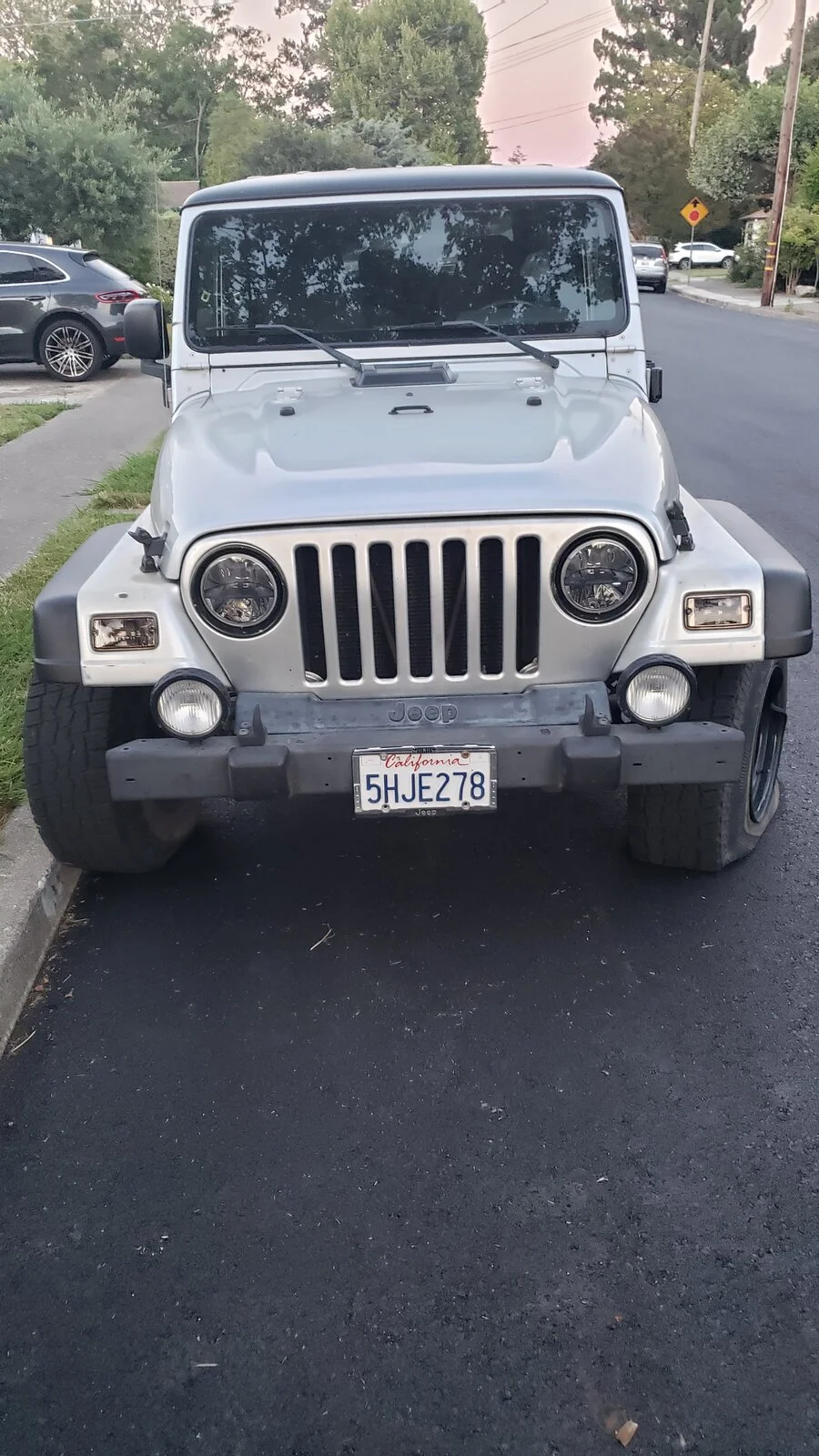

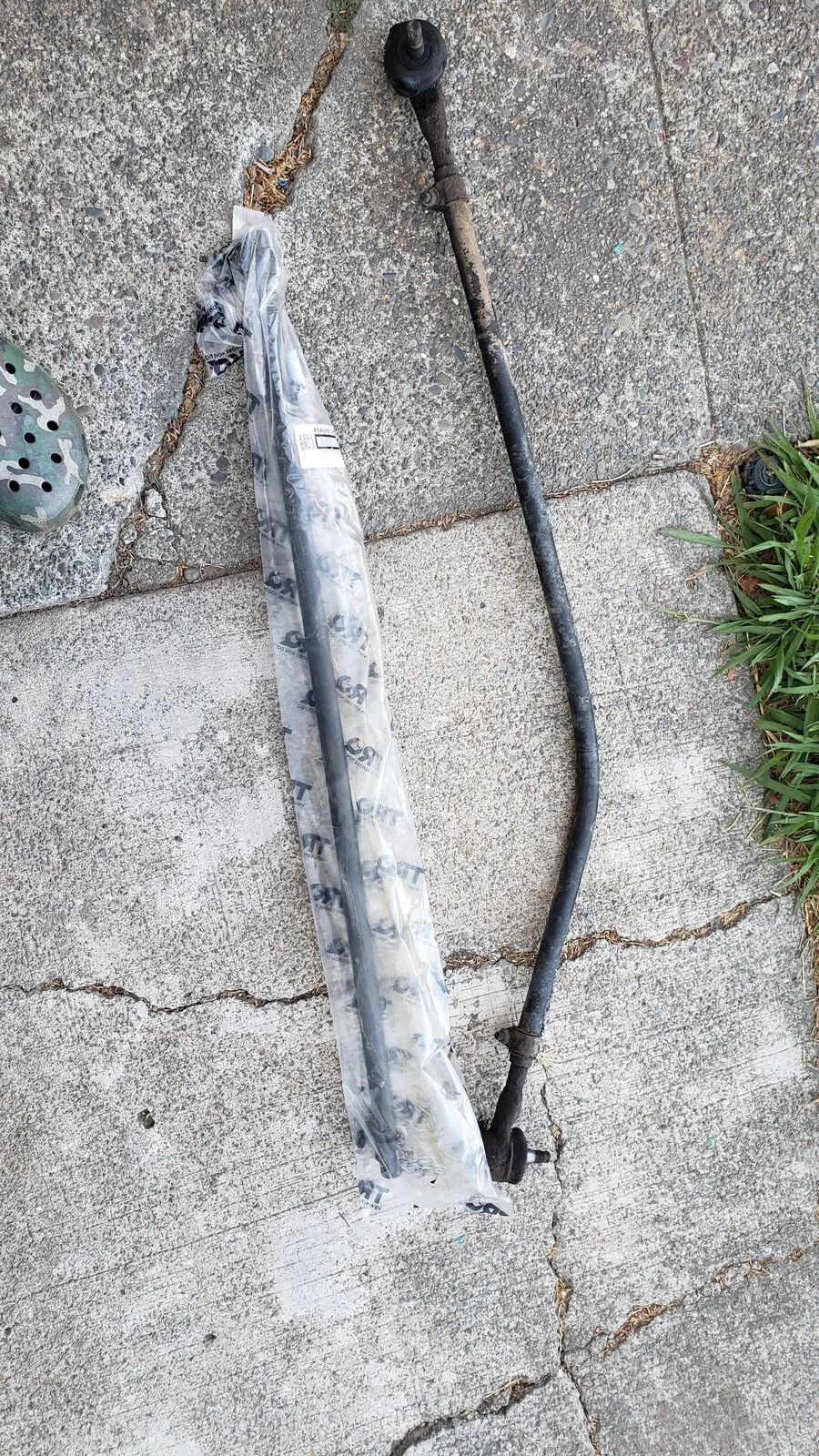

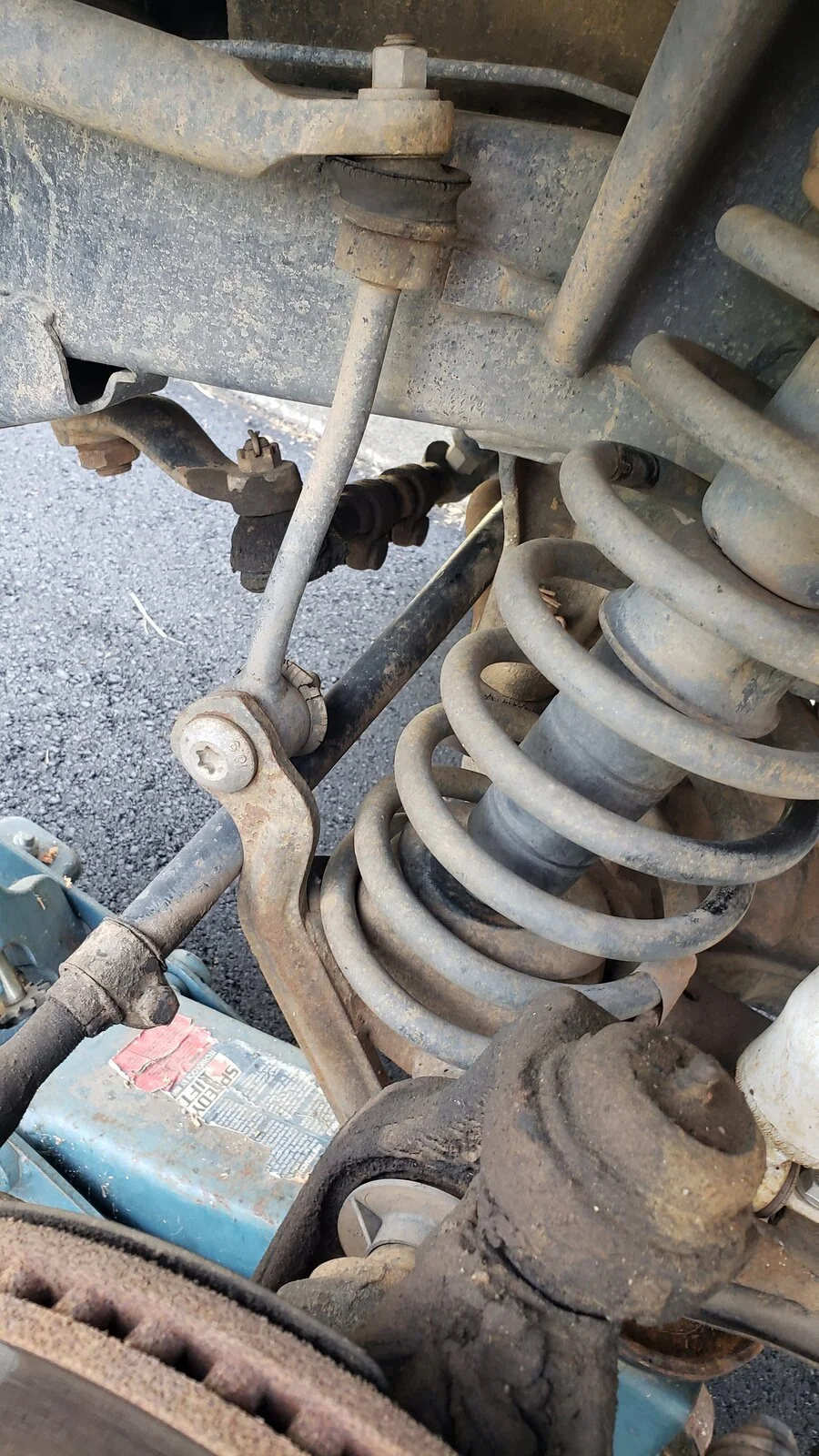

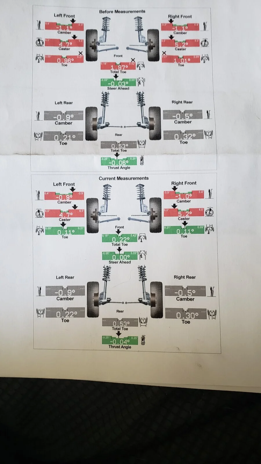

Hey all my lj was clipped infront of my house and driver didn't stop. Mirrot was found in my neighbors yard. Included some pics. Think I got lucky as the body and frame look to be ok but im just eyeballing everything. The tie rod was bent and walked itself behind the track bar. The wheel got bent pretty badly. It got hit hard enough to knock the tilt lock for the steering wheel loose. And one of the hood latches was undone. It was a pretty solid hit but could have been worse. I swapped the tied and trac bar out with some cheap parts so I could start looking at the other possible damage. I found the driver front wheel is 1/4 inch possibly more under the vehicle the passenger side. Looking at the jeep from the front and can see the wheel is has obvious negative camber. I measured the knuckle to inner on both side and they showed the same distance. Hooked a dial indicator and showed about. 030 of movement but this is vertical movement. I dont see any movement that would effect camber. I didn't see anything on the knuckle indicating it is bent. Im think the axle itself is tube bent. Btw it rolls without any excessive runout, no unusual movement in the bearing. Any way for me to confirm? I have spoke with my insurance. Trying to take care of this myself. Long lost but thanks for reading and any input
